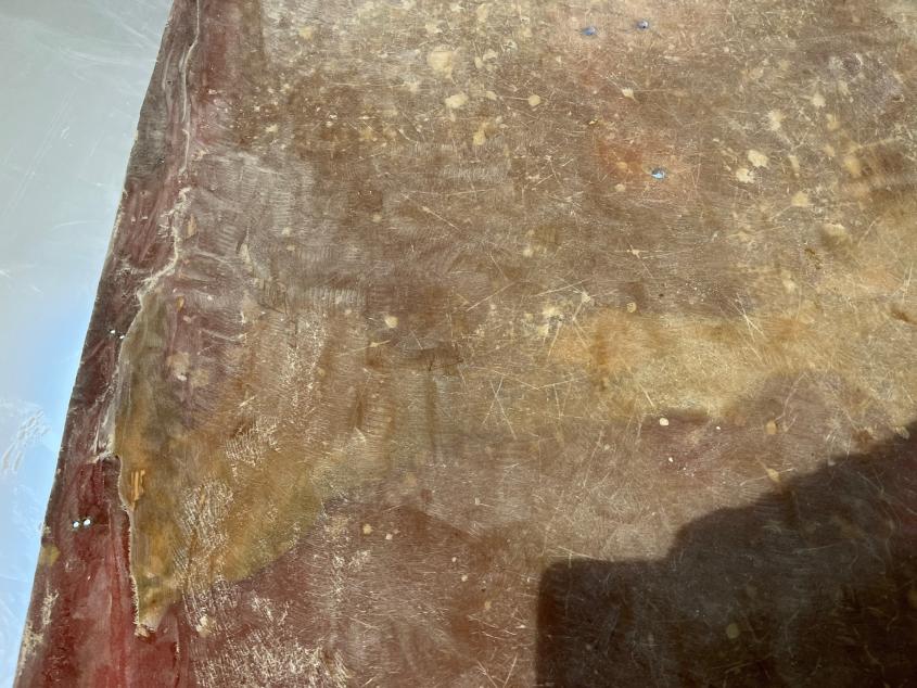

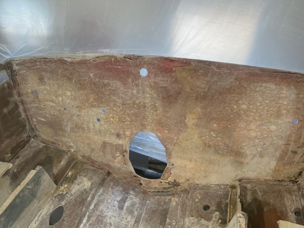

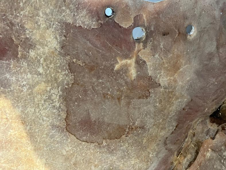

Slow going been cold in the garage up here in RI. I managed to get the transom all sanded down with flap disks, finding some delamination in a few layers of the transom glass which came from the I/O opening that was cracked. More clean up to do, then time to gather materials for the transom.

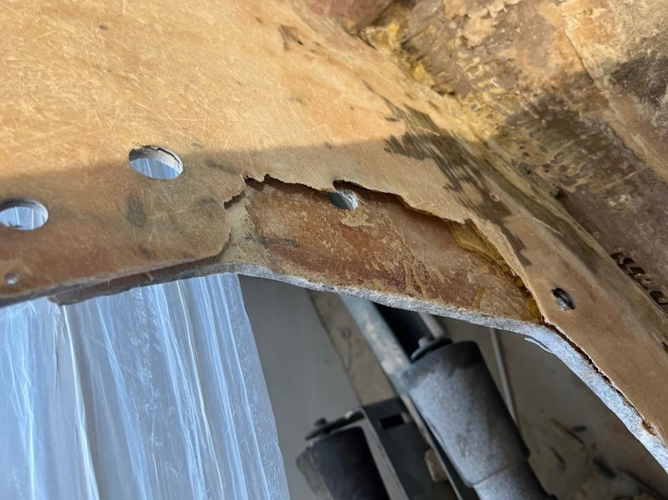

More grinding today. The transom is cleaned up most of the keel stringer tabbing is gone- just need to grind the fillet flush. Pictures of the I/B cracking i have to grind back. More grinding to come
