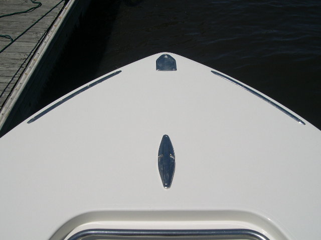

Looking good Chris! Do you have any chaffing protection in mind for the bow or just the small toe rails in place? I had the standard 18" SS ones bent by a machinest to match the top deck curve.

Not really chuck... the cleat is super far forward so i dont think itll need it. Rubrails pretty thick too so thatll help keep it out too.
