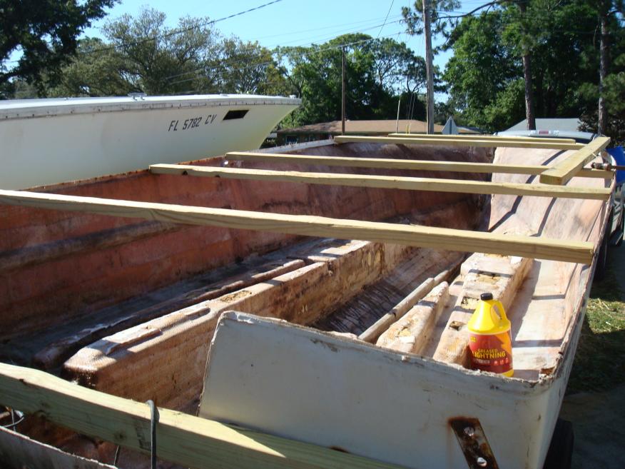

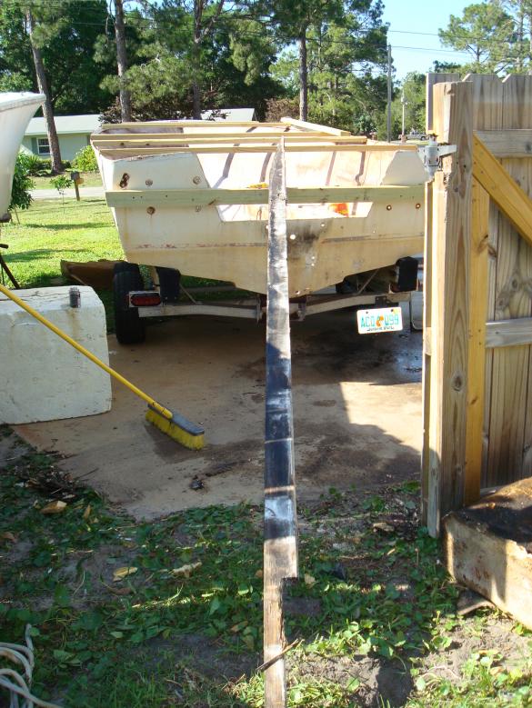

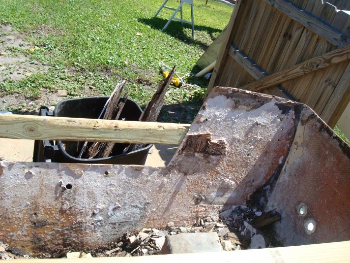

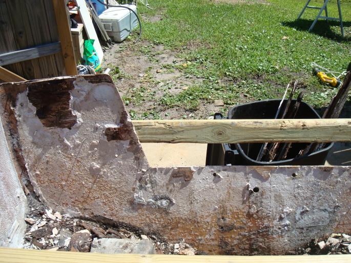

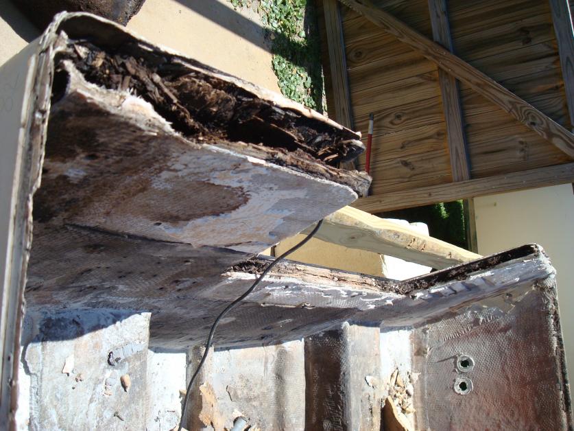

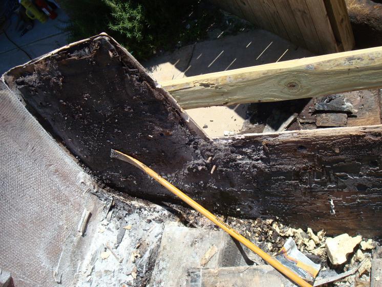

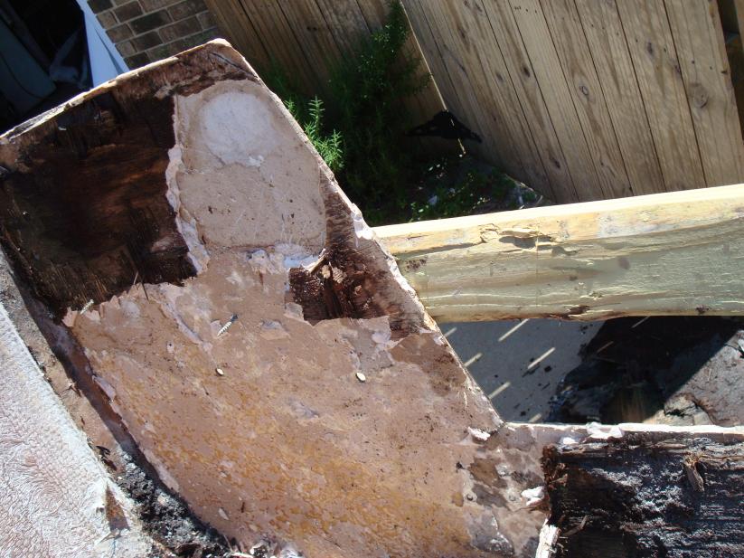

Today I started to remove the Transome core. Man what a mess. I made sure the transom was over the Trailer bunks before removing the core. I cut about 5-6 inches back from the transom across the stringers and removed the foam core . and then cut the perimeter around the transom. I then used block wedeges and pry bar to remove the plywood core.. The outer skin is very thin so I had to be careful not to damage it.. Like 0.125 thick. I never thought it was going to be that thin.. I did see about 0.0.25-0.375" thick of cabisil to bead the plywood. to the outer skin and then about 0.25 on the inside

Default Transom removal
here are the pictures

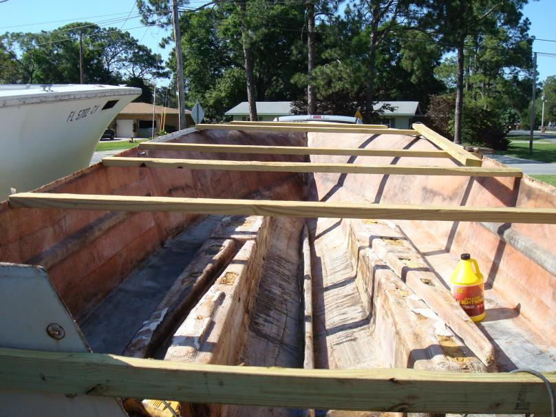

Default Pressure wash and degrease and scrub the hull, cut out Keel

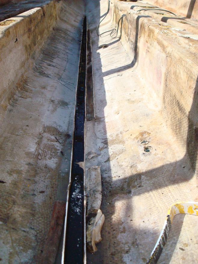

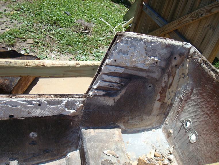

I then Pressure washe and degreased the whole entire hull. drilled relief holes for the water to weep out of voids in the glass and foma.. Then Decided to cut out keel...

Default pictures
Now I have to wait and let the hull dry out. I tarped the whole boat nad let dry for a few weeks
