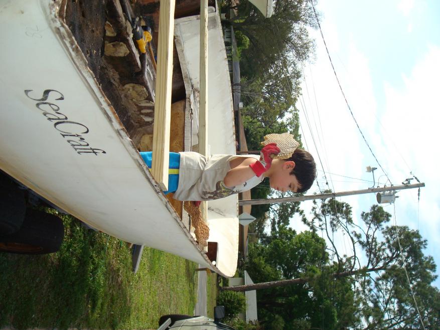

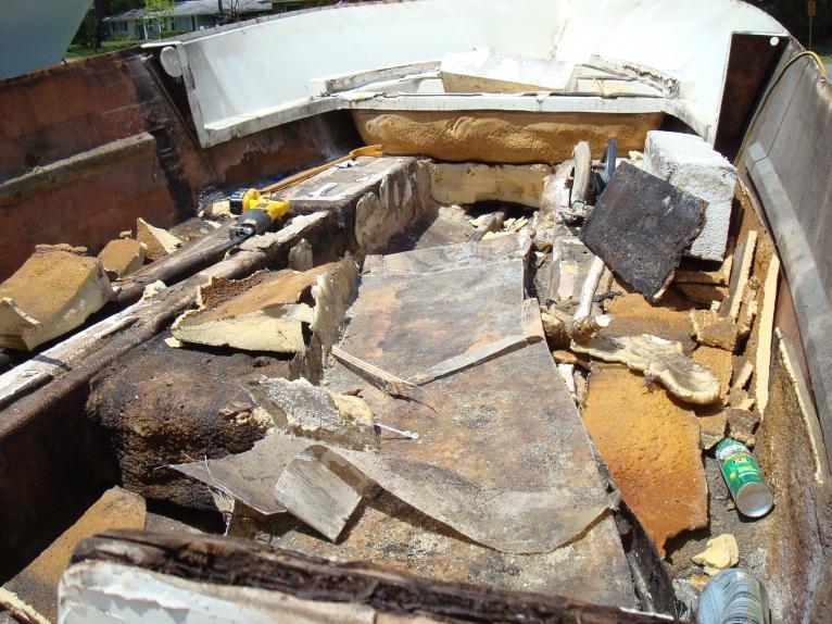

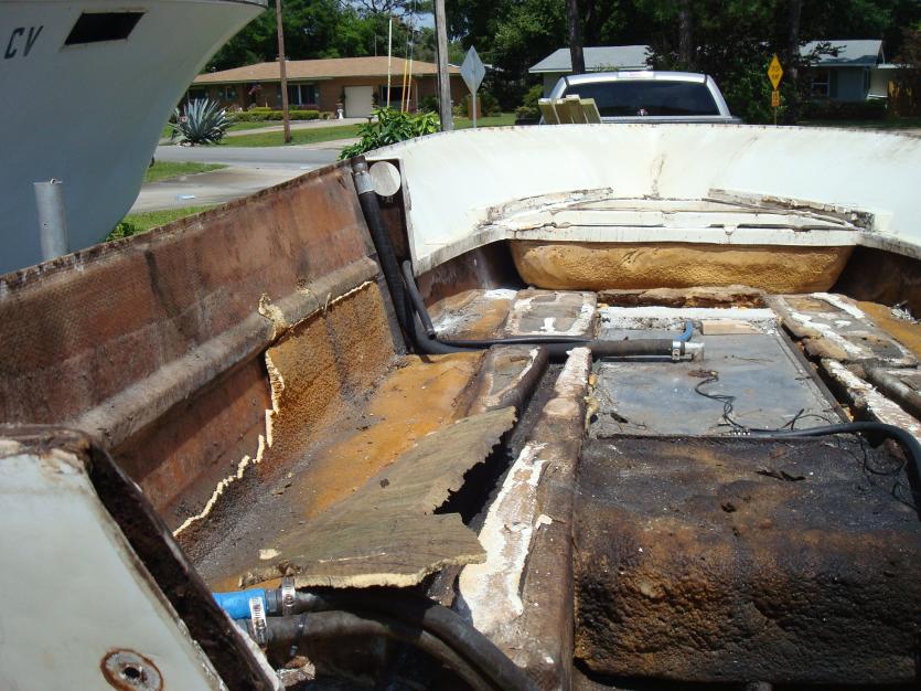

Started to dis-mantel my Seacraft. .. I want to say thanks to Strick for giving me the courage and insight to tackle suck a Labor of love. This boat definitely need to refurbished. ..After removing the Harware and console. there was definite rot in the transom and decks..
So I basically decided to do away with the liner and replace the floor and beef up the Hull. I never thought that these hulls were that thin.. Atleast mine is... And the spray foma is crazy. But I am glad it just falls off the glass in sheets..

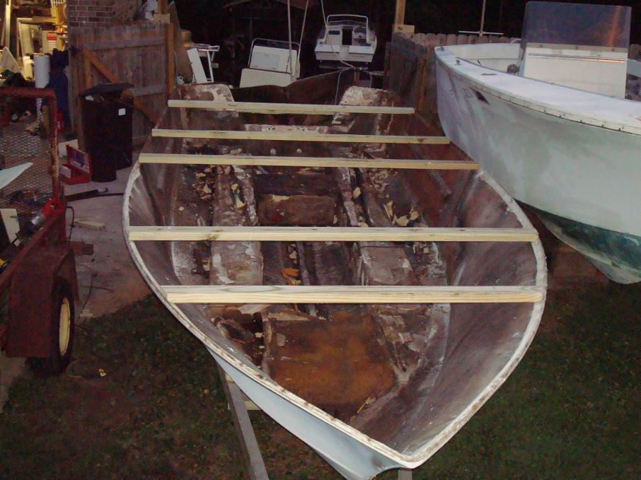

As strick may have mentioned, you don't want to leave that cap off too long or the gunwales will fall and deform some, then getting the cap back on will be extra work. Some of the guys have made retainers out of 2x4s by cross-cutting slots about 7-1/2' apart and placing the slots over the gunwale edges in 2 or 3 spots to keep the beam where it should be. That helps to keep the sagging at bay. Not sure what you mean about doing away with the liner - is your intent to core the hull? Others probably have a better idea on this but me thinks the liner adds considerably structural integrity to the boat. Good luck, looks like a nice clean project.

Very Nice Rig. Maybe I will do that.. I am trying to not make to much work for me. a I was thinking of keeping the Liner fward to help hold the shap in.... until I saw that the Center stringer or Keel Is wood with glass over it. and allthough it is solid It is saturated with water and there are void foward that are holding water... I need to address. With that said i am going to remove the Liner and Jig the boat up.Or visa-versa..
What do you guys think about replacing that Keel ... Will the boat deform? should I replace in sections?? How can I replace with out damaging the shape of the hull? Whoops I said 76 when it is a 73 20Sf

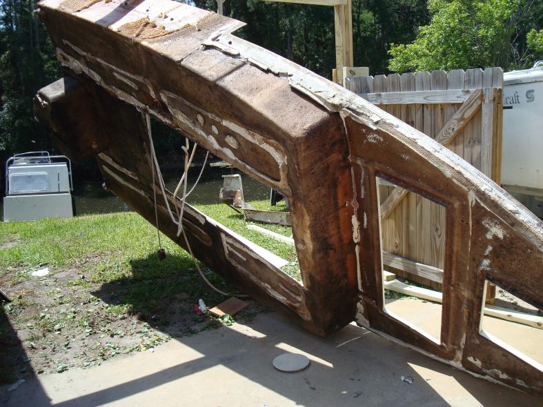

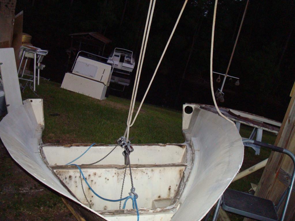

ON with clean up and grinding of Hull. Not bad for a weekend.. Now that everything is out I can plan and design How and what to do

Martin - I wouldn't worry about the keel. There are several layers of glass over it which provide most of the strength, so even if the wood were totally rotted, it has minimal effect on stiffness. Some guys have even replaced that keel with half of a ~2-3" PVC pipe to allow for drainage from the front with no ill effects. Might want to drill some holes into the void to drain the water, but other than that, I wouldn't worry about it. If you'll click on the Classic SeaCraft Home down at the bottom right of the page and then go to the Literature section, check out the 1969 Boating magazine article on the Seafari 20. If you can't read it, send me a PM with an e-mail address and I'll send you an Adobe file of the article. It has a very detailed description of the laminate schedule (number of layers of glass and type/weight of each layer) that will give you a good idea of how these hulls were built - there is a lot of glass in them in exactly the right spots.
