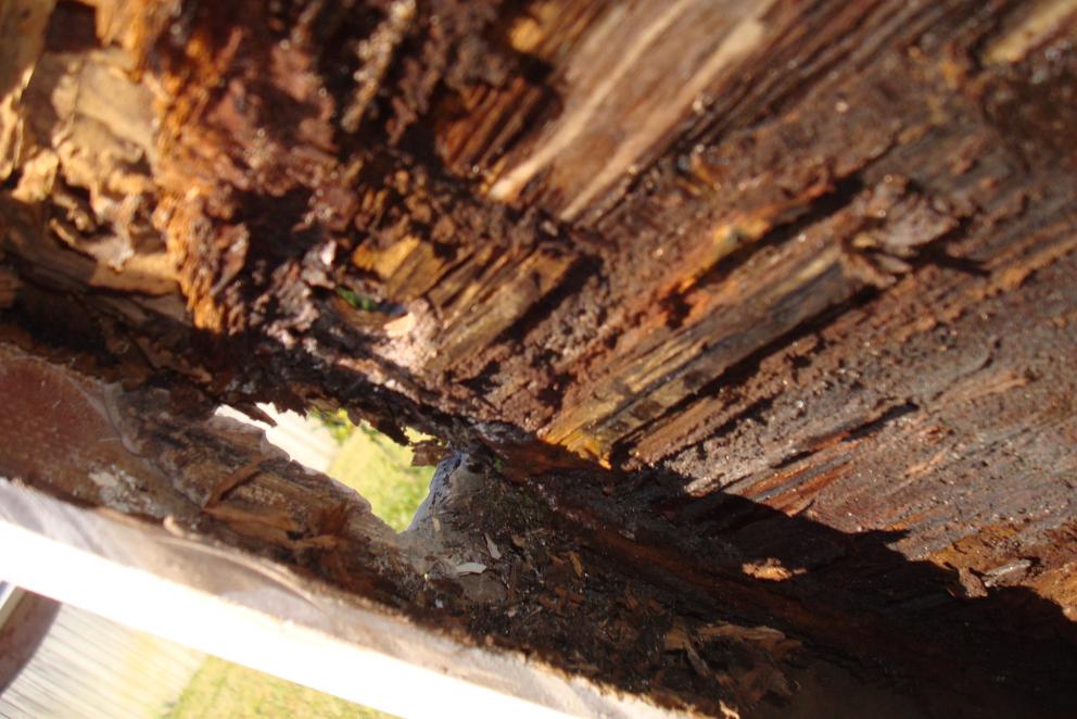

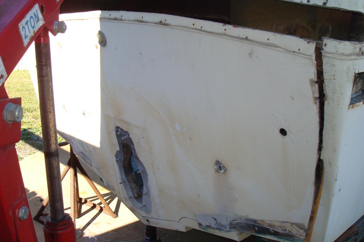

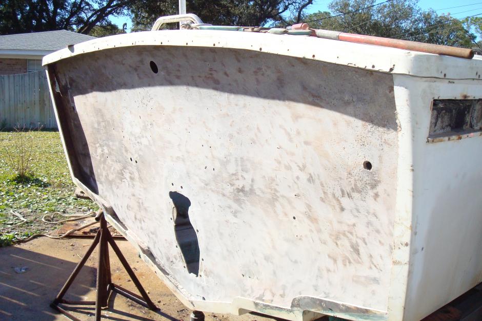

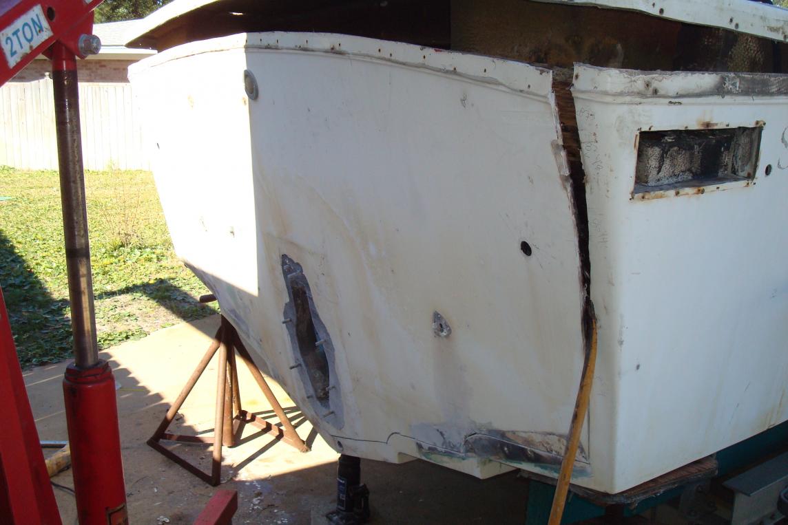

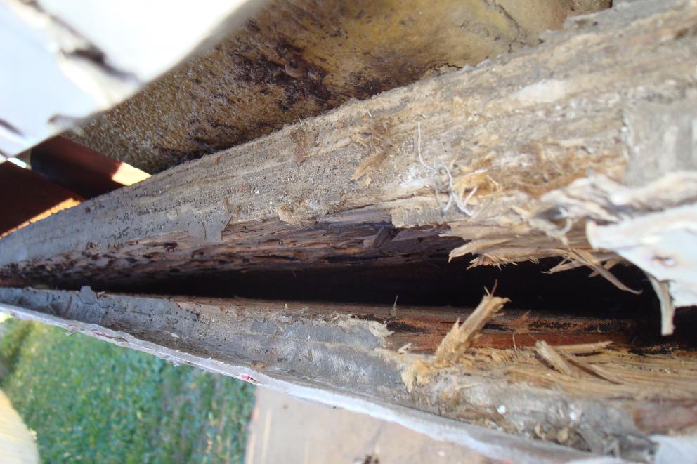

Okay guys I have started on my 23 this year. as I have a bracket and twin 150s ready to be installed.. But first I wanted to address the transom. I noticed the vent in the stern were cut a bit deep for a 2.5" thick transom.. well I got to pulling on the back and well. the plywood came apart... so then i started the begining of a transom tear out.. I am cutting the out side skin and laminating from the inside out. I did not want to pull the deck cap so i figured it would be easier this way... we will see..
