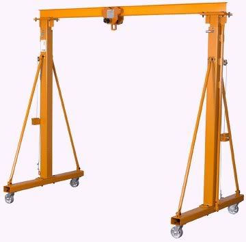

Here is the answer. I searched for a while tring to figure out a good way. Its not cheap but it works great and well worth it. I bought it with a couple buddy's. I used it on my 26' center console and now use it on my 23' spectre inboard. I dont work for them or sell them just own one.
www.portableboatlift.com
Old 09-17-2008, 01:39 PM
Default Re: Boat support stands / trailer transfer
Bought one of these from Harbor Freight for under $600
while on sale..
Strick also has one. Had to redrill the I beam
(8 half inch holes) to make over 8 ft wide to clear
trailer fenders.. Works great !!
See ya, Ken

Both of those ideas look great. But, I don't have the room for something like that.
I'm looking for a DIY, home-made thing that will be safe and can be set-up and broken down with ease.
Would you think a 10' 6x6 or 8x8 would do it, w/ bottle jacks mounted on top of cinder blocks ?
Or, should I blow off this idea ?
