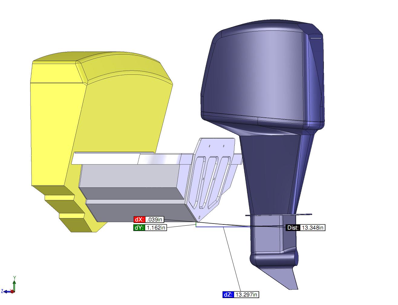

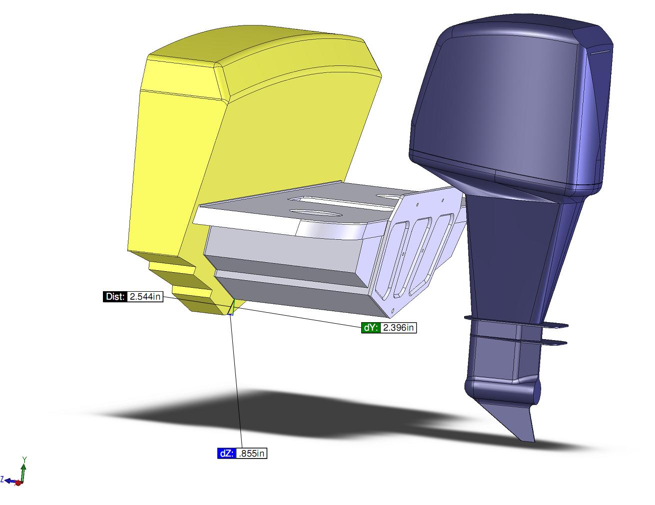

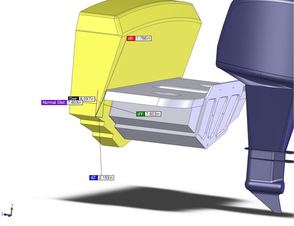

So I can't do some of the mods to the 30" bracket I wanted with a Bridgeport- it won't fit. So I decided to look at making it into a 24" bracket with a plasma cutter and TIG torch. I modeled it up and it looks like about 430 lb flotation, less 105 for the bracket mass if I include the side tanks.
Below are illustrations of the bracket placement with a 20" Yamaha F100 motor. It might be a little low?

I will think about tabs, but I can't justify a 30" bracket on a 20' boat with a 100hp outboard. I modeled up the Yamaha and it has 2-3" clearance when it is tilted fully up. The extra 6" of length on the bracket is just working against me when I am on plane, so I think I will chop it to 24"
