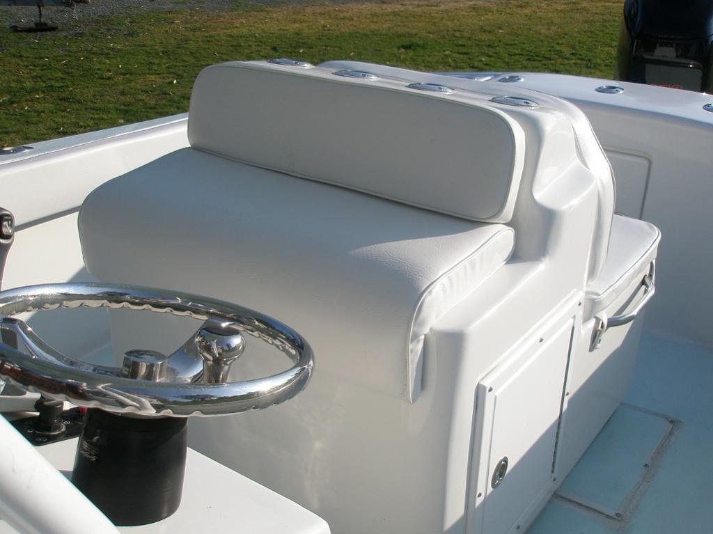

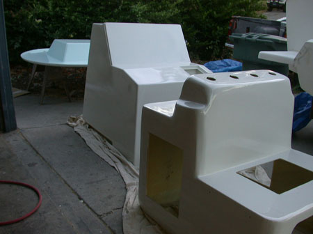

Old 01-19-2012, 10:56 AM
from my archives
Old 01-19-2012, 11:13 AM
looks like the core cell was stapled down in the image above. I carved out foam and glued it in place then cabosiled over it and sanded smooth for the big radius's....lots of work but came out nice in the end.
