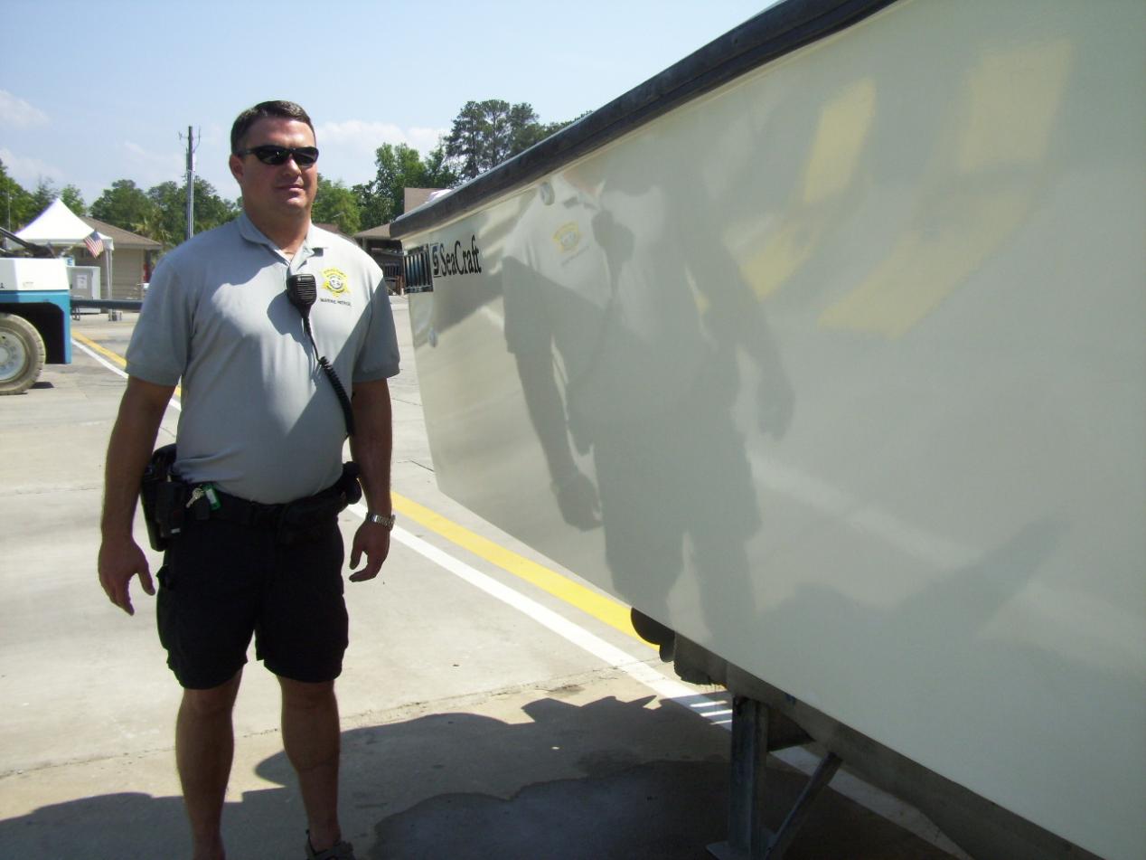

Yep, Just like Jerry sez! Here is a picture AFTER I used it.
