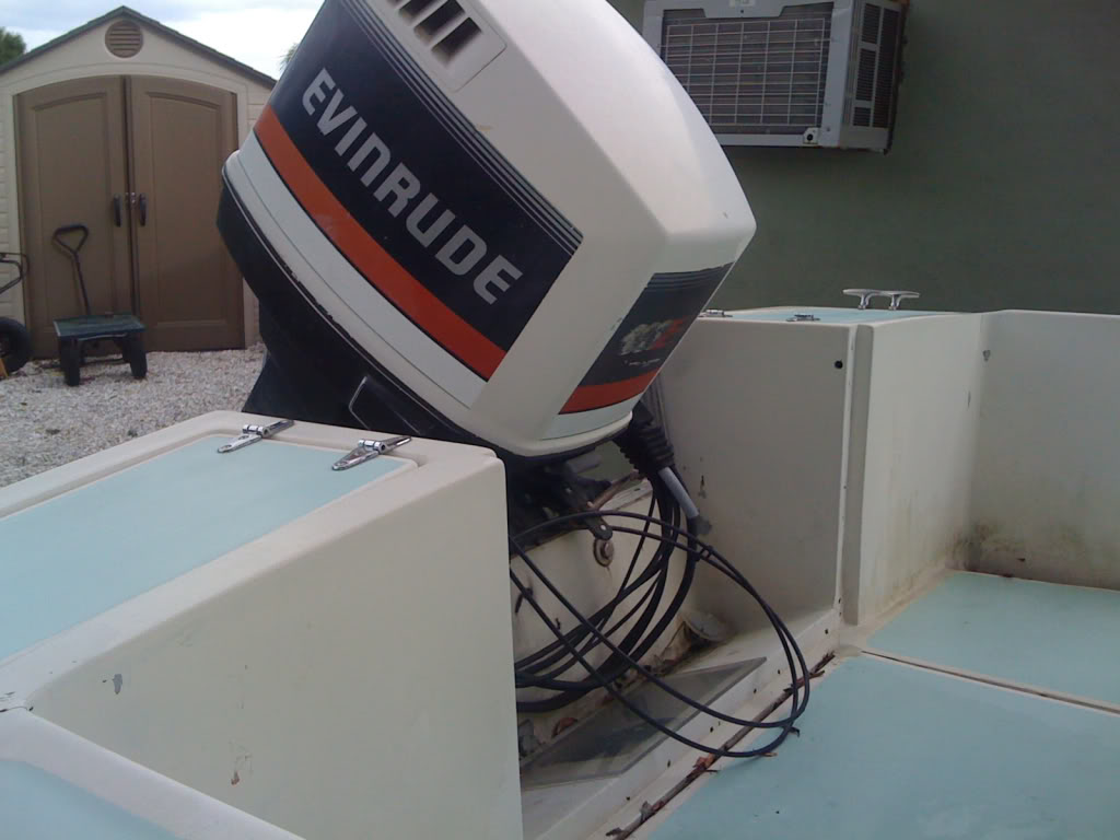

Old 03-03-2012, 08:14 AM
rntim1 rntim1 is offline
Join Date: Feb 2012
Location: key largo
Posts: 13
Blue Heron--I too do not have a motorwell panel. Thinking of making one out of plexiglass (thick) and seal it in. Your thoughts?
Old 03-03-2012, 08:24 PM
Location: Greater Boston
Posts: 1,117
A flat panel should fit, but a curved one is needed to tilt the outboard all the way up. I am modifying mine now to do that.
