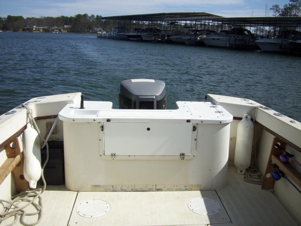

I chose a completely different route. I kept the notched transom and added a livewell and bait station in the existing motorwell.....just food for thought.

I made a spread sheet of weights when when rebuilding my 23, it was very helpful. Basically take the centers of all you large components and their distance from a single point (outside transom face is a good place) then you can compare changes from the stock set up.
The stock live well (below decks) is already in about the same location as a in transom live well (its center maybe 18" forward of your proposed transom well). So you do not need a huge offsetting moment to compensate for moving the livewell back a little. BUT you still have to compensate for that motor and there are only a couple other things you can move (fuel,console, people, batteries)
Are there any other weights you can move forward to compensate? I moved my console forward by at least 6". When you move a console forward, you also move a lot of people weight too. I also moved my tanks forward.
I went with a large livewell/leaning post and I am very glad I did, her trim at rest is very flat and on plane I do not need trim tabs to keep the bow down. If you were running with a lot more HP, I would say keeping the CG back is not going to hurt you, but with a single 225 (I have a F225) I would get as much weight forward as possible. The faster you go the more aft you can have your CG

77Sceptre's is very nice but in that Sceptre you also have "The Dance Floor" the CC's don't have kind of room but very nice.
CBBOATWORKS - that looks really nice - very compact and doesn't take up a lot of space - that would be perfect for SF 20 guys scaled down a tad
