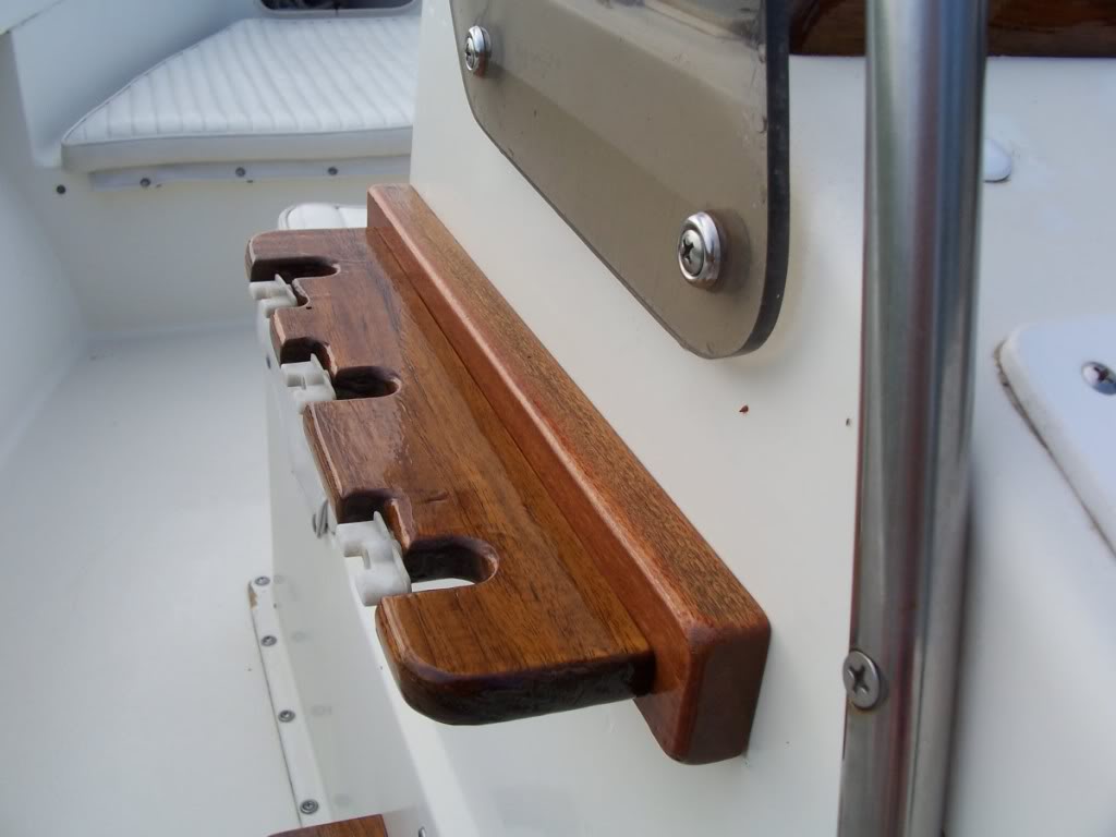

I agree with Denny on the epifanes. I, too , followed the directions to the tee last year and got fantastic results. All my teak still looks like it did when I finished it. remember that this teak is 36 years old.
Old 06-13-2012, 10:12 AM
I need to clarify that the rod holders on the side of the console, less the spacer, and the rear hatches are the original teak. The other stuff is new brazilian teak finished the same way.
