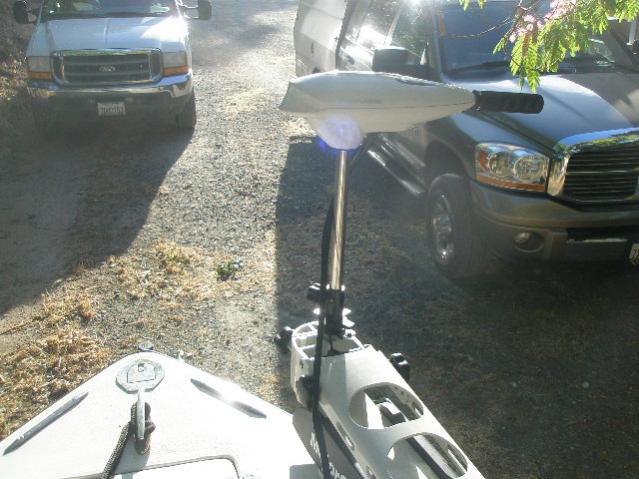

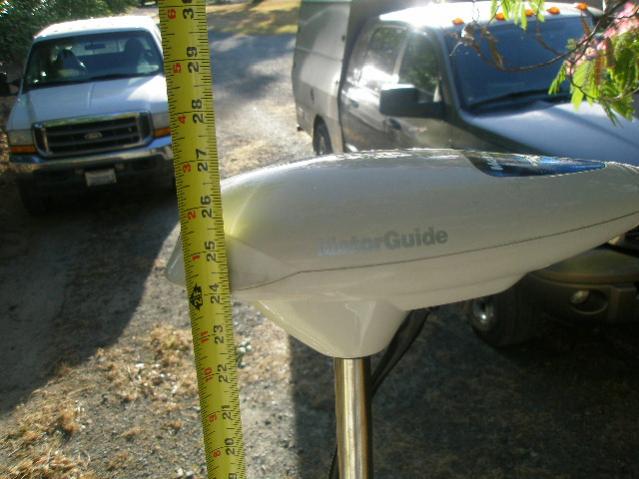

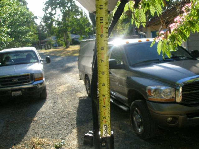

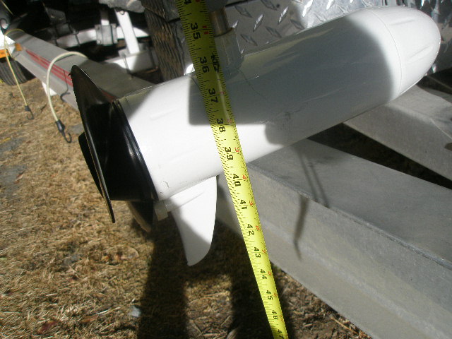

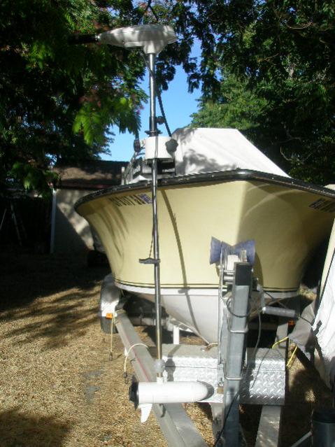

Originally Posted by sidelock View Post
I think that ultimately I will have to measure the height of the bow from the waterline
That would be the best way to nail it. I took a few measurements and pictures tonight to hopfully help you out a little. When standing in my forward casting platform the control handle is approximately at my mid abdomen. It is 26 inches from the top of the control handle to the gunnel cap. There is 11" of ss shaft from the lock nut to the bottom of the control handle. There is 40" from the top of the gunnel to the bottom of the lower unit not including the skeg.
