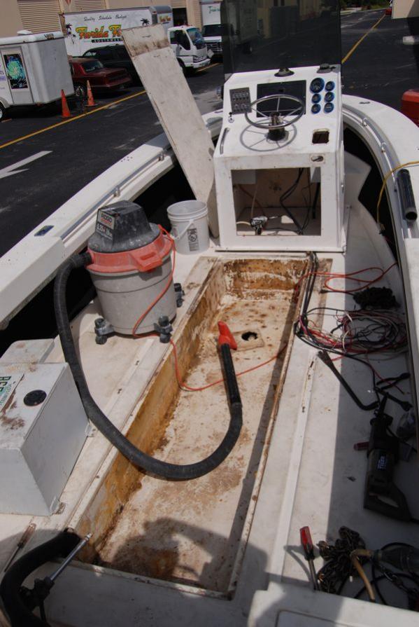

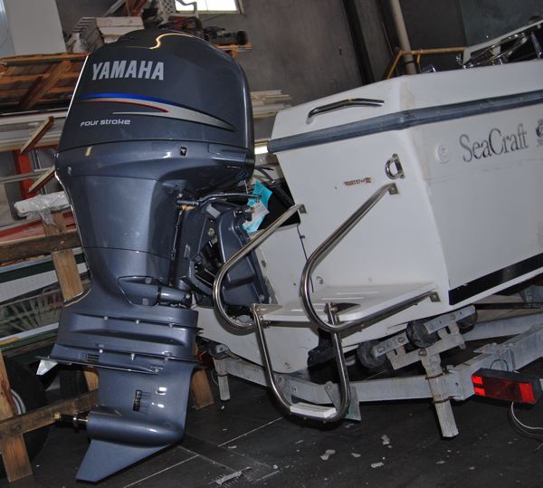

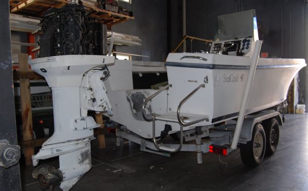

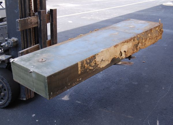

Pulled the old motor off and hung the shiny, new one on. Looks awkward on the 'not so pretty' boat. Pulled the old tank. There was no way I was going to take a chance with any nasty old gas that was left in there. It's also way too big. It was 83 gallons and I'm going to go to at least half that. I want to get past the break in and run the boat a bit to see what numbers I get and that will help me determine the capacity of the new tank. I really like the way the bracket looks with the closed transom, but the weight, etc has me a bit concerned. I want to play around with the placement of the water and fuel tank a bit and see how it sits. There is room under the floor forward of the tank coffin to move the weight forward if need be. We'll see. Need to order some fuel lines, fill and vent hose and control cables. Then the fun part begins.

Good call on the weight moving forward. What is the weight of the new power?
What was the old power? 150/175? If so, I may have interest.

491 pounds! The old one is a 225.

I know I'll get some flack for this, but after coating the tank, I will probably use some foam. I won't go crazy with it...just enough to keep it secure. It was my job when I was a teenager to scrape the old foam and clean up the tanks in general for scrapping. I've seen LOTS of old tanks and honestly, foam or no foam, it's about the same result. Some with foam were corroded, some not. Usually where there was a 'cushiony' type strip attached is where there was corrosion. Sometimes, it was nice and shiny under the cushion strip. The most important thing is a coating of some sort and to keep the tank compartment dry (as dry as possible...it is a boat after all) Make sure that if water can make it's way in, it has a way to drain out. Coating it certainly makes a difference. Coated tanks always fared better. That old tank that I pulled was coated with zinc chromate. I haven't decided what I will coat the new one with.
