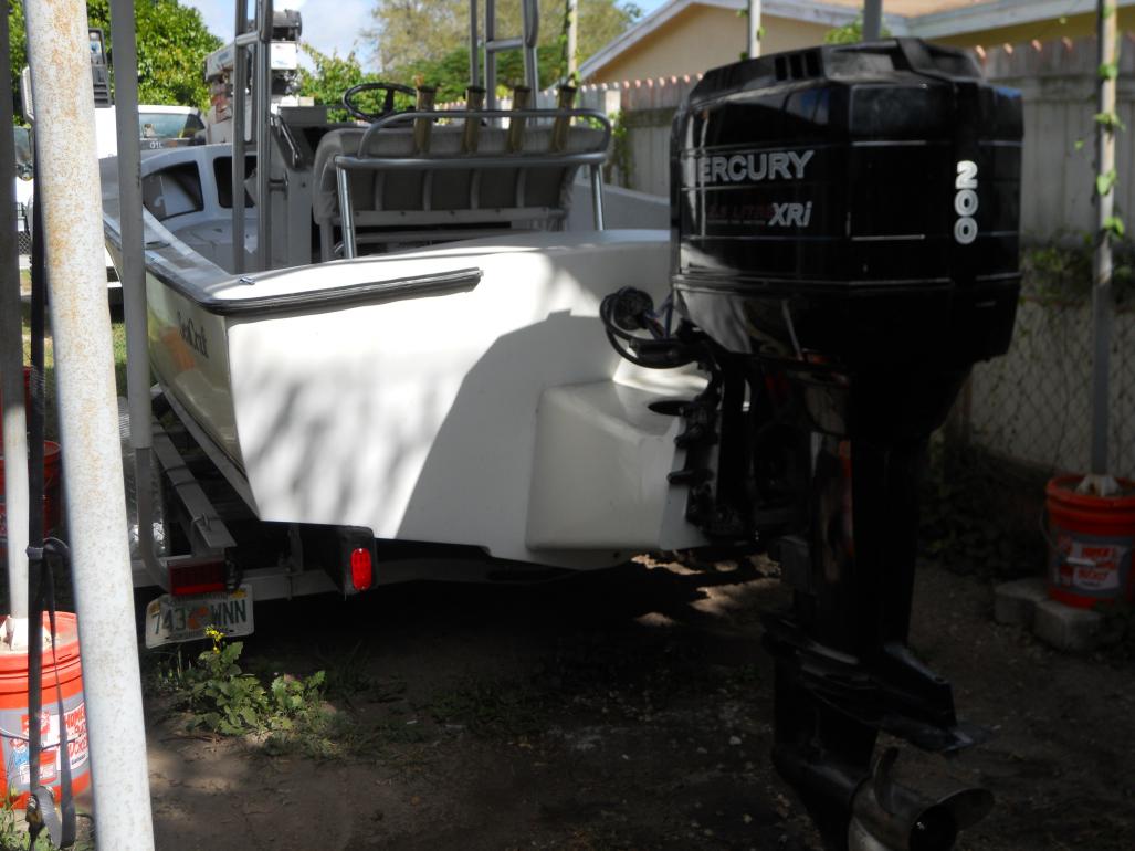

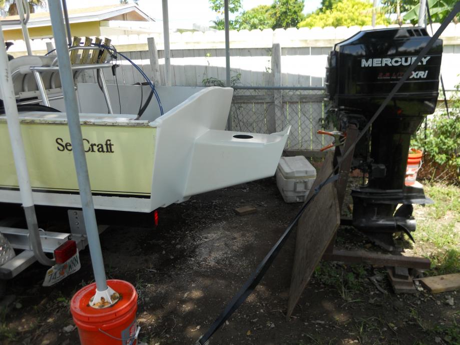

This is for those of you running a bracket on 20 footers?
So i know the rule of thumb in 1 inch up for every 12 inches back, but i think i remeber seeing somwhere that seacraft hull desighn actually likes the motor a little higher whether it be on a bracket or on a regular transom. So i was hoping some of you guys with brackets could give me real numbers on your setups.
I just finished my setup but havent had it in the water yet and wanted a good starting point for engine hieght, i have a 20 SF with 26 inch set back bracket. I was thinking 2.5 inches but i think somewhere i saw someone was running 3.5 inches up with good results. So what do you guys think?

thanks guys, im a little worried now because i set the bracket as low as possible to get the most amount of fotation i could get and im at 2.5 inches up above the keel now with only 1 hole left to go up. from what you guys are saying i need to take it to the last hole up and pray it is enough! its only 3/4 inch per hole so id be at 3 1/4 inches up. as for props i have a mirage 19p i was going to try and also a ss michigan wheel 19p or the old faithful aluminum black max 19p as well.oh and im using a miami stainless marine bracket. i sure hope its high enough.

Posts: 261
thank i was just comparing pictures of our boats and they are close. i am going to raise it to the last one befor taking it out and hope its good. i guess with a 26 inch set back i could add a jackplate if i needed it. Oh the joy of spending my kids college money!

Thanks Bill, thats what im thinking and hoping, im gonna move it and pray im good, i guess that because we have the VDH desighn hull it allows more water to flow back and fill the void behind the boat quicker than a traditional hull making us have to raise the motor more. hell i dont know , just speculating.........
