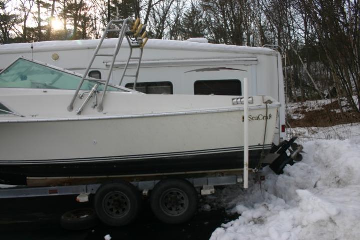

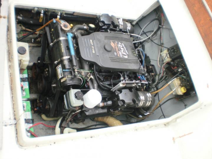

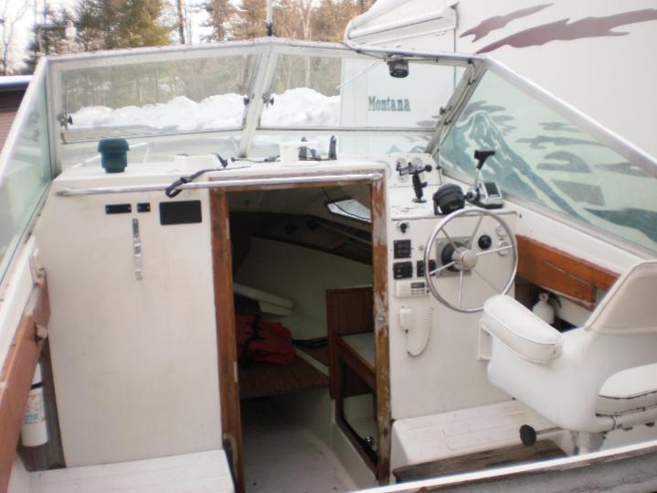

The few pictures my dad took as he helped me tarp it up as the storm rolled in. Pretty amazing how mobile he is after two artificial knees. The boat is a mess as we were scrambling to beat a storm and nightfall. I bought a small step ladder yesterday just for getting in the boat and reaching the radar arch.

Two things have occurred to me since I last posted to this thread.
1) FishStretcher, this is your boat. Even though the pictures I have were taken before it was yours, I'll respect your privacy and won't post them without your permission. Let me know by PM if it's ok to post or if you'd rather I just send them to you.
2) It looks like the exhaust riser elbows are only about 6" above the deck. Mercruiser has a recommended minimum height above the fully loaded static waterline to the top of the riser elbow. I believe it's 12", but I'd have to look it up again to be sure. I don't think 6" above the deck is going to get you there. I have 4" riser extensions on mine. Looks like you've got plenty of room under the engine cover if you need to add them too, and riser extensions would be cheap insurance against water ingestion.
Dave

I will need education on this one. If there is a good website for how this works, or you want to type it out, I would really appreciate it.
The Seloc manual covers every configuration in the book, and a 5.7 with fresh water cooling and partly (?) cooled exhaust is something I know nothing about. But it looks like I need another riser and a harder bend for the exhaust, you say? There sure looks like there is room I was wondering why the engine cover was so tall. I have to do some other engine things, so the more I know, the better. I have a 1 ton chainfall, so I can move the engine if I have to. And a mobile cherry picker good fro 500lb at that reach.

Ouch. Riser kirs for a dry joint exhaust are $450?!? They should be titanium for that price.

For mine, volvo makes hugely expensive, one piece hi risers, but you can buy extenders for the existing risers, after market and much less expensive.
