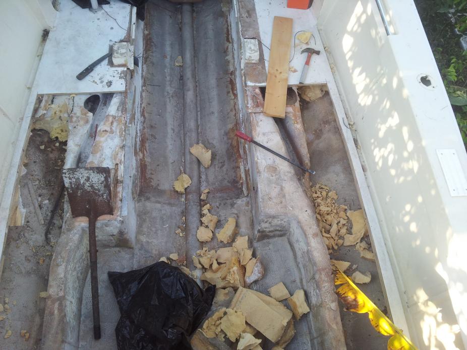

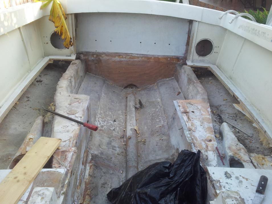

Ok, this is what Ihave so far and yes I am referring to the stringers and the space on the lateral sides Left and Right. How much foam do you think I will need for those sides running from the front step all the way down including stringers which will have to be gutted.
I noticed that under the foam it was wet. When the deck is fully taken out I will determine where the water intrusion is coming from to prevent this from happing to the new foam.
I manage to snap some pictures of today’s work not much but that's what I have at the moment.

Dont know for sure, but it was a lot. Not counting the stringers, I think I used around 6 gallons of foam (side spaces, plus foaming in tanks). I

In my restores I pulled out all the foam except for what was in the stringers. There I dug out the foam where the factory fill holes were and drilled holes on the inside of the stringers and let it drain and dry out. Replaced what foam I dug out stringers and glassed up the holes. Be careful if you are going to be foaming your gas tank in. Especially if its aluminum. I would not suggest it. I never noticed a big difference in ride or sound in my 20' or 23' w or w/o foam. It really just there if you capsize to keep your boat floating. I would also glass a couple kness from the transom to the hull
