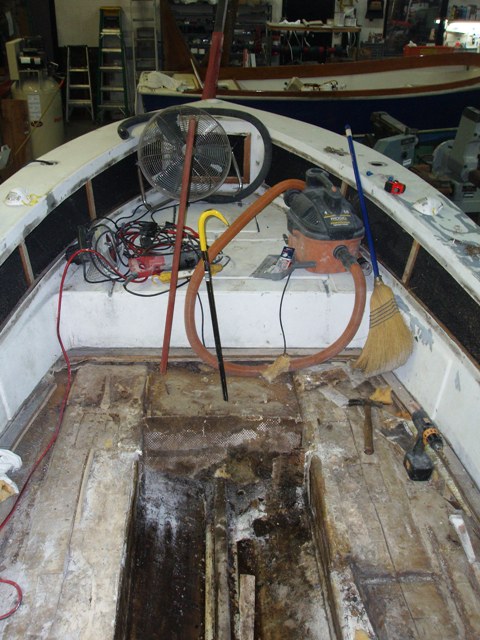

So, that lit a fire under me to git goin on the latest project. "Red SeaCraft 20". I found this little gem, someone, for whatever reason decided to teak this baby, teak floor, teak all over the console, and then, the strangest thing. The fuel tank was integral, fiberglass, it took weeks to get out.
Anyway, we stripped the boat, took the liner out, took the cap off, we cored and faired the hull, raised the deck, cored the cap. Custom "konk" well, full transom, bracket by non other than THE Mr. Don Herman of HermCo.

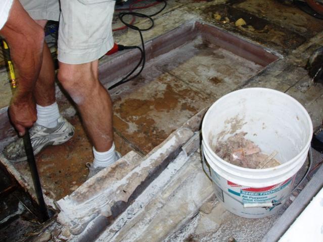

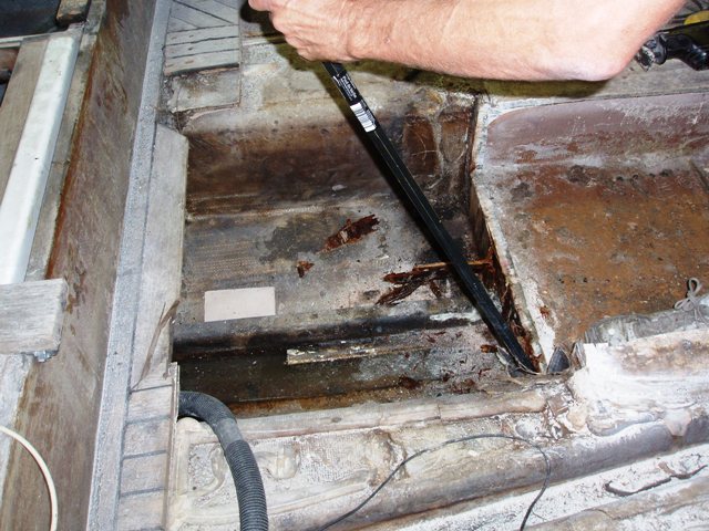

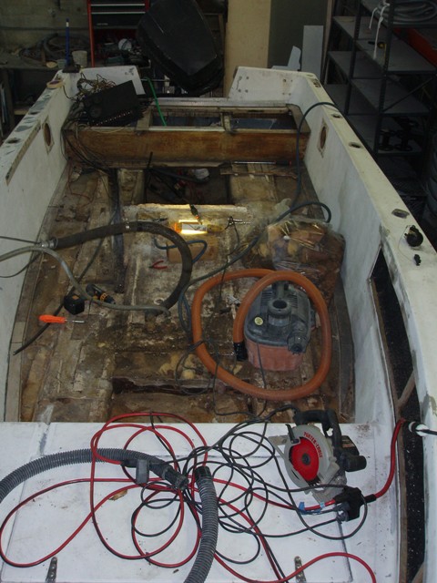

Stripping a boat is usually the easy part.
I have never seen a fuel tank like this in a SeaCraft, it literally took weeks to get this thing out.
P.I.T.A.

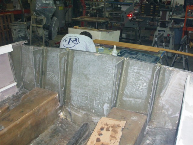

Long story short, got the hull cleaned out, transom cut out, hullsides cored.
Materials for this job are Vinylester, Divinycell for the hull, Coosaboard for the deck and transom.
I ended up packing up the console, couldn't deal with getting all the teak off of it. I found another console and redid that, probably was not the cheapest way to go but I wanted to have original SeaCraft parts in the boat or at least they started out as original.

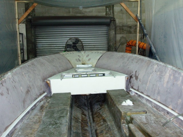

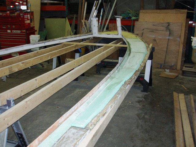

Ok, so where was I?

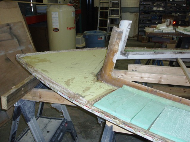

Got the boat stripped down. Cored the hullsides with Divinycell.
Made a custom one off "konkwell".

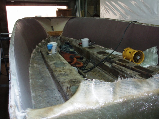

Raised the stringers 4". Glassed them over and tied them into the transom.

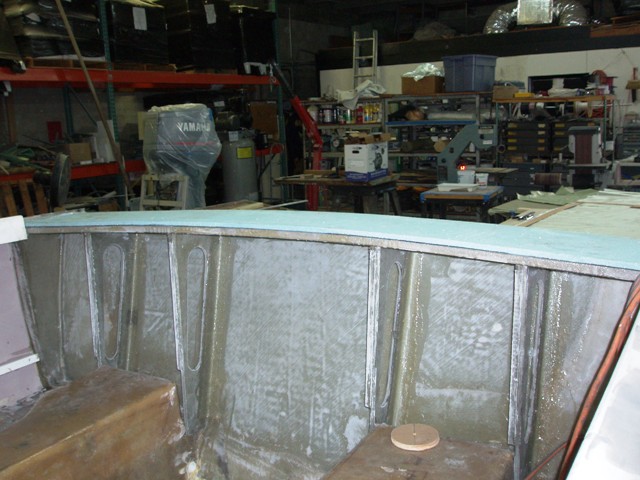

Completely redid the forward compartment area.
Removed the cap and forward step area cap, removed all the wood, re-cored and put back down. You will notice that the liner did not go back in.
We faired and painted hull sides.
