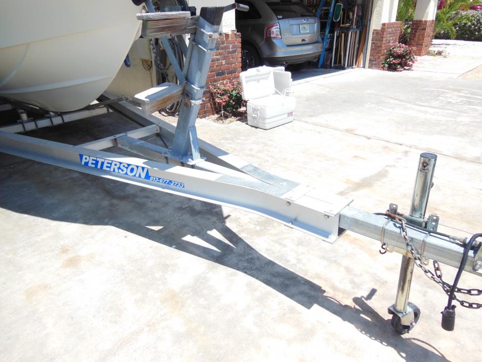

My two cents. Buy a "double bend" frame!! As an example, it's an option on Continental, their top of the line "CA" models have it. Only way to go.

That's a new one to me! What is a "double bend" frame Don?

Go to the Continental web site....as an example only.....and look at how their top of the line trailers are made looking at the hitch back to the axles. Two bends, one in front of the axles and one at the front. MUCH superior. My last two trailers were built this way and would not buy one without the extra strength. I can send pictures of mine when I get home.

If you gat a chance to post the pic Don I'd be curious to see it
Old 05-25-2013, 12:41 PM
Here ya go!! Notice the 3" x 3" galvanized tubing is 8' long and runs through the "second bend" in the frame which is bent to run parallel to the tube and bolted through with SS bolts along with a cross member at the end. In effect the load at the front of the trailer is distributed over 5' versus in some trailers, like the basic Continental models, just 2' with little bracing.

My Peterson is built the same way. Don I like the steps to get off from the bow.
