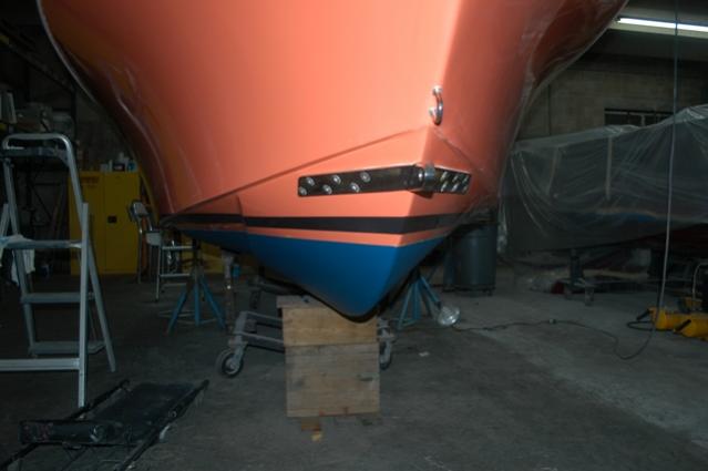

Can you please explain the purpose of the extra loop is? I must have missed it somewhere along the way. Is it for towing behind a bigger boat? like the pic of the CR being pulled.
