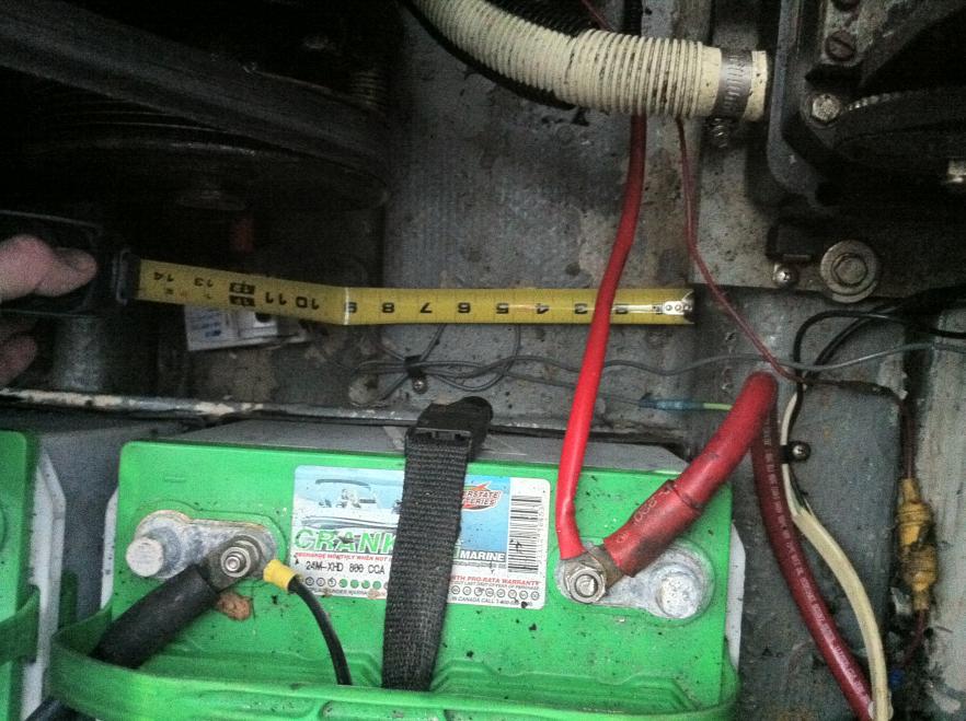

Old 11-02-2013, 03:50 PM
Location: Greater Boston
Posts: 1,117
Box stringer is 8" wide, and 3.5 to 4" above keelson 8" aft of engine compartment forward bulkhead. The shelf for the batteries rests atop the box stringers and probably sags a bit. I can't get my head down in there to read the measurement, so the photo will have to do.
Old 11-02-2013, 03:51 PM
Posts: 1,117
Pics of that to follow.
When measured careffully, the engine bed is really 1-3/4" high on the outside, including glass thickness. I tore up index cards to step the flat away from the tabbing on the engine bed to get the 1-3/4" measurement.
Note the 8" box stringers are offset from the adjacent stringer by 1-1.5". I neglected to measure that.
Old 11-02-2013, 05:03 PM
Posts: 1,117
Let me know if you need any clarification. I think going too tall with box stringers would make for even worse access to the starter and oil pan. I would err on the short side and build up the engine beds, if I was doing it.
All this assumes mine was installed correctly. But the short sea trial seemed ok.
