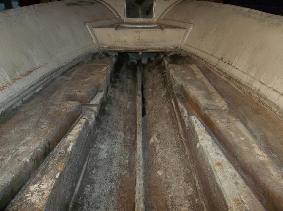

I Finally removed the rest of the floor and now on to the new floor install. You were right about the Potter Putty(in the original floor). The last floor was unlaminated 3/4 inch plywood that was rotted. At least the inner hull looks to be in good shape. Pretty amazing after all the neglect!

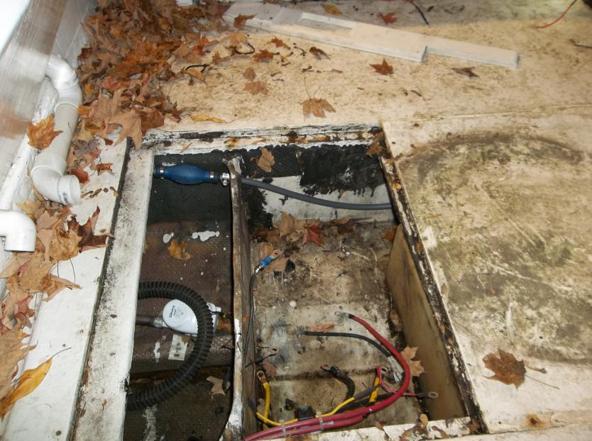

Can anyone comment on the set up and placement of weight in these boats?
Old set up
2 main batteries all the way aft behind and up against the gas tank(plastic), 3 car batteries for the trolling motor located all the way in the forward compartment.
Potential new set up-
3 trolling motor batteries located at same level as the gas tank(below floor) under the front of the Centerconsole and then the 2 main batteries on the deck under the centerconsole.
I would think the more weight located lower in the hull would be better?
The pic is of the old Battrey compartment located in the area about two feet infront of the transom below the floor.

Old 12-09-2013, 12:56 AM
Location: Greater Boston
Posts: 1,117
Assuming your tank is in the stock location, and your engine weighs more like 400 lb, not 250 or less, then put all the batteries forward.
I have my 20 gallon tank and 2 batteries under the console in a 1975 20 foot master angler. I have 420 lb of outboard on the transom (100 HP 4 stroke main, 6HP 4 stroke kicker). Balance is OK that way.
If the weight is a bit too forward, remember where everyone will be when boating a fish- an aft corner. If possible, put too much weight forward. If you don't like it, put tackle or a livewell in the stern. But I don't think you will have to.

What would you do to the inner hull before putting the floor down? Would doing a quick prep and a coat of resin to seal things up? or just leave it?
Thanks again Jon
I was going to coat mine with a bilge coat product but read lots of bad things about it flaking back out. I ended up taking left over VE resin and coating the existing exposed areas. Once that dried and I was ready to cover the area I used interlux 2000e epoxy barrier coating to seal off the fiberglass to water proof it from any water that may get down there. Epoxy resin alone would work well and be better than polyester due to the water proofing nature of the epoxy. The polyester resin is porous and will not seal it as well.
Old 12-09-2013, 09:57 AM
Posts: 1,117
If you have exposed fibers from grinding in the bilge, then a thin layer of vinylester probably can't hurt. Vinylester has good water and chemical resistance, works like polyester and has the elongation of epoxy (as it is partly an epoxy chemistry). Strick mentioned (and I agree) that an old school bilge coating is just gel coat. With or without duratec high gloss additive. It will stick to polyester or vinylester, but not epoxy. If you buy non-waxed vinylester, you can put this down, then coat with waxed gel coat over the top with no sanding in between if you follow up in a reasonable time frame. (Without wax, polyesters and vinylesters don't cure on the very surface- the air inhibits this. Most resins include wax that floats to the top to allow the cure on the side that sees air)
I am on a tirade against wood this year as I keep dealing with rotten stuff. But plenty of people use it successfully. So don't take my comments as that you did something wrong.
Merton's fiberglass in Springfield, MA is worth checking out if you haven't already.
