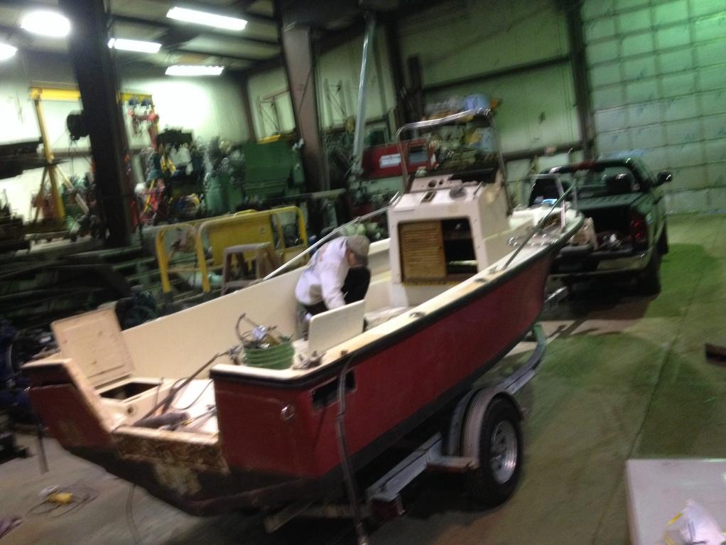

Well, 60 degrees in the northeast today, the trailer is a roller again.
So onto the regularly scheduled program. Plan is to get the boat inside and start demo on Friday, we'll see. Stay tuned.

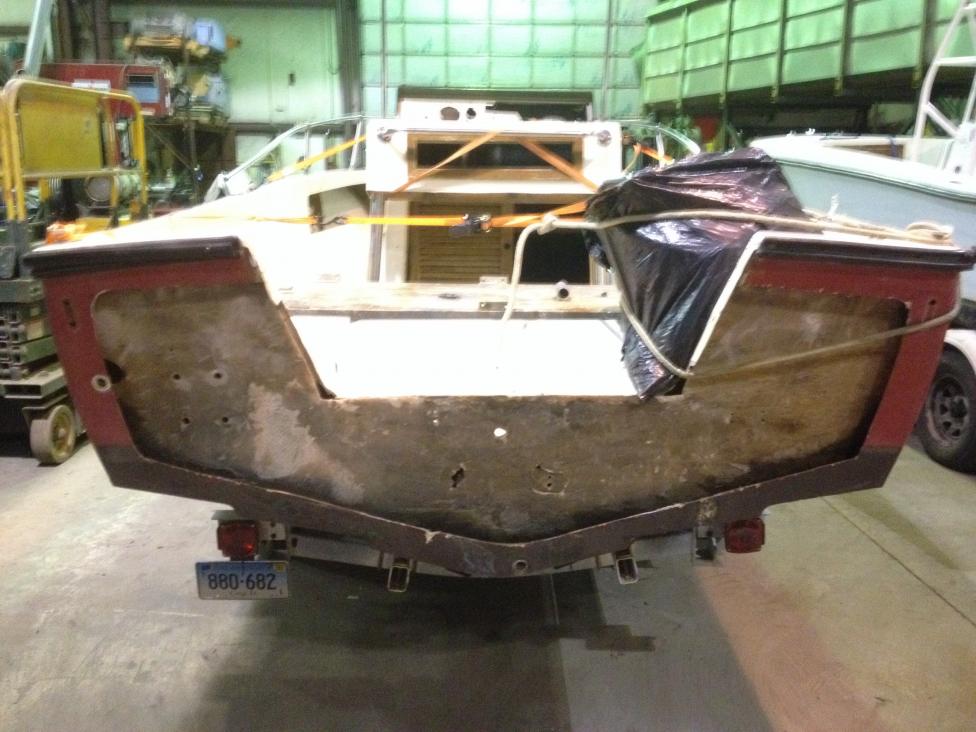

Got the transom out today.
