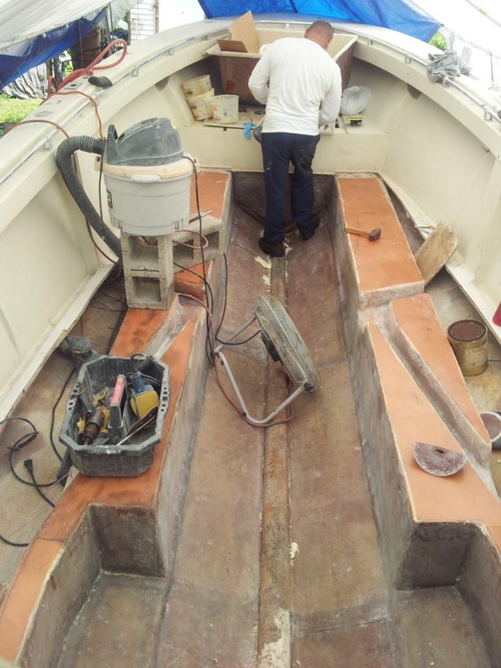

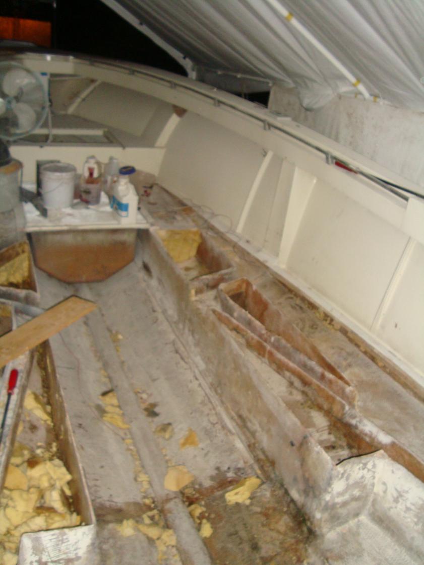

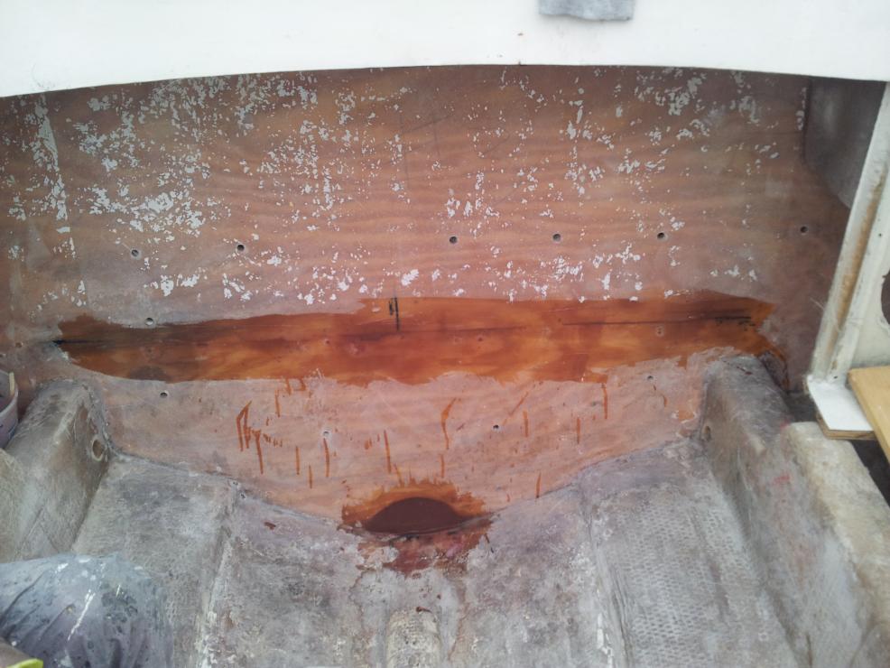

So I got some cover on the boat and finally got the stringers cut from the top. Busted and soaked with water. This is turned into the biggest pain in the ass but, it is going to get done slowly but surely. Have gutted some of the stringers but there still remains some water and foam towards the back will probably have to cut them from the side.
The plan is to dry them out, glass them from the inside and then from the outside once foamed in. Any suggestions on this? Also, what is the best way to air these things out?

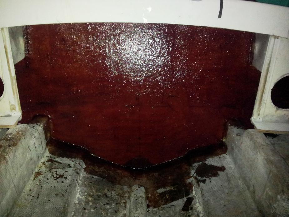

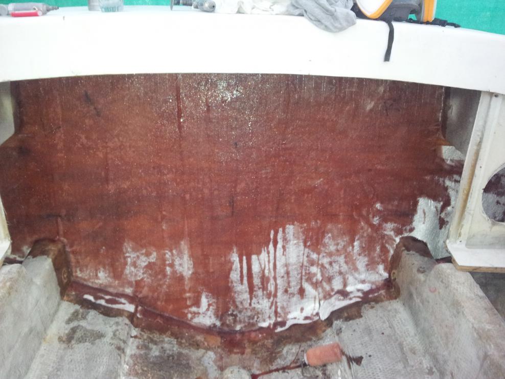

Transom was reinforced with biaxial and mat.
The work never stops!
Enjoy.

I've been under the weather lately due to certain events that have happened so progress has been slow and to some extent depressing. For starters, the guy that I payed to do the work pretty much ran off with my money after the first week and a half of work. Luckily enough I did not grant his request when he said he wanted the rest of the money, with only having done 25% of the work if at that. Between my schooling, boards and a dead stop due to not having the experience or knowledge to continue doing what is left. I have halted the project.
Beware, if in South Florida and you come across a guy name Joei... He is black, believe Jamaican. Referred to me by Andy from El Capitan which he tells me the guy will never again be recommended from his mouth to anyone ever again.

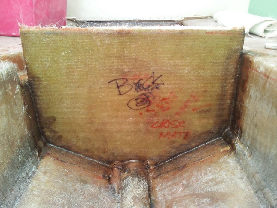

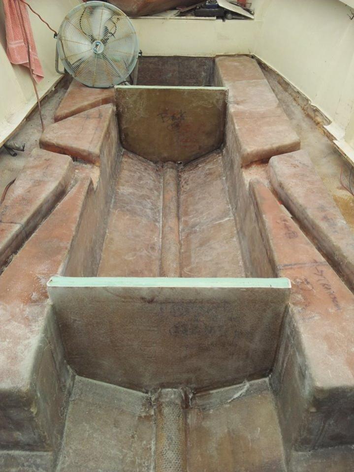

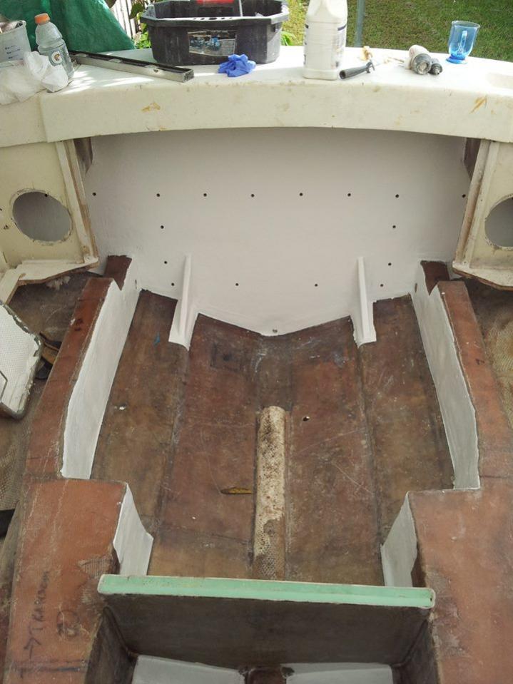

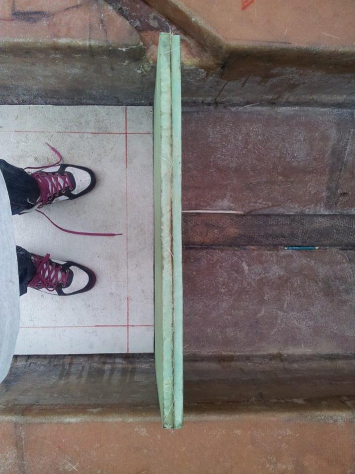

Stringers were gutted, sanded glassed and refilled with 4lb density foam and closed up. Bulkheads x2 (6lb foam coring glassed with mat,1708,mat front and back)

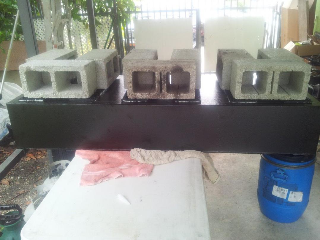

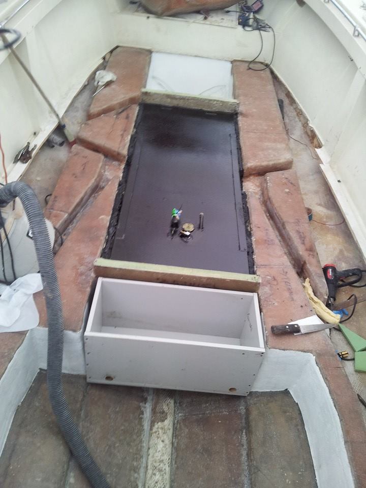

Fuel tank was sanded, washed, cleaned, primed, coal tar epoxied and foamed. Tank does not rest on floor and has a 1/2in rise off the floor ( no wood )

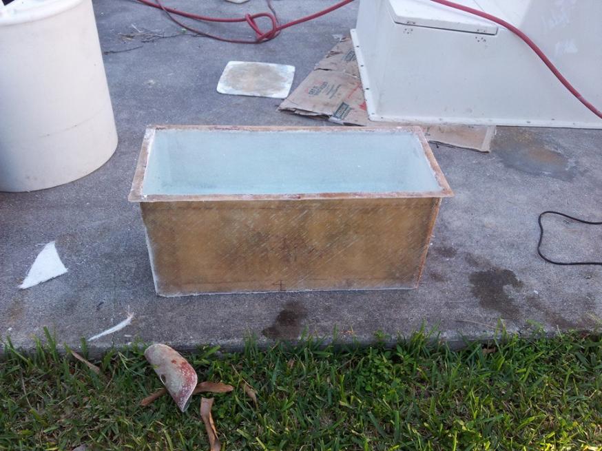

I made a mold for a tank for fresh water wash down, first tried had microscopic leaks, I added paste all around and reglassed no leaks what so ever. Will finish it with a coal epoxy paint job just in case.
I have hit a wall when it comes to throwing the floor on. =/ Ideas are present but have yet to go through with them.
