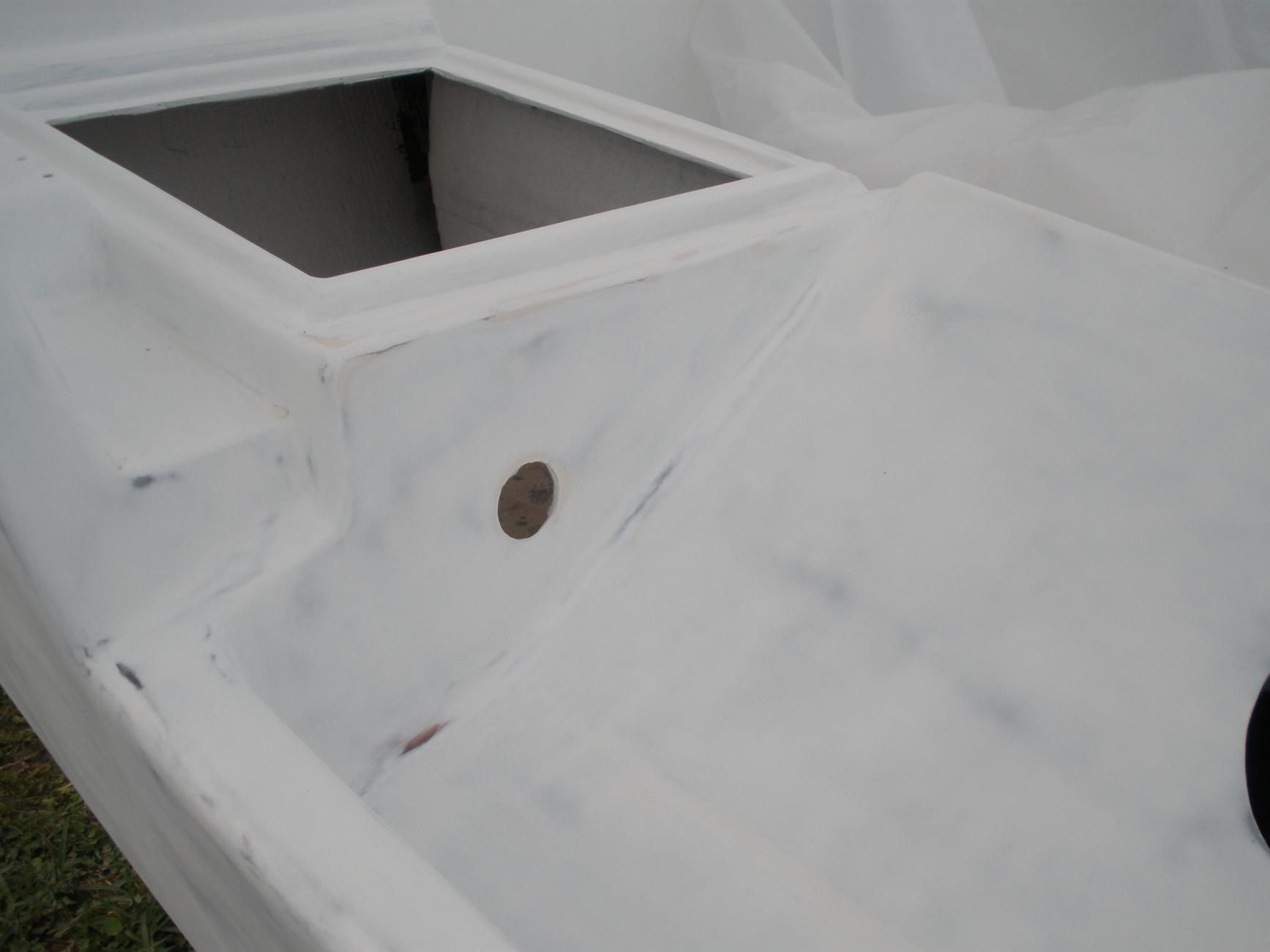

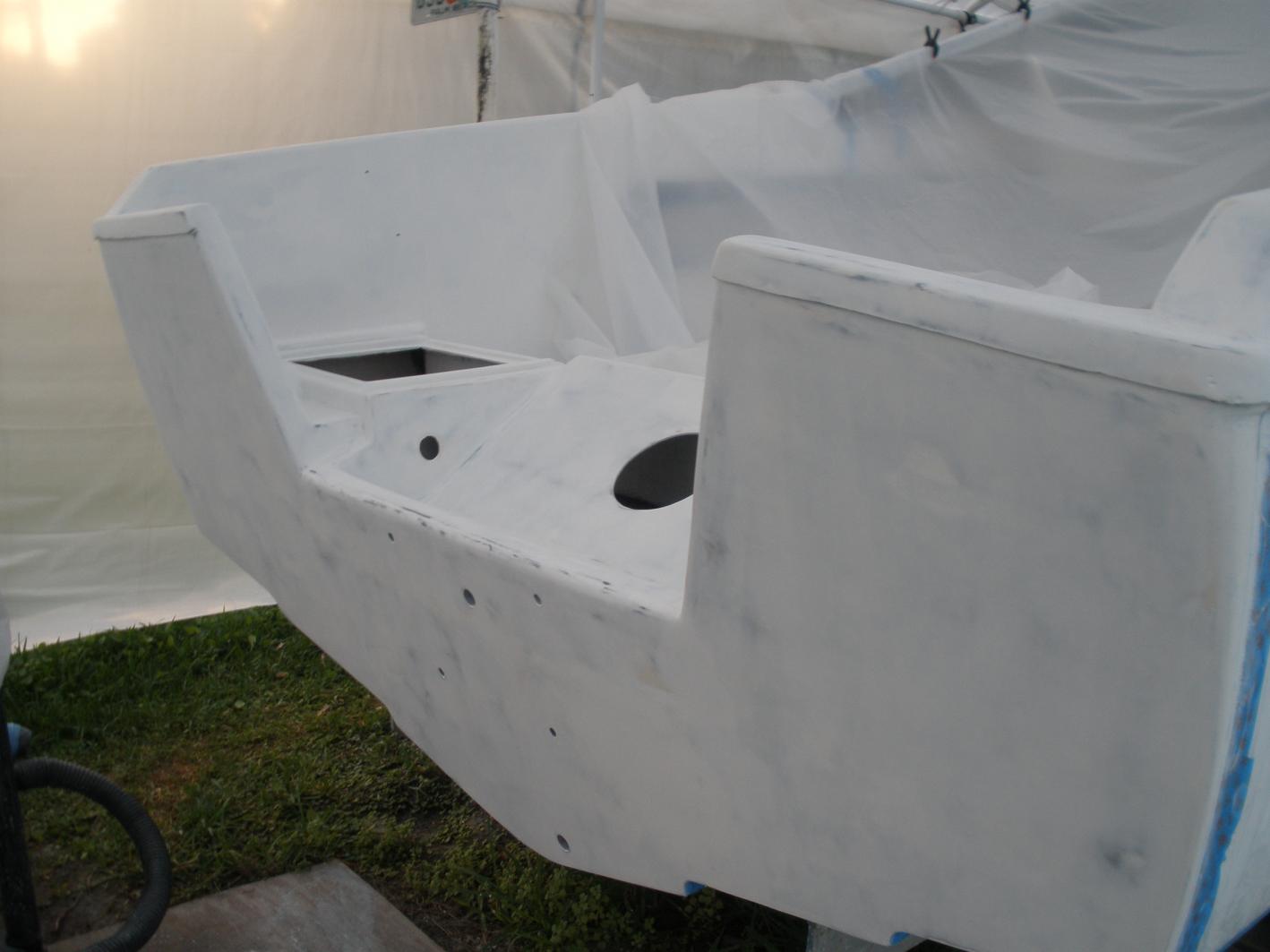

Drilled motor mount holes and drain holes in the transom, and treated the holes with thinned resin. Rolled on some Interlux Interprotect primer, sanded down, applied some more on the remainder. This stuff works pretty well at filling in some of the smaller pits that remained in the fairing.

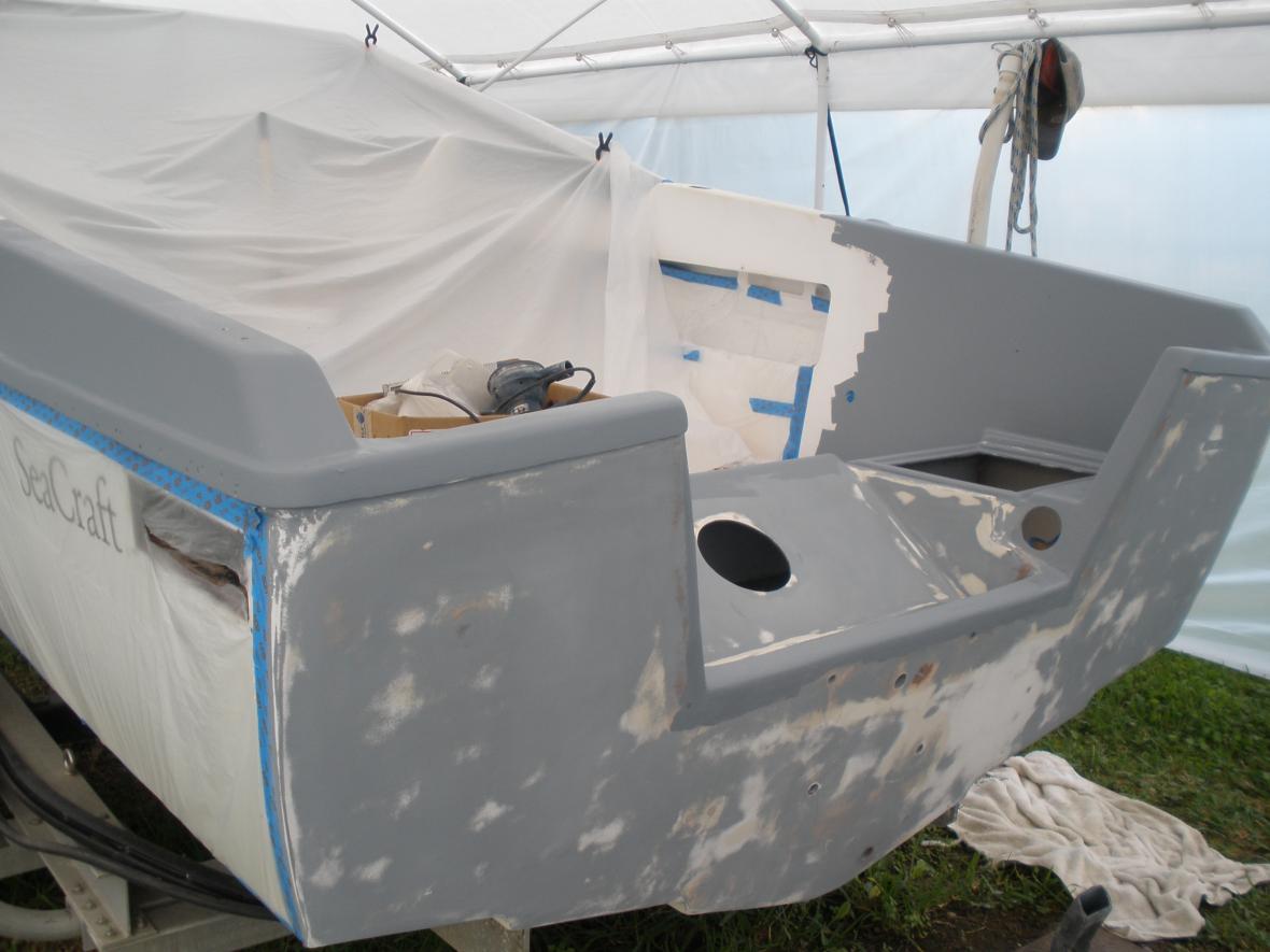

Just tried to roll and tip first coat of Interlux epoxy primer, and made a cat's ass out of it. It seems like the paint did not flow at all, and dried way too quickly. I thinned it about 25%, which is what data sheets recommended as a minimum thinning.
Anyone familiar with this paint application method, and got any tips? Does it sound like the paint was not thinned enough?

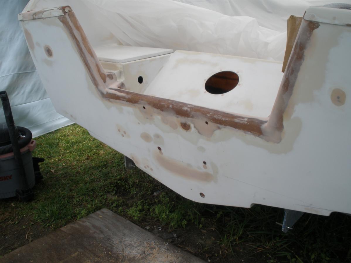

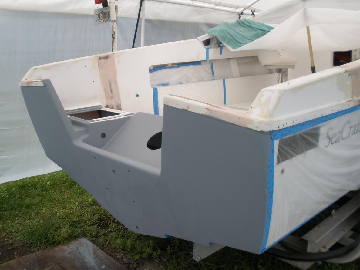

Strick, FF- Thanks for the tips. I did not have epoxy resin on hand so I used the polyester to coat the wood in the drilled holes. I painted some Interprotect in them also, so hopefully that'll help. I know, not optimal, but it's done. I sprayed the last time I worked on this boat, and thought I'd try the brush method for kicks.
FF- I used the 2333N reducer that the data sheet specs out for brushing. Lots of contradicting advice out there. The data sheet says to thin 25% minimum. Yachtpaint videos on youtube say to thin no more than 10%. Anyway, I think I thinned the first coat too much.
I sanded most of the brush strokes out with 120 grit. Thinned the second coat to ~10% and rolled on second coat with a glasscoater roller. Tried to tip again, but was having similar results, so I just rolled it. I cut in the fillets with a brush this time (last time I rolled in the fillets using a small foam roller). I thought brushing in the hatch channels and fillets would be a pain, but that worked really well! The roller left some stipple, and the brushed areas smoothed out well and needed very little sanding. I sanded most of it down today with 220 grit. Plan is to finish sanding and roll/tip the topcoat tomorrow. I hope the top coat paint is more self-leveling. I will be using Perfection two-part urethane.
