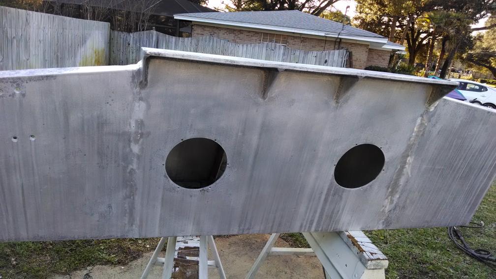

Now on to the bracket for the boat. First I used my water sandblaster that I got from northern freight. did a quick blast. ten I used ppg alum. prep.rinsed real good. and then used ppg barrier coat. dry out is the sun . then applied three coats of belzona5811 and made sure I hit all the nook and crannies.

Default bracket
prep work
