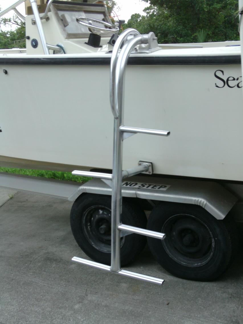

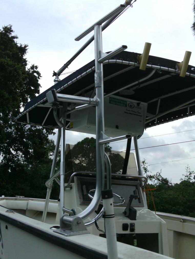

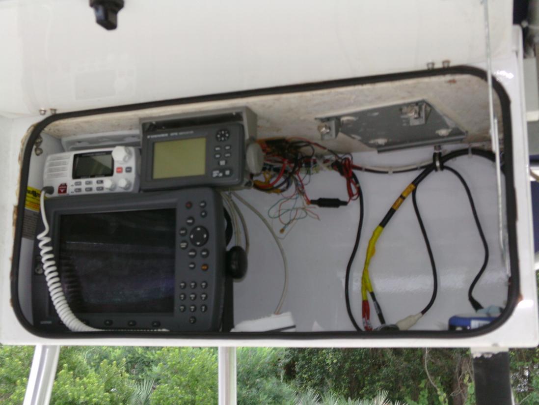

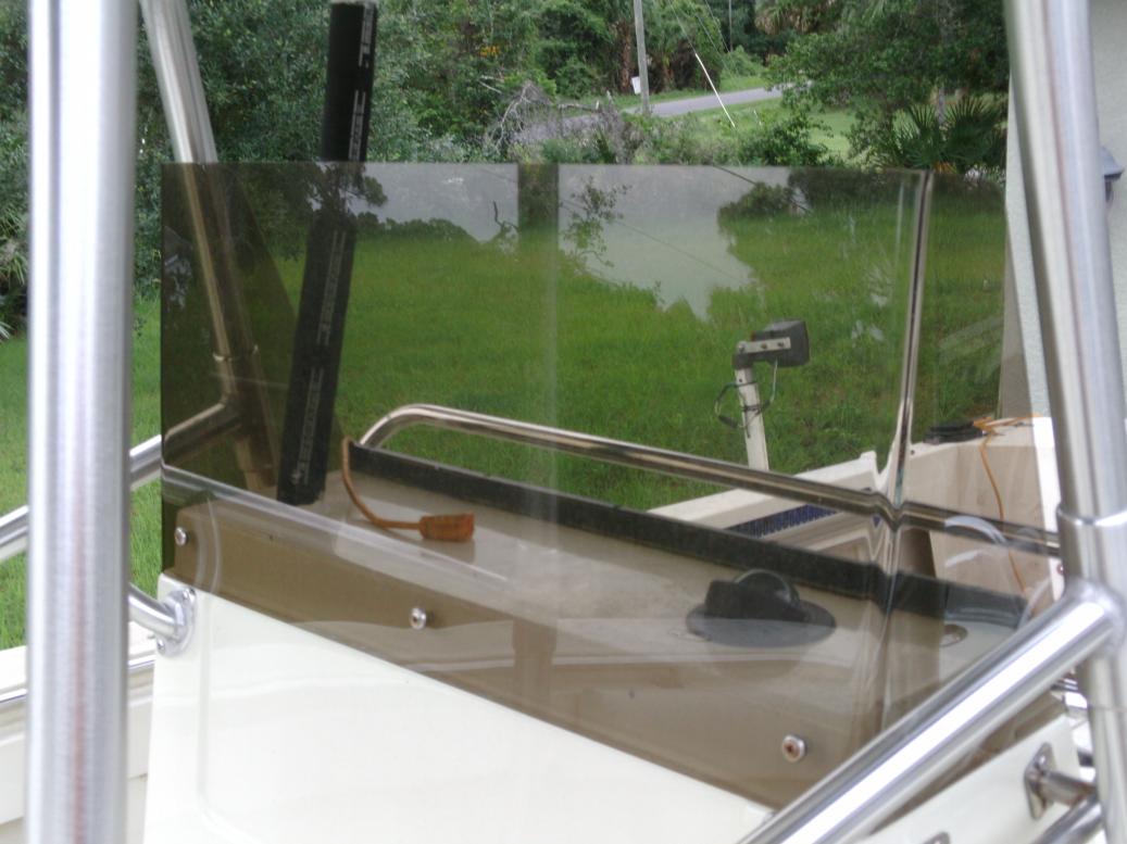

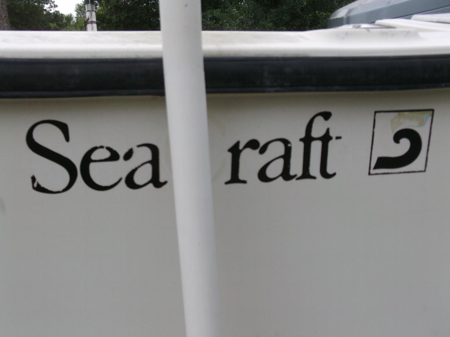

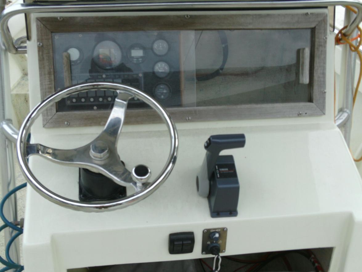

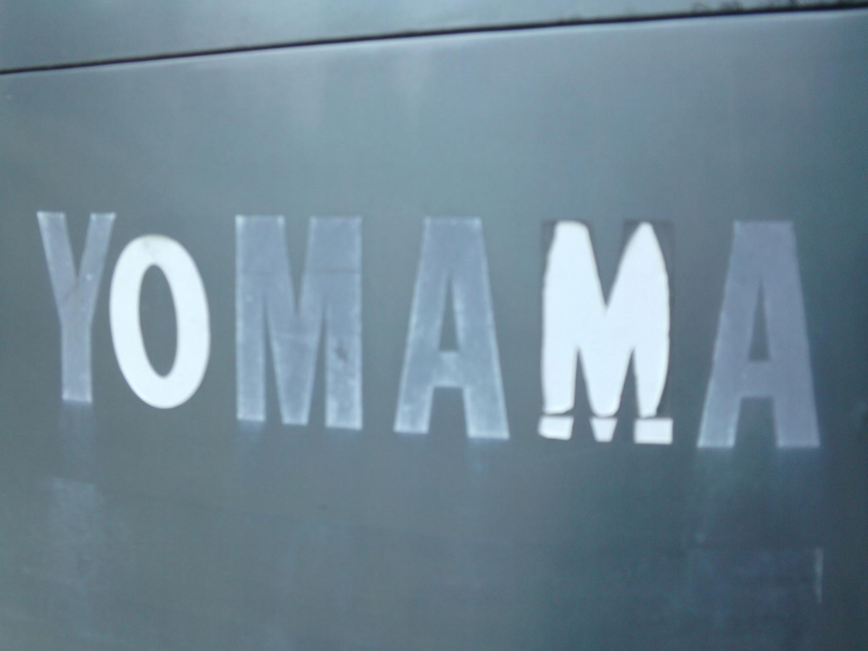

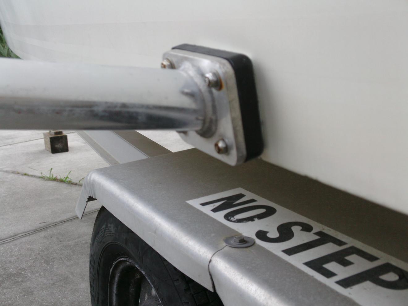

Well it has been a while since the last post. It isn't that I haven't been working on the boat, but been too busy to post any pics. To bring everyone back up to speed, the following has been completed. T-Top/outriggers/antennas installed. E-box installed, just need to re-terminate two wires and install bottom machine. Console and new windshield installed. Most of the wiring under console has been completed. Need to install 21 gallon freshwater tank and battery box. Sweet, bad to the bone dive ladder has been installed and I would guess it would load test a four hundred pound fat boy easy. Fired the YoMAMA up after 15 months. It idled a little rough, but after an overdose of SeaFoam she is running much better. Anyone want to donate their gas sipping outboard to the cause? Still need to install the leaning post, fix some wiring to the trim tab pump, and plumb the bait well. She is getting closer, wish it was already finished!

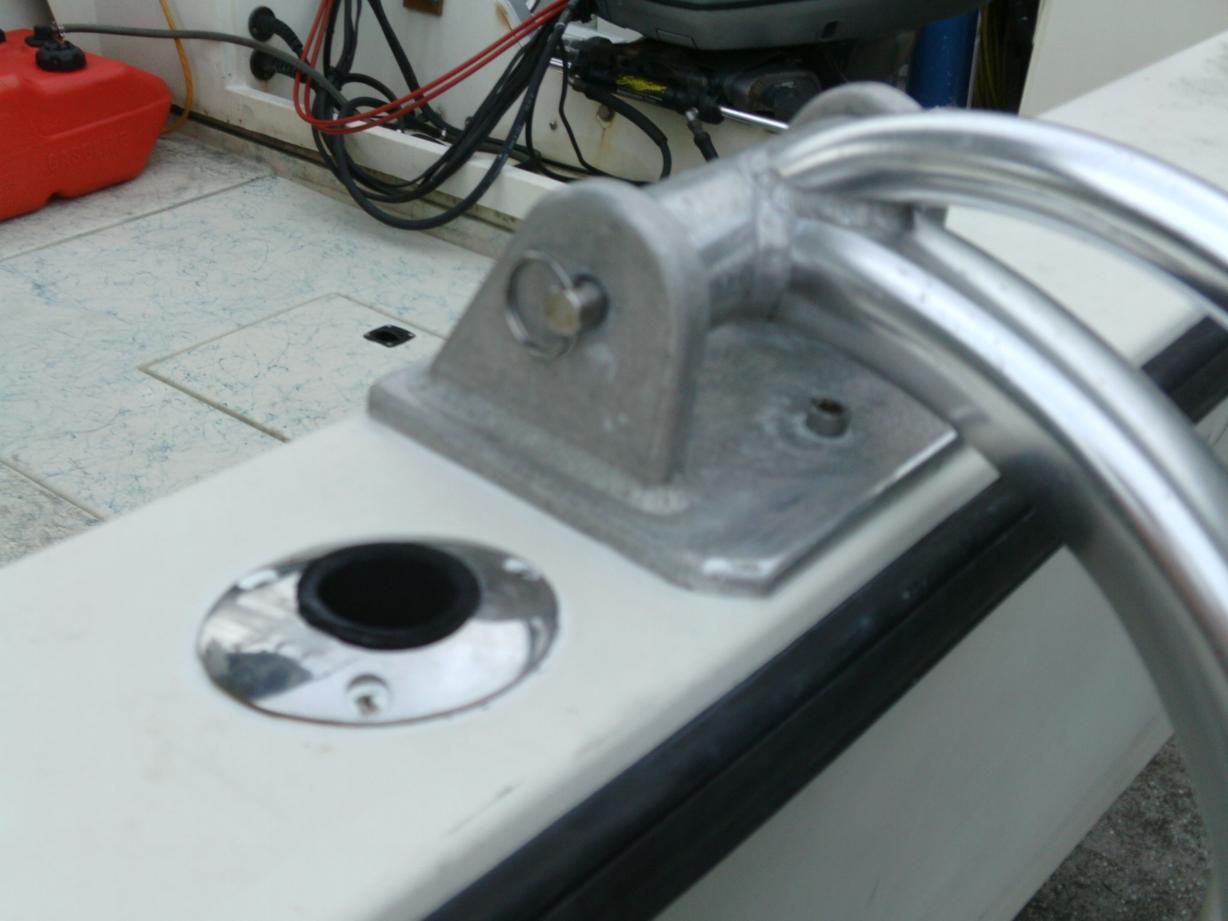

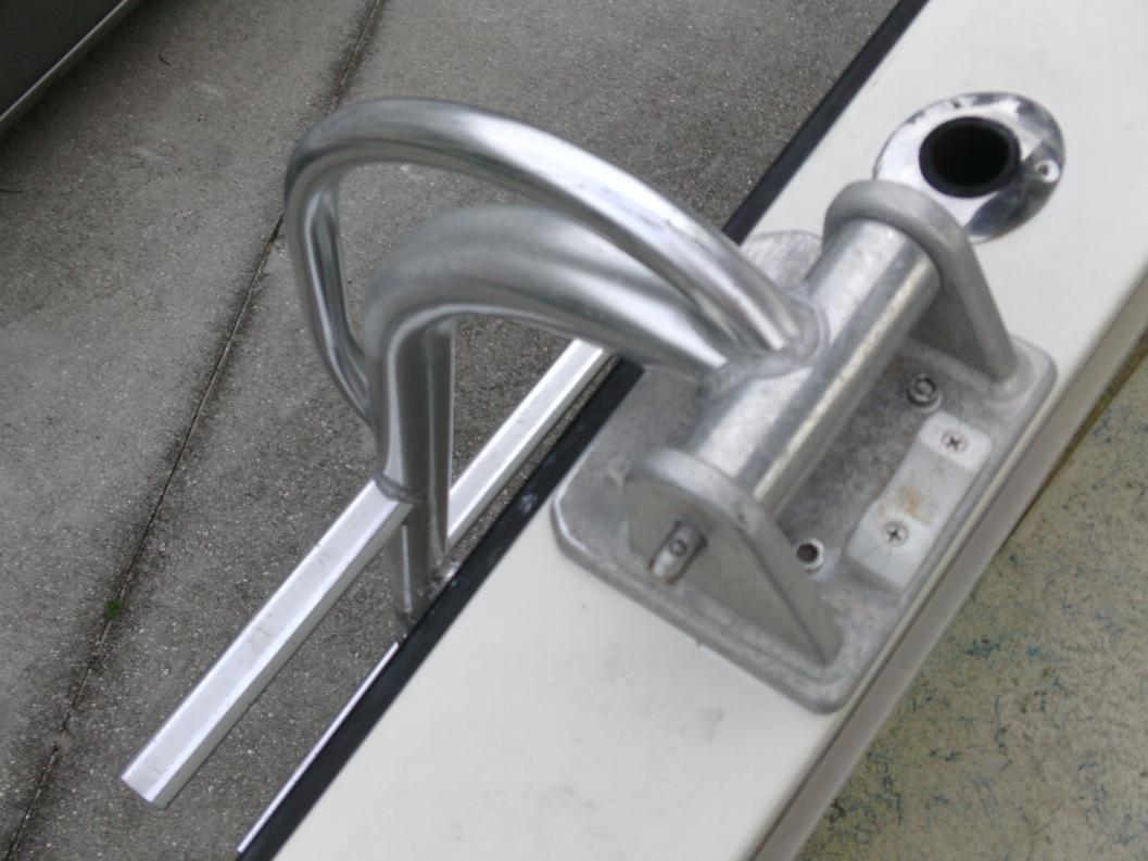

Posts: 29
A few more pics and I almost forgot, I need to paint the engine cowling!
