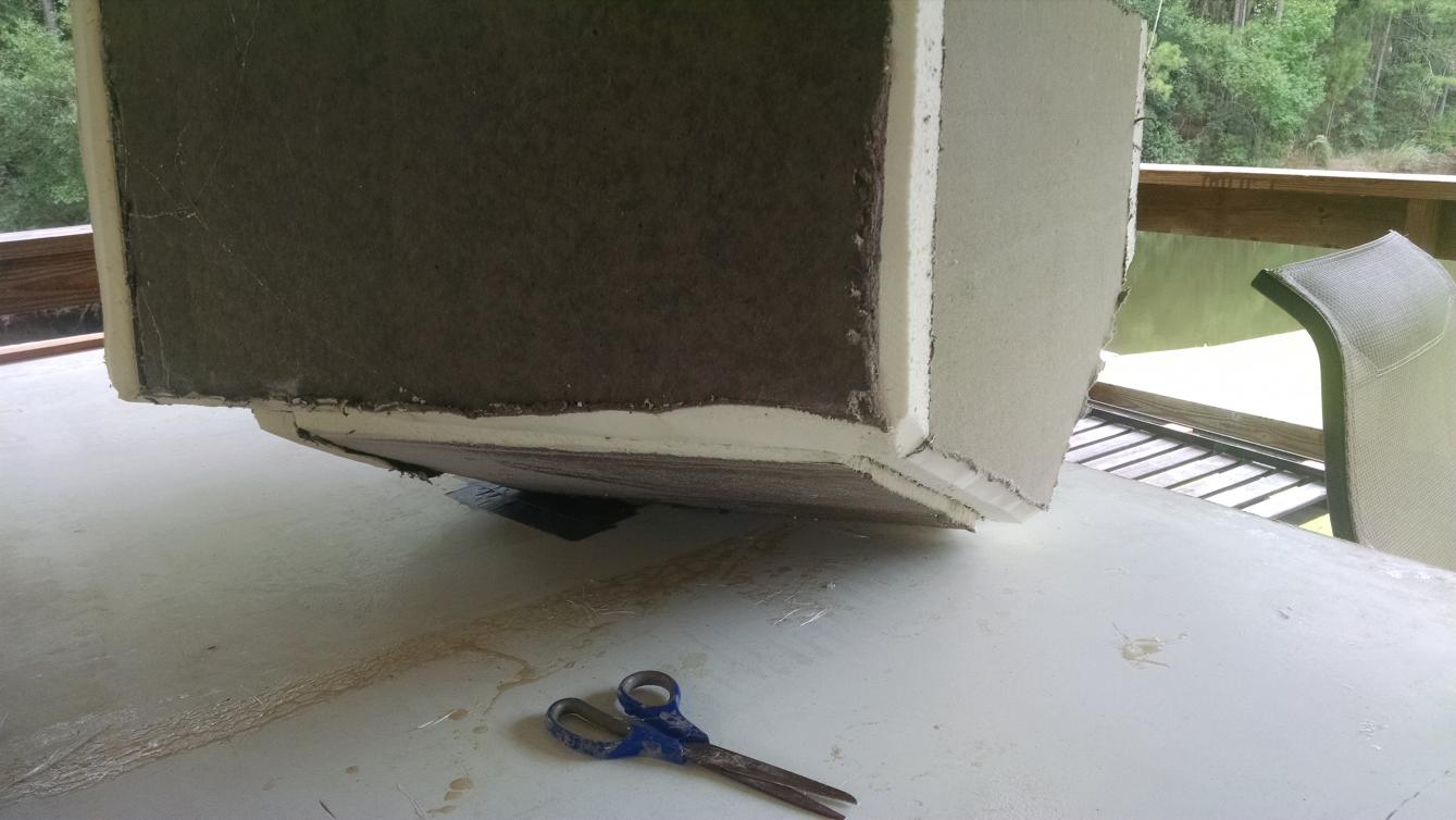

I finally am back at it. Got fuel hoses from tank secured and put an aluminum pipe under the cross brace on the forward tank.ground down the bilge area and prepping to glass. Built a forward insulated cooler. Will glass it tonight ..

Default cooler
Cooler

2" low density foam. Cut to fit and hot glued together

Finished glassing outside. I'll fit it in the bow..then bed it with epoxy and cabosil.

Default cooler
Glass
