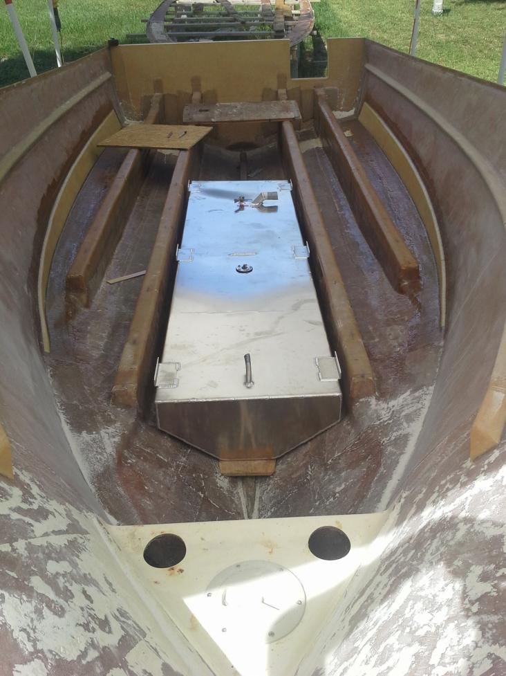

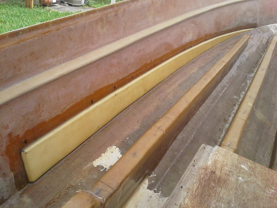

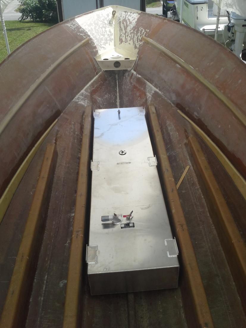

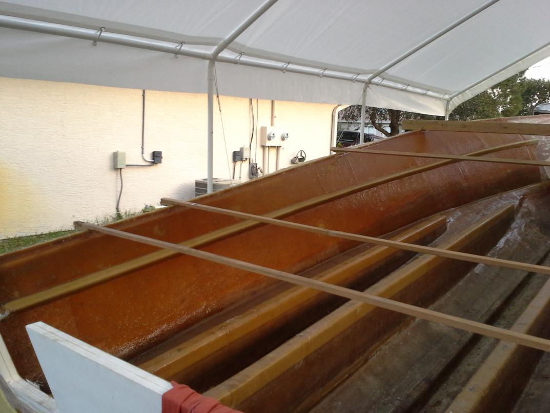

Got quite a bit of work done on the boat. Braced up the sides with some foam and glassed over the entire sides with a layer of 1708 and 2 layers of 1.5oz mat. Then added a ledger using .5 in celtec and glassed over with 2 layers of 1.5oz mat. This stiffened up the hull sides significantly! I got my custom 70gal tank built and it fits perfect. Started cutting the floor peices and bulkheads using .75in celtec and have been lookin for a nice console and leaning post/livewell. Marine connection has some nice stuff but big$$$. Might have to bit the bullet and get it.

So wat do yall think of the tank? I need a livewell and dont really want a leaning post/livewell. I really wanna do a transom 20gal livewell but am now havin doubts after all the feedback from yall. Will it make a noticable difference if I put a leaning/livewell instead of a transom livewell?
