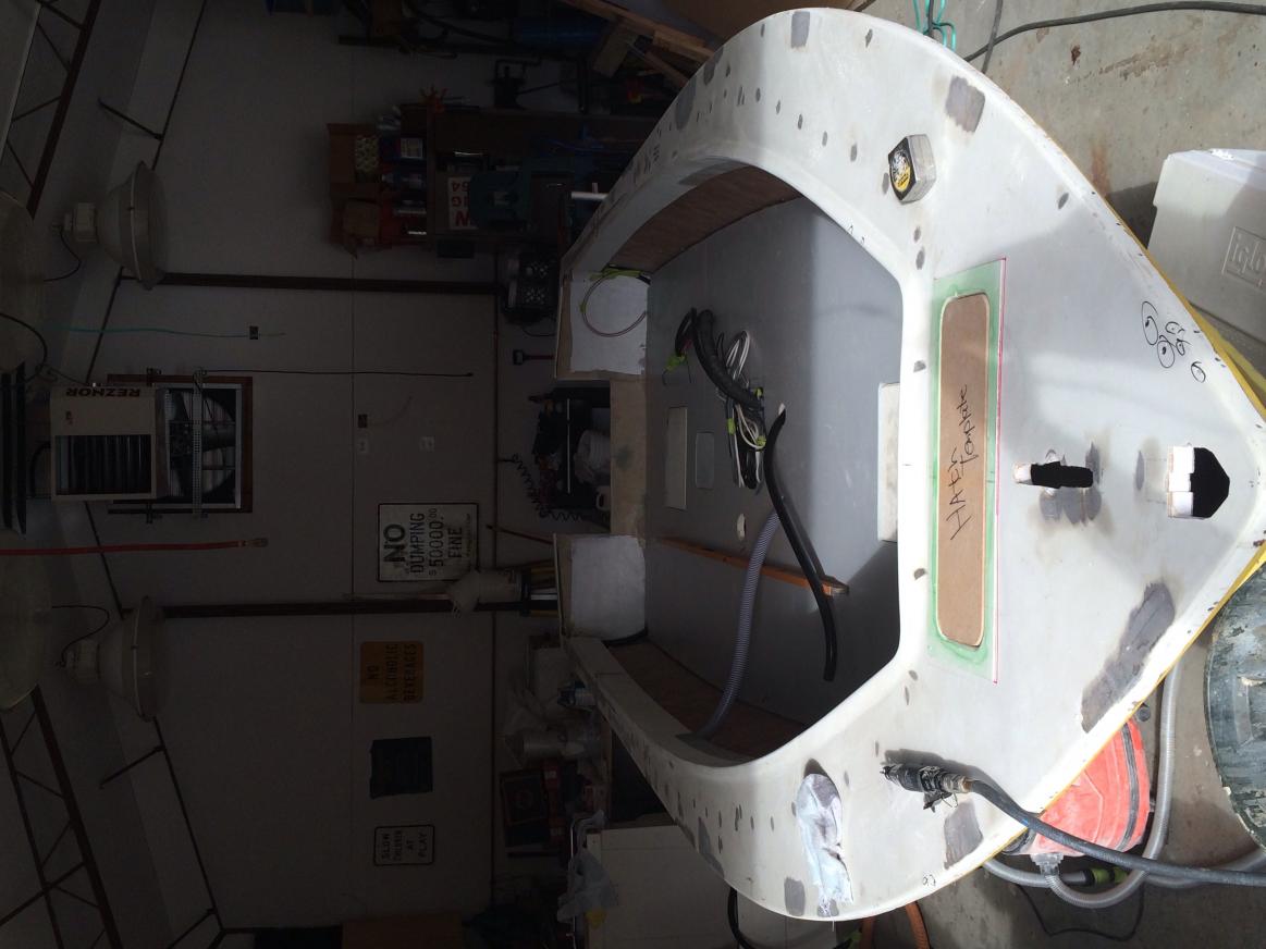

I pulled the buckets off the deck and i cant believe how strong the deck is. It reminds me of the commercial boats i used to work on.
Gunnel cap, forward bulkhead, anchor locker door and time to start on the rear boxs and engine shroud

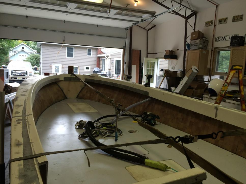

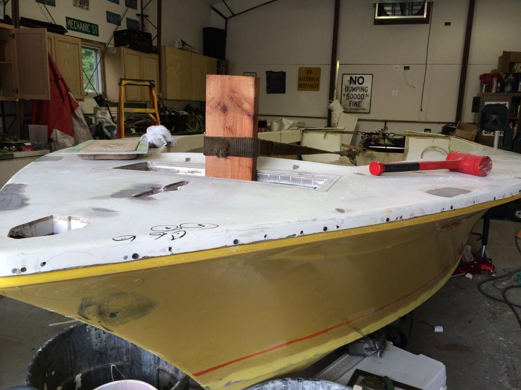

Got the bow hatch cut in and partially fitted and put the gunnel cap back on to fit the bow bulkhead

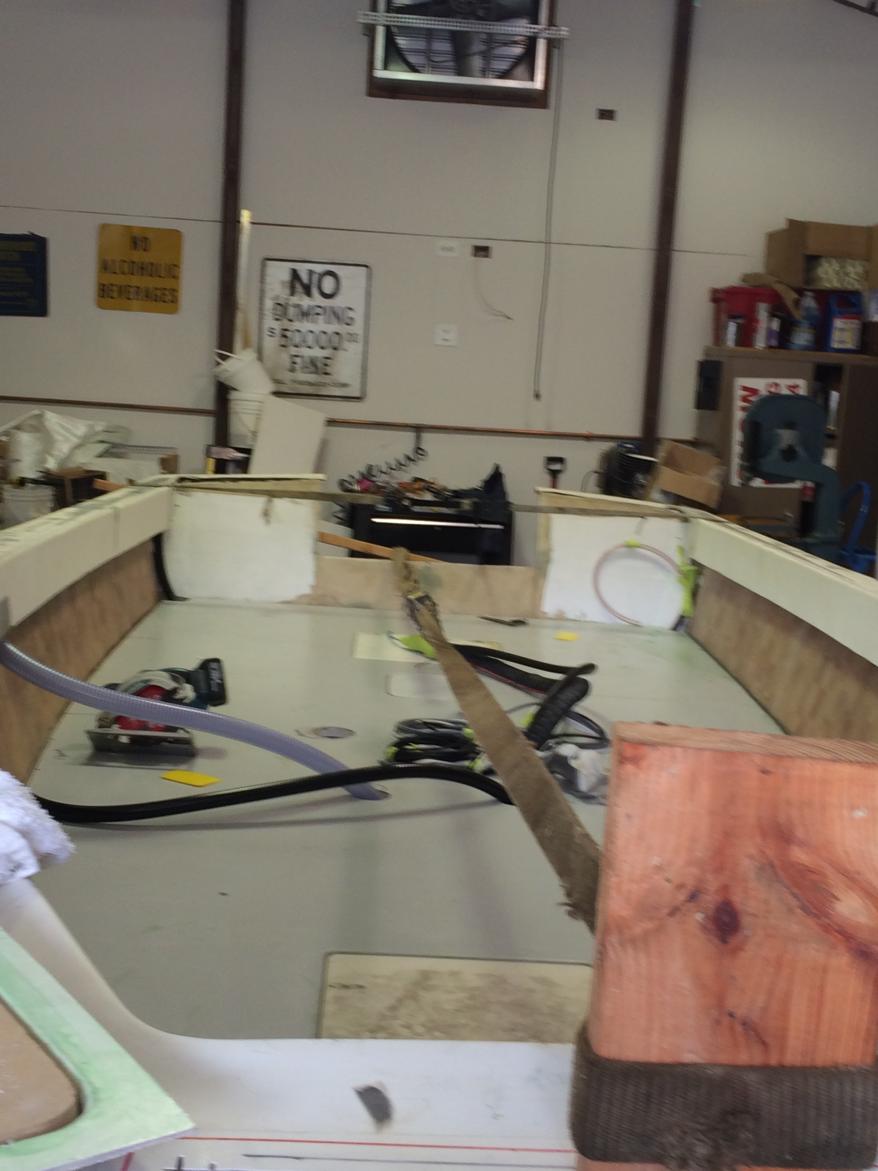

Got the console back in and dry fitting it to the floor

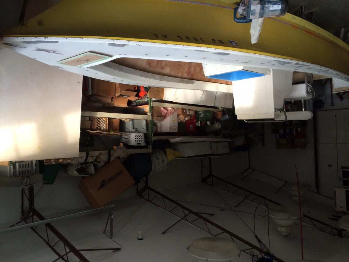

Stupid phone..... Cant figure out how to rotate

Billy, hope you do not mind the repost.....
Twas' getting a little dizzy and it is not even happy hour yet..
She be looking real good to.

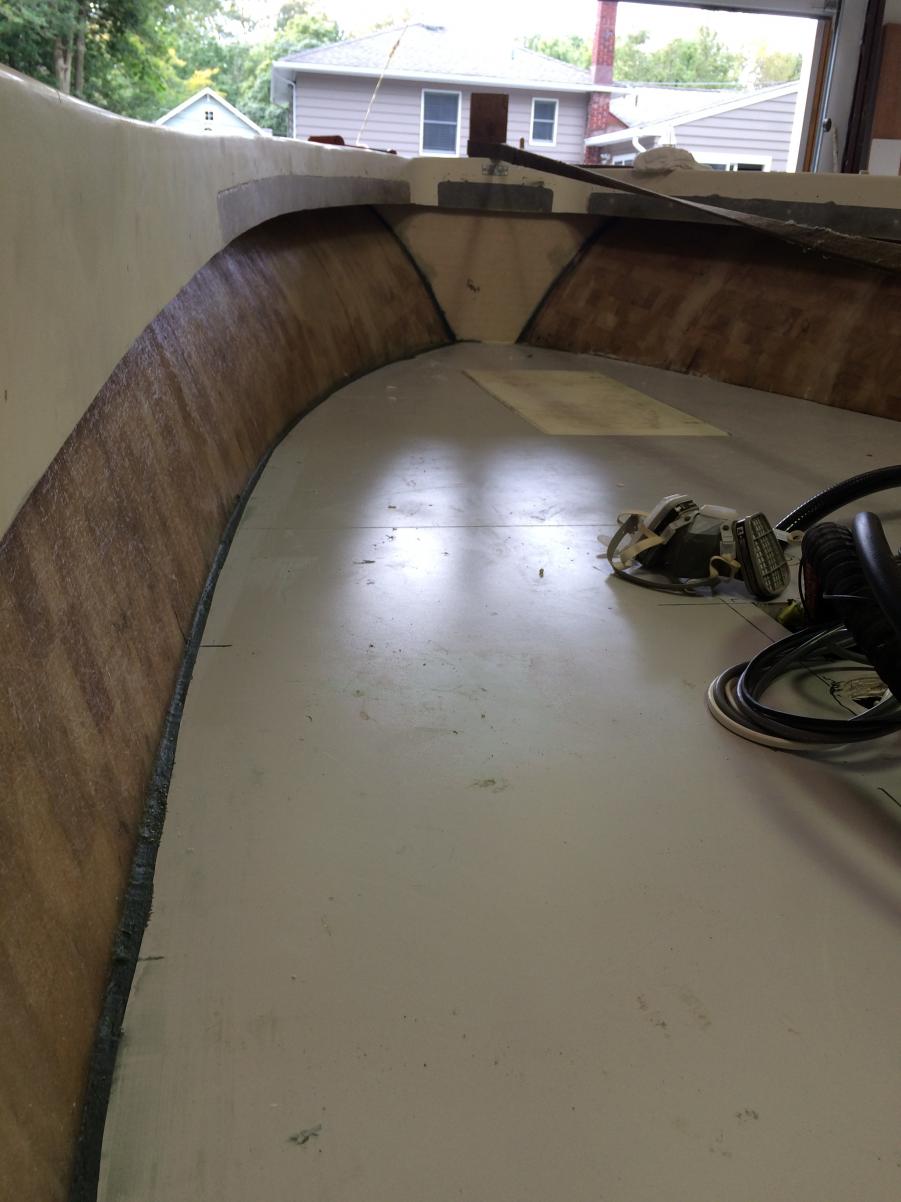

well I got some things dome on Saturday in the rain, I first wanted to get the top cap secure and I was off by about 3/16" of an inch getting everything lined up so I rounded up some things in my garage and got it out back into place
first I filled the gap between the hull and the floor.
once I got the cap close to being lined up I pinned it in place with sheetrock screws till I went to Fastenal for the ss screws. I counter sunk #8 ss screws all the way around and mixed up some potter putty in a mason bag and filled the gap under the gunnel hull connection

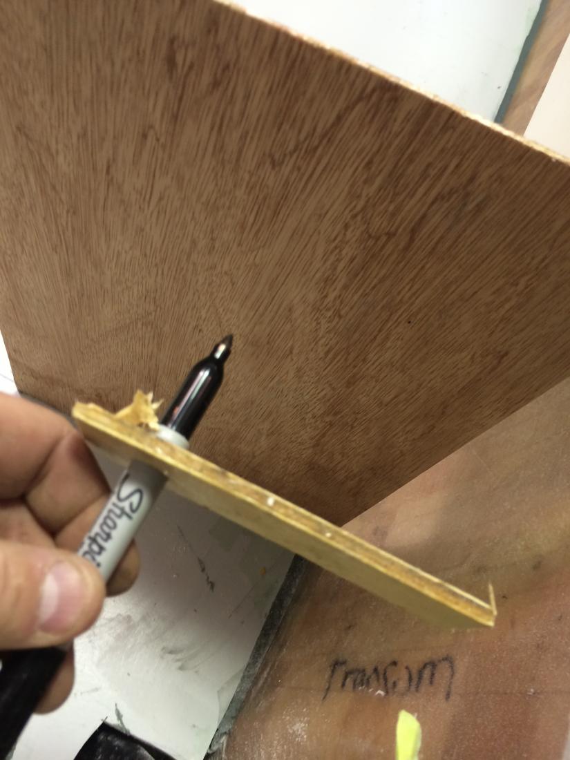

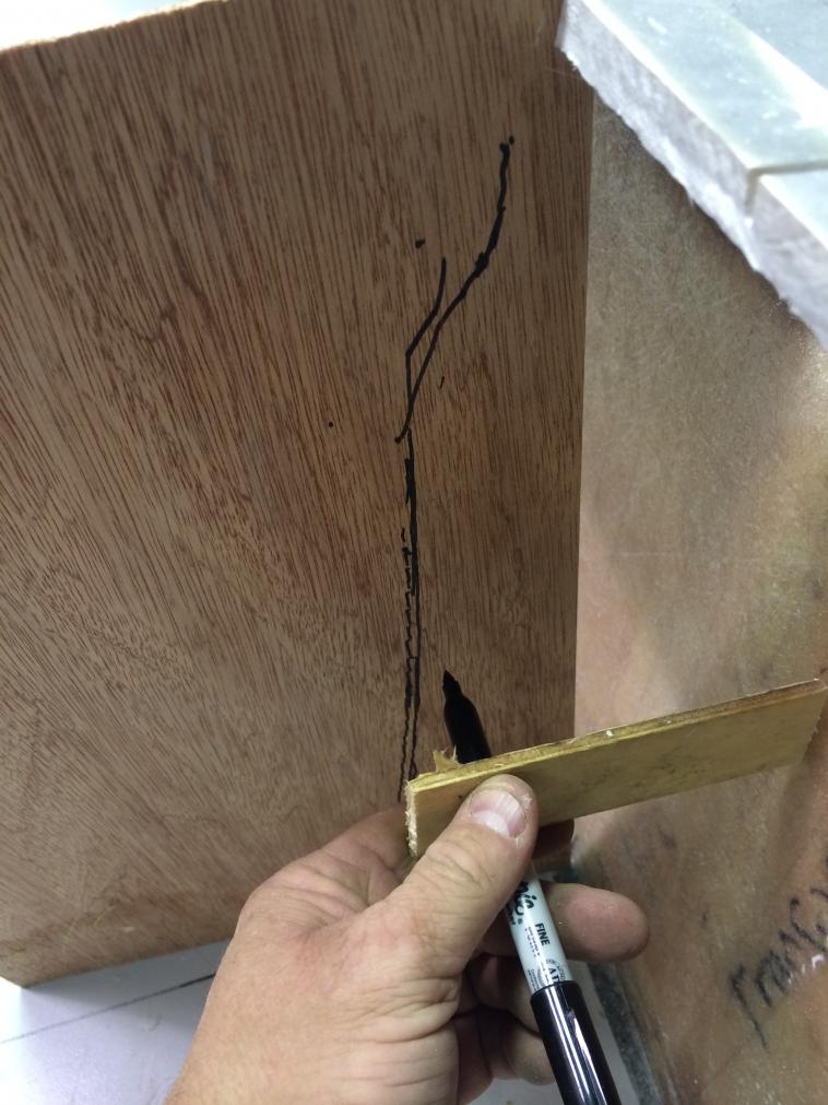

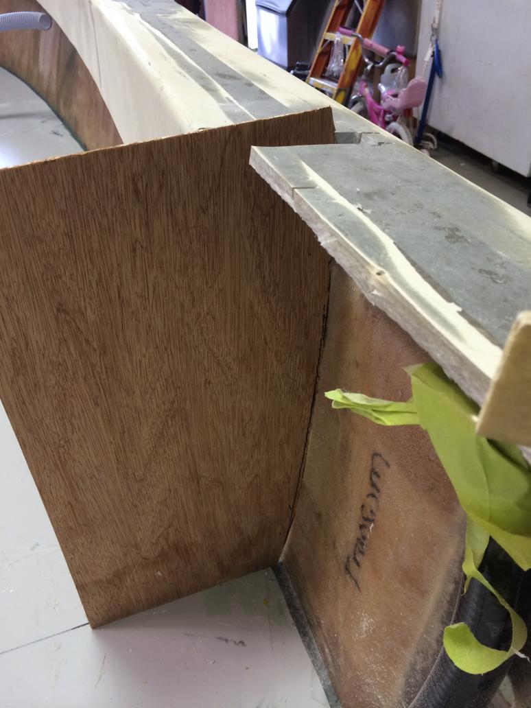

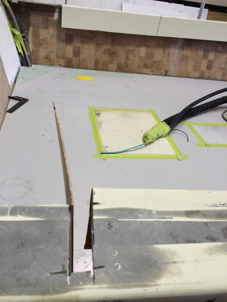

Once I got the cap solidIt was time to attack the rear boxes, First I got my measurements and cut a slot into the top cap for the bulkhead to slid into and lock in.
once I had that cut I made a template of the hullsides to cut the bulkhead.
got the template done and transferred it to the 3/4" divinycell sheet I made. I cut the bulkhead and slid it in to fit.
