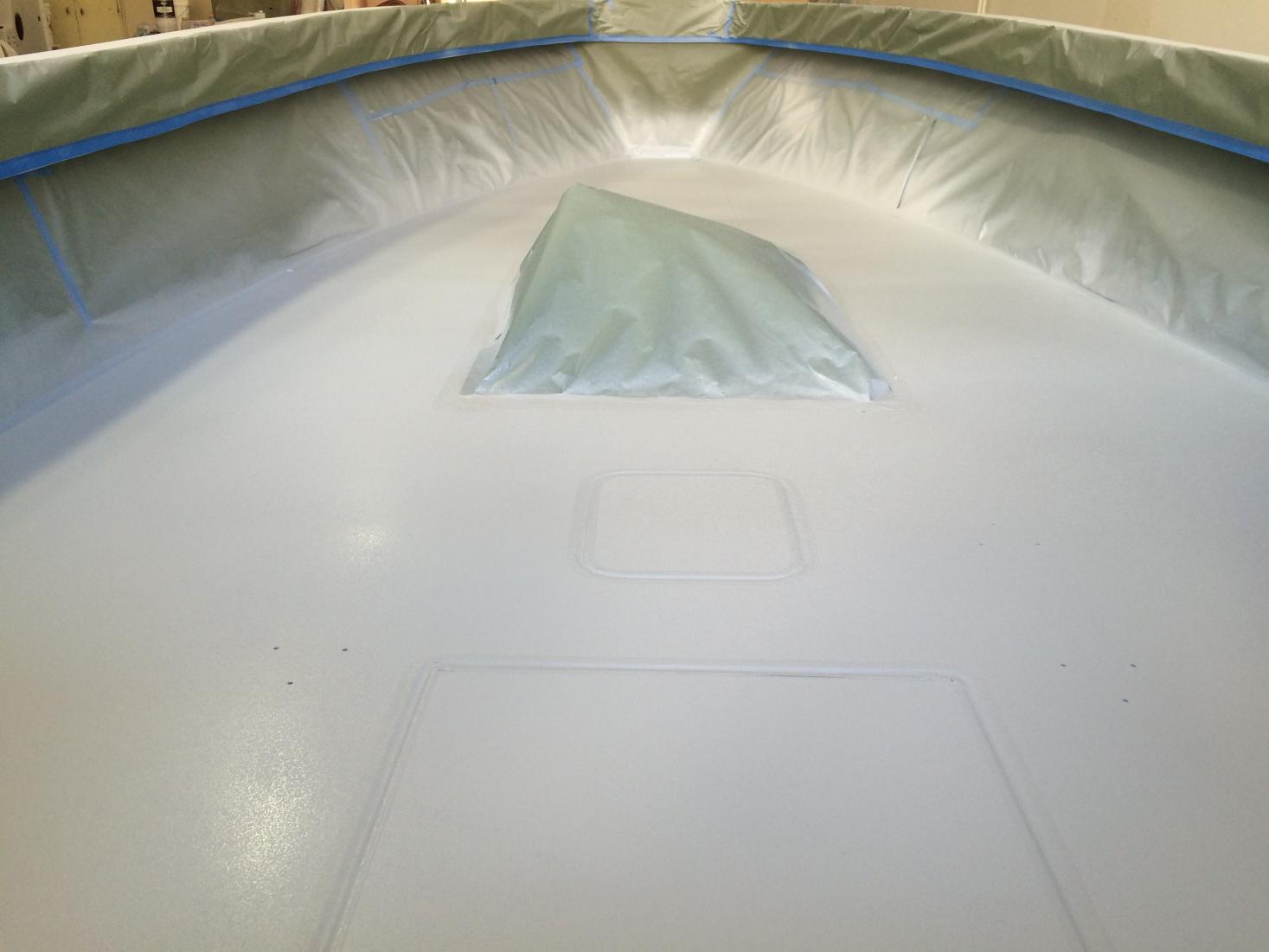

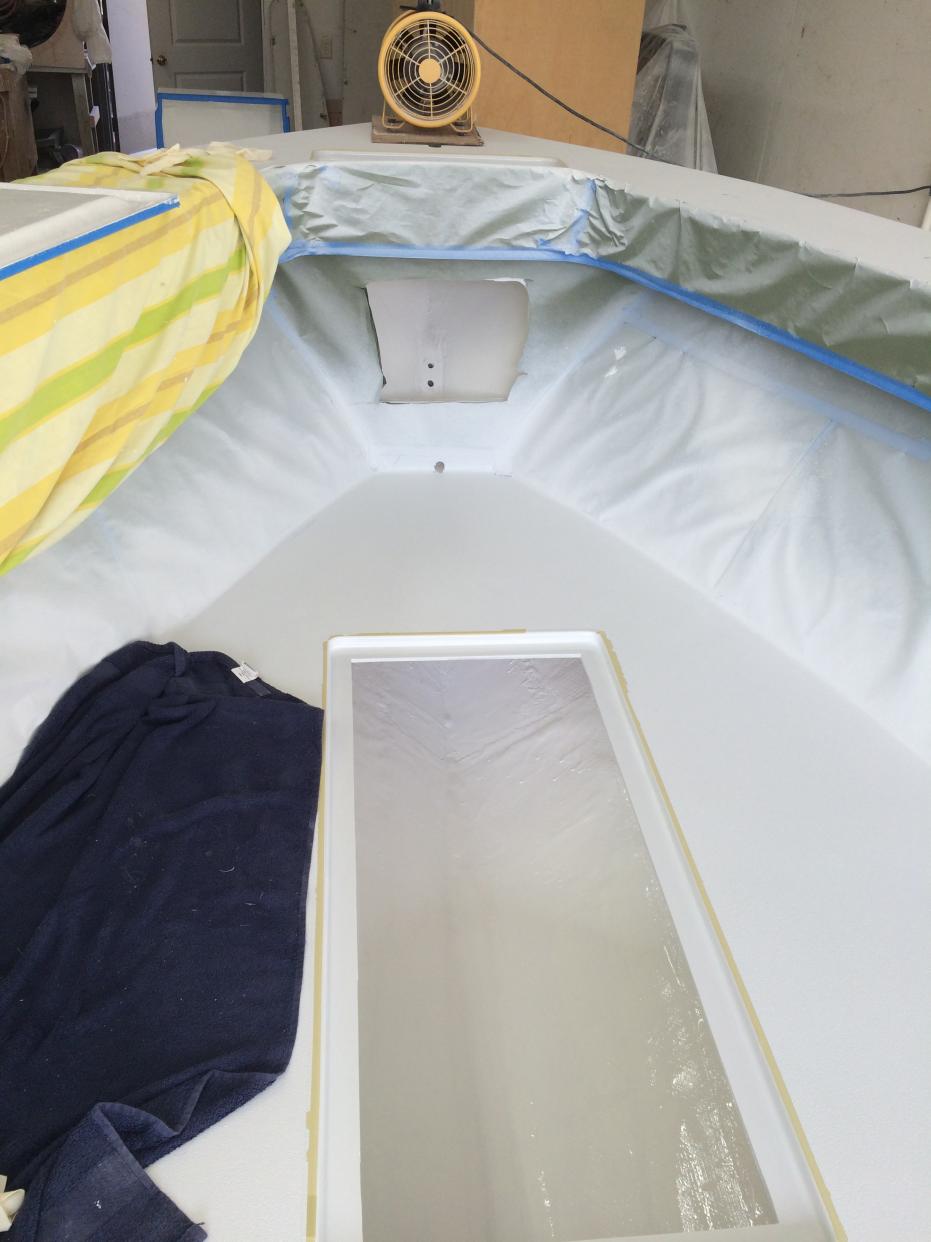

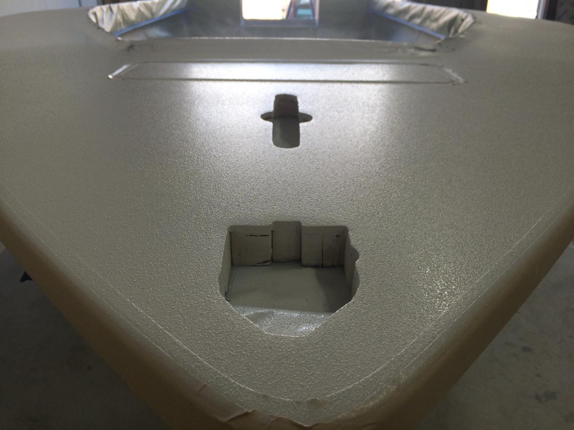

alright Randy is moving right along on the project and lots has gotten done. the boat is fully painted and nonskid has been applied to the floors and gunnel cap

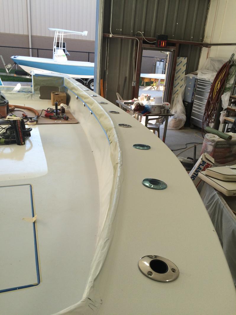

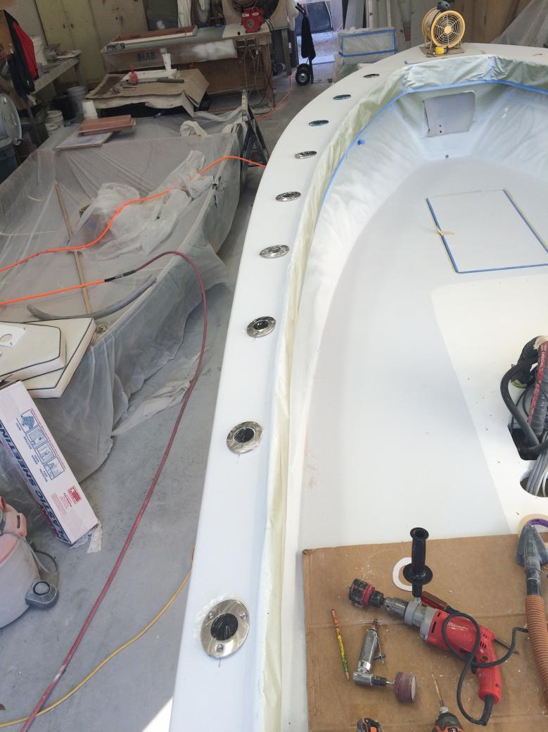

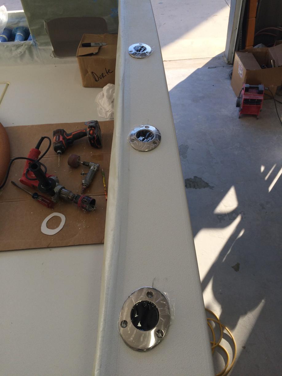

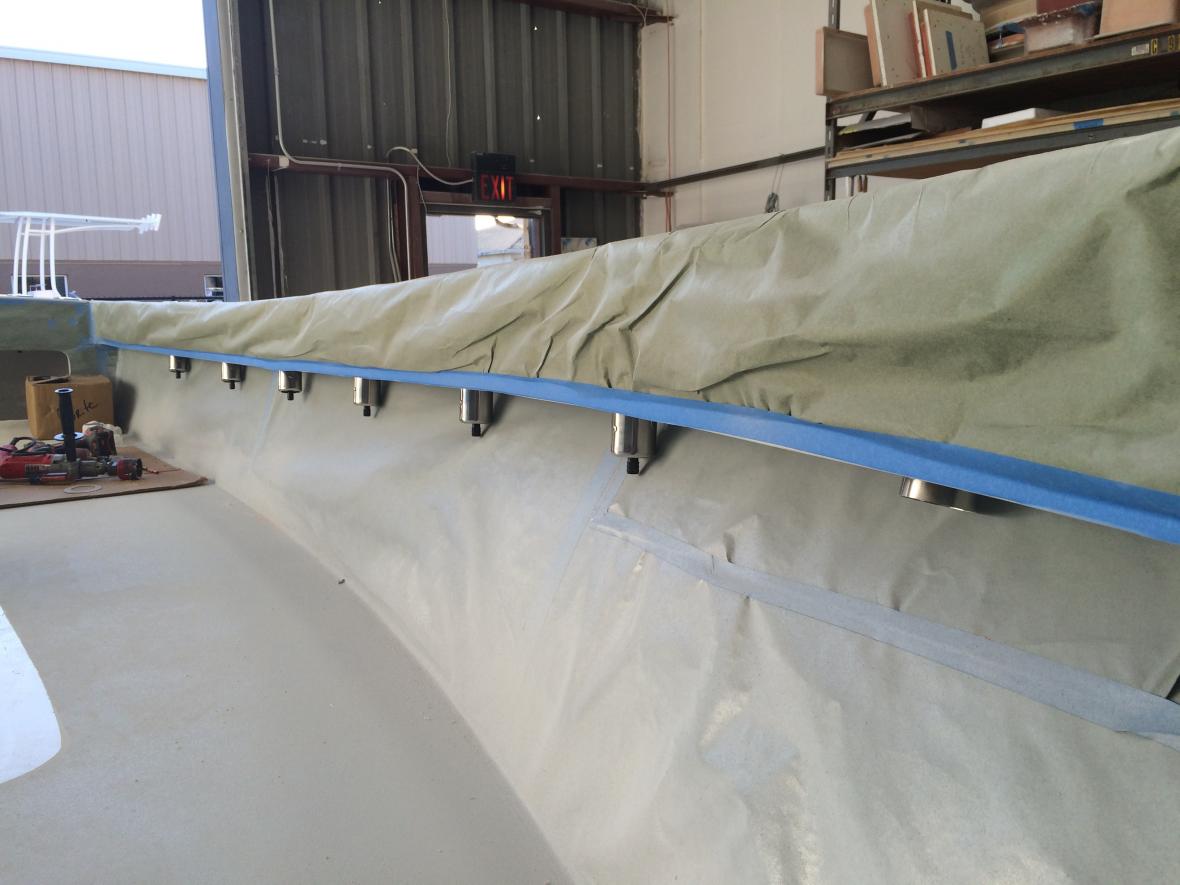

then it was time to start drilling holes and mounting hardware
I think a need a couple more rod holders.....

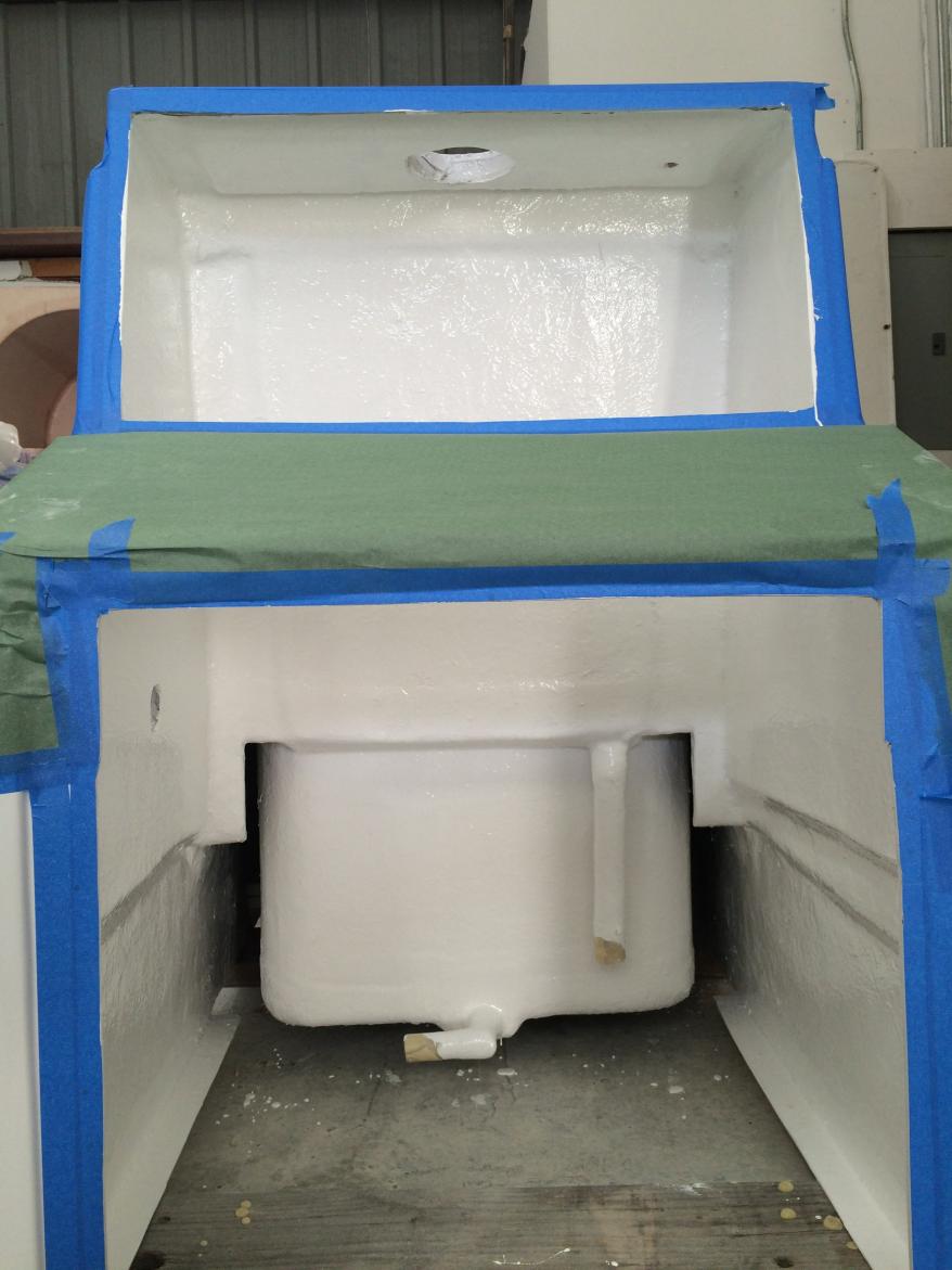

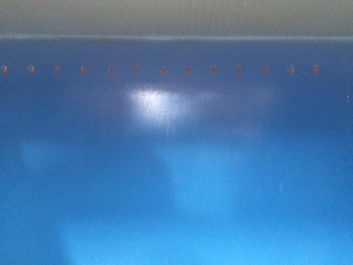

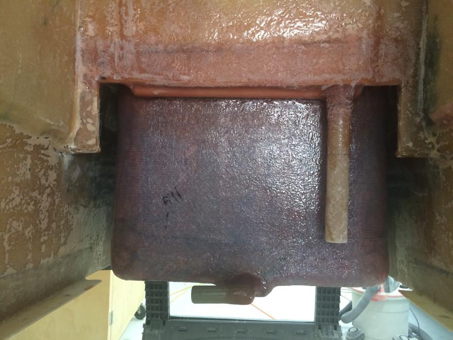

then the modifications he made to the livewell with the glassed in sump on the back and the holes drilled through for drainage, this way the only thing in the well for the baits to swim into will be the fill

Looks great what kind of filter are you going to use between the pump and the bait tank to insure the holes don't get clogged ? Is there a way to clean it out?

no filter on the livewell pump, they get clogged to often. the holes are 3/8" I might add another row of them.

Old 05-22-2015, 01:37 PM
Enlighten me please...that many rod holders?

When we flounder fish and fluke fish we use lots of rods and its easier and safer toput them down in the rod holders.
