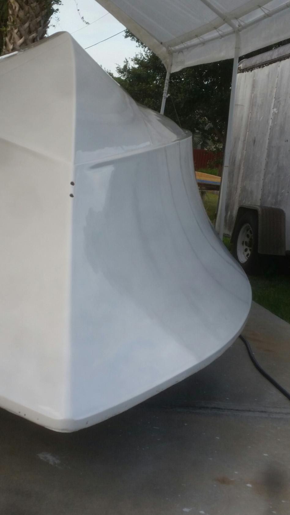

Couple pics after first coat of wax.

Looks good, plan on doing the same thing, will be mixing with duratec and shooting tho, my brother is redoing a small whaler right now and he tried shooting gel with a dump gun but had tons of orange peel, was sanded down and reshot with duratec and gel and boy does it lay down, sanding time was cut at least by half if not more, duratec will make lay down
