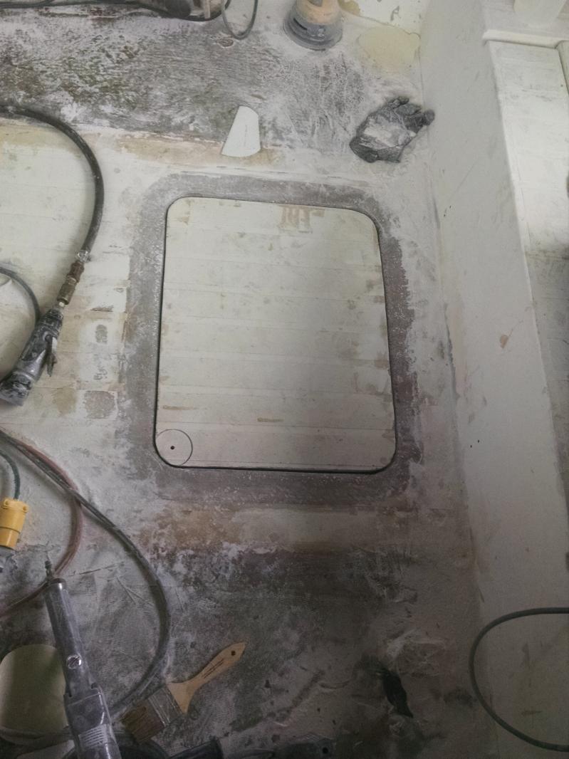

Bull nosed the edge of the hatch cut out and now layed alayer of 1708 and a layer of mat. Ground out the core of the hatch cut put and backfilled with thickened resin,made from cabosil and ground fiberglass.

yikes! major sanding for this hatch,but nice gutters !

Yea it is a bear.. I took me about 2 hours sanding and fitting the hatch.. It not as pretty as ya'lls but I'm going with teak sole.... Thanks...

Still working on hatch .. I rough sanded and it now fits. Still need to fair it out then final sand it to receive primer...
