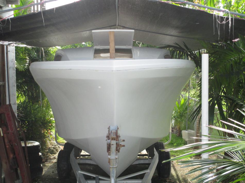

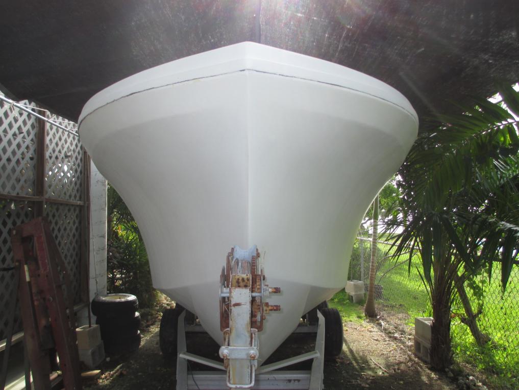

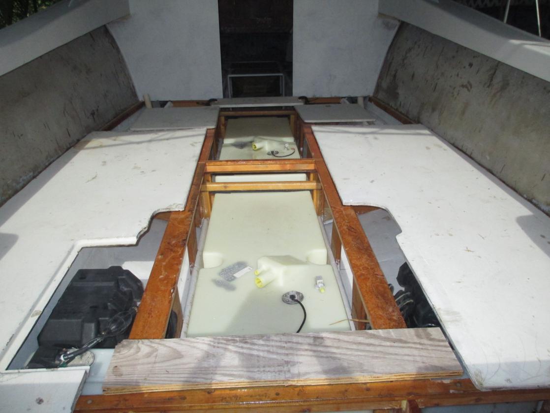

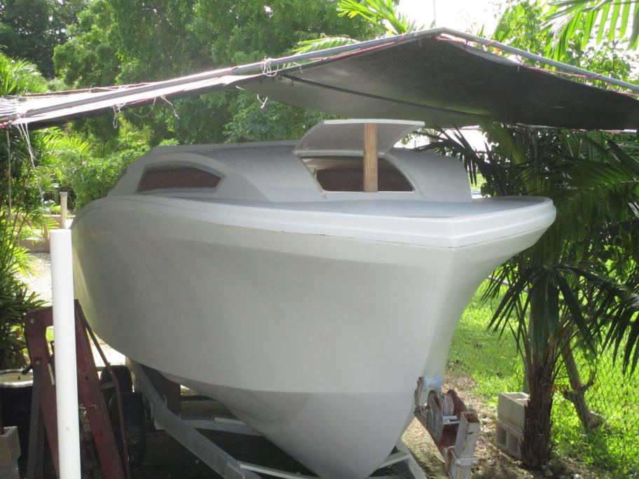

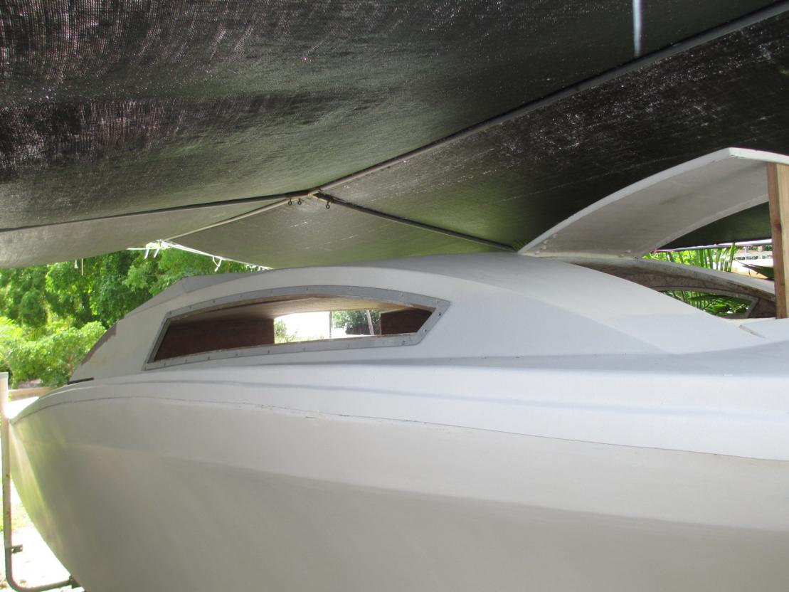

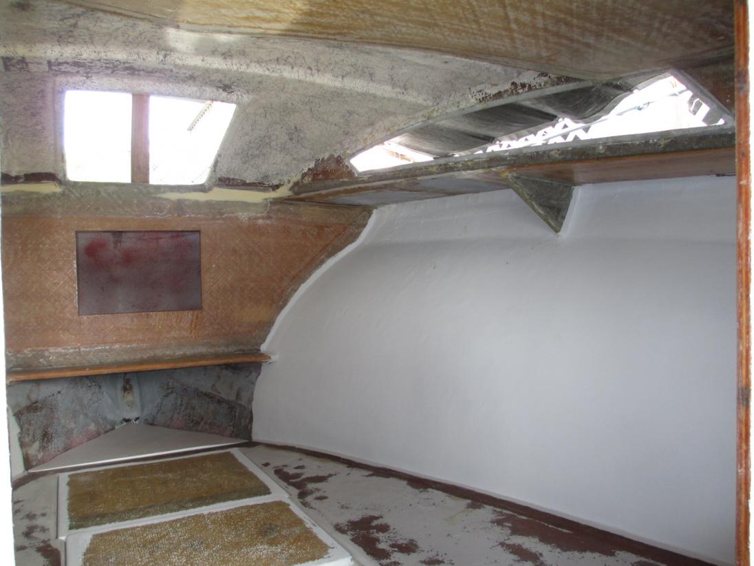

Default 21' Seafari Photos
There are many good people on this site and ideas are welcomed.
Here are some photos ... the boat is squeezed between property line fence & house, so getting distance shots is not possible.
Progress has been slow and design concepts are in the making at each step of the way.
  #37
Old 11-20-2015, 11:38 AM
Join Date: Mar 2006
Location: Florida Keys
Posts: 617
We have raised the transom a couple inches, planning on twin Etecs ... 25" shaft. Dip in transom at center will accommodate a 30" shaft for single engine. We prefer twins for shallower draft & also stabilization.
Aft cockpit flooring has also been raised a couple inches. Temp scraps down for walking. Hope to replace with the real thing soon.
Need good helm design and also would like seating to accommodate 4 people.
Maybe boxes under pedestal seats for ice box, fish box or storage, water tank, sink, etc.
That's where we are ...
And here's a photo of where we started ... when we first got her.
