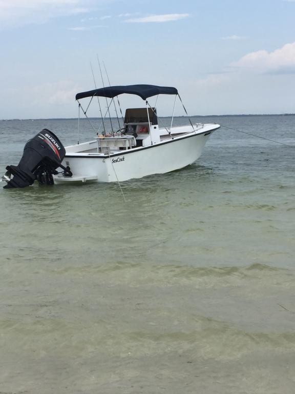

Heres mine with a 250 Yamaha then the Suzuki 250

BBH, I think my extra flotation on my bracket will help. I'm guessing
an inch only because when I stood on my bracket it went down by one and I'm
way under 260.
I'll let you know in 2 weeks.
I'm taking my boat to Sarasota Line-X this week to have my bracket sandblasted and
coated with 650 Line X.
Capt. Brian

I'm floating 1" higher and now I completely self bail.
