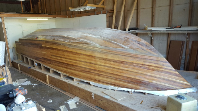

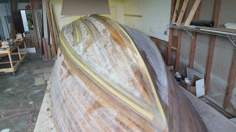

adding chine/bottom tabbing before I run more glass on the bottom. *With all the overlaps, the chine will have a minimum of 4 layer of biax cloth. *Have a few fishing trips lined up next week, and the weather is perfect for glass work, so Im pushing to get as much of the bottom glassed this week as possible. *

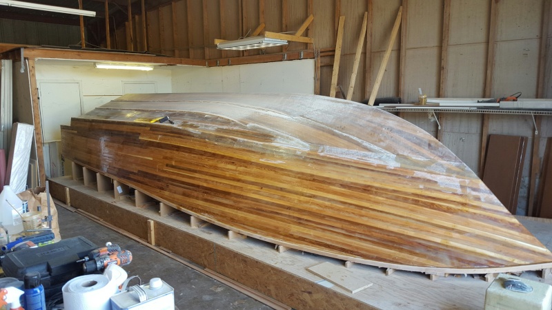

Port hullside got one layer of glass today. *First picture is after rolling on epoxy on the wood, second if after one layer of 12 oz biax. *

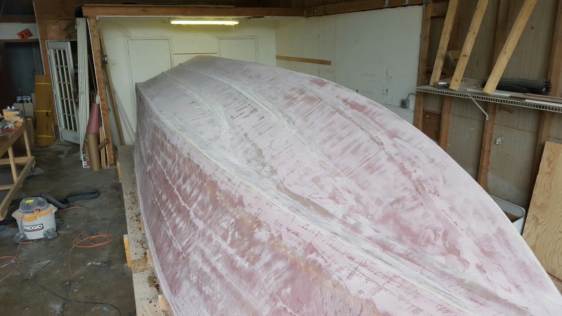

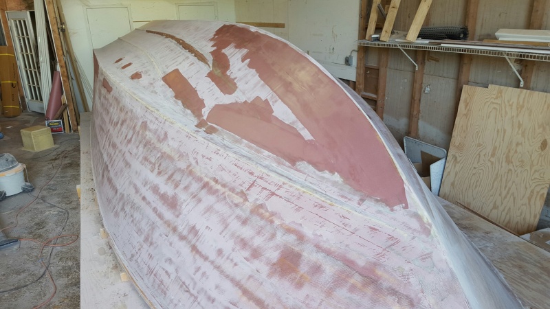

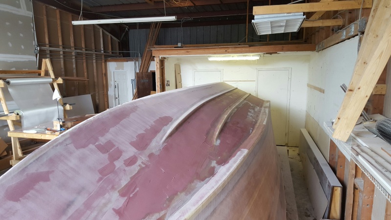

have not updated this one in a little while, Im into the most fun part of all right now.... Fairing !
[img]http://i86.servimg.com/u/f86/19/19/83/70/20160312.jpg[/img
