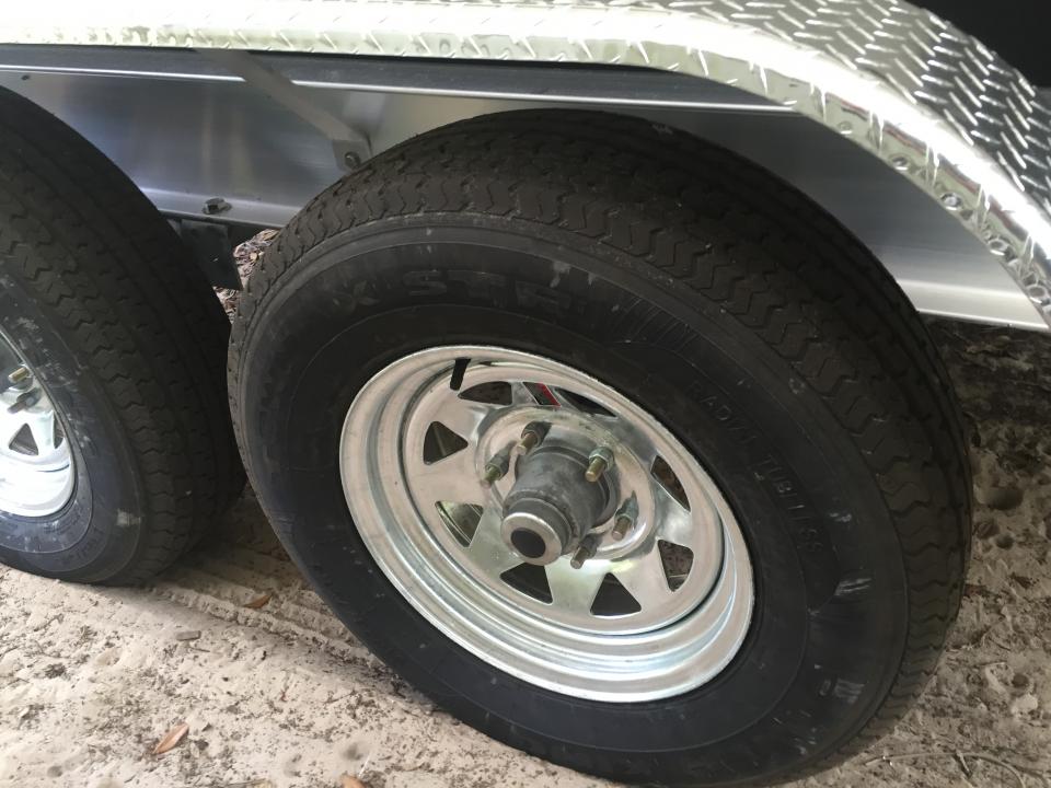

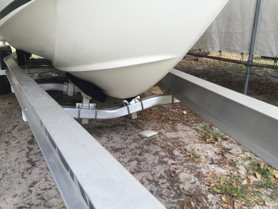

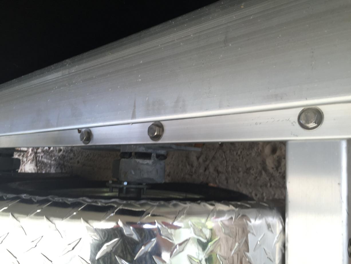

Here are some pics of the new trailer. I ordered the trailer to fit a 26'-28' boat as to accommodate for the new project when it is finished. The trailer is 31' overall but the Tsunami fits it just fine and the added length helps not having to back in so far. I did upgrade to all stainless bolts, HD winch and 5500 lbs 6 lug axles. The torsion arms are massive and should be more forgiving as I bent one my Continental though they were a third the size. The only parts on the trailer that are not aluminum are the axles, winch stand and tongue beam. Everything else including cross supports, guides and bunk brackets are hd aluminum. The I beams are hd 8" as well. LED lighting was standard with a real aluminum tag bracket. And yes, no brakes at this time. Researching the best option if any as I have yet to find a set worth the duty cycle I have experienced in the past.

6 lug 15 wheels

Giant torsion arms

Centering bunks with aluminum and stainless brackets
