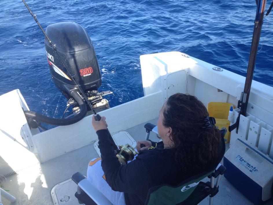

I had one and now it looks like this. You need a bracket to offset the motor enough to give you the clearance to tilt your engine. The room you will gain is priceless.
That there is the best boat scrubbin', samitch' makin', bean bag tossin' "Autopilot" I ever been to sea with! Once in a while Kenny even let's her fish.

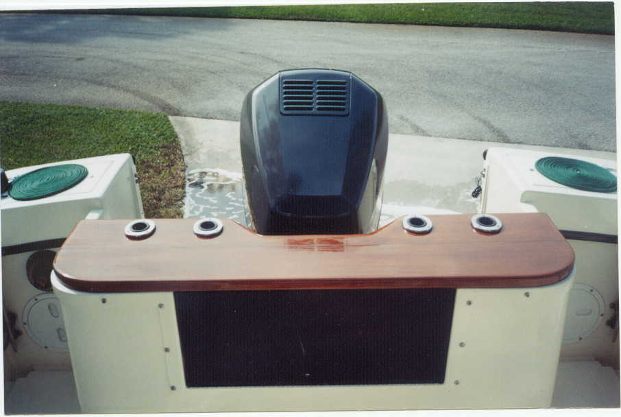

If your not in the mood to enclose your transom at this time, I would take on Don's advice. Also make sure you move the steering , fuel and harness cables up a few inches and seal them with boots from water intruion coming over the transom.
I made this rocket launcher with a notch that could handle the engine tilt. Lot of good ideas to be found on this site ,just utilize the search function
