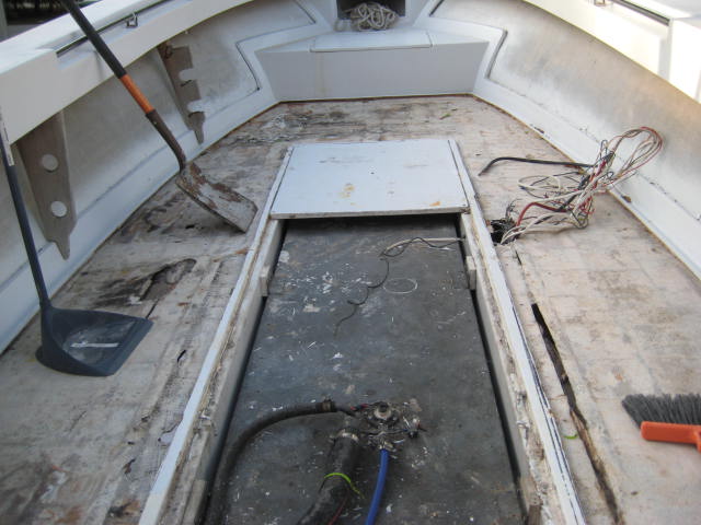

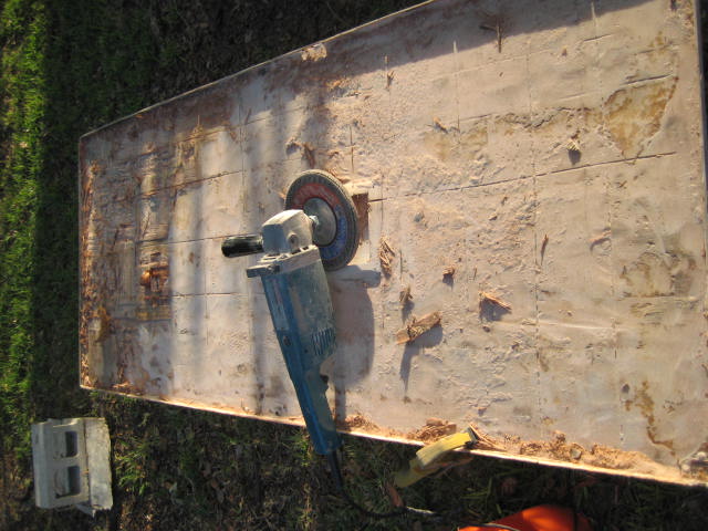

Took out the hatches that cover the gas tank and flipped it over and took a saw set it to 1/2 inch cut a checker board pattern in it and took out the matting and the nasty wet wood underneath. I bet it must have weighed at least 80 to 100 lbs with all the wet wood down there. Finished with the grinder to the underneath skin on the floor ...what a PIA tomorrow will get the hatches done...

I have not posted in a while and the project sat for way too long.
I went and bought 1/2 nida core to replace the wood in the floor and enough glass and resin to hopefully finish the floor.
My original plan was to try and use the skins that I took off the deck but I see that is was not going to happen so I laid several layers of glass to build it up to where it was.

Well I worked about an hour each day for the last 4 days since it is getting hot down here.
I have about 85% of the floor done and all that I need is to pickup the fairing supplies to finish. More fun sanding LOL

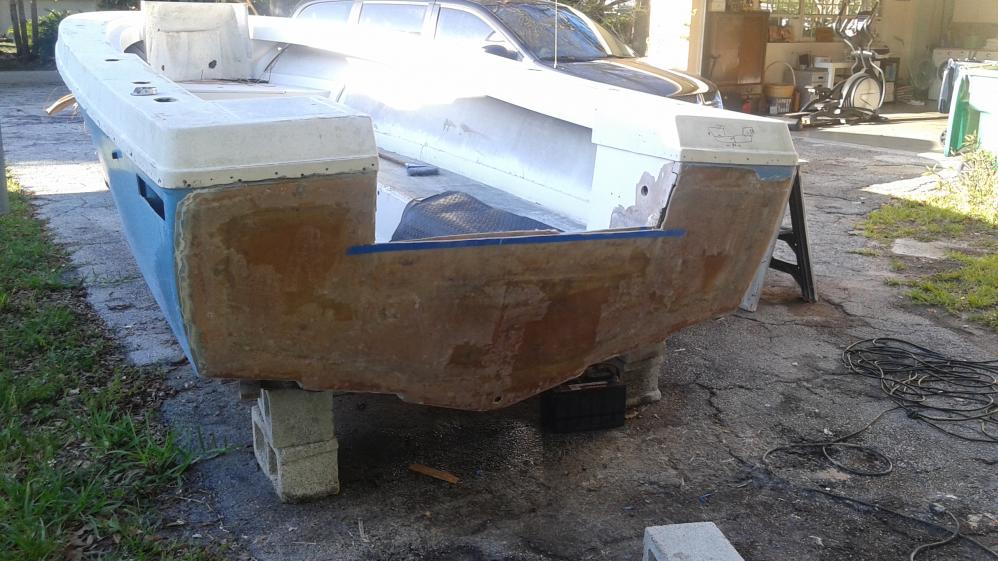

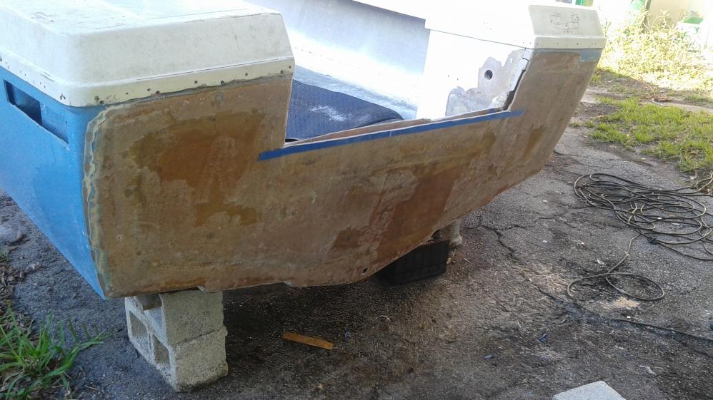

I started measuring how high up I need to extend the transom and following some advise here I'm going up to 26 1/2. Going to use some of the skins that went un-used off the floor and glass them into the transom and have it ready to pour the transom sometime next week end.
Boy am I having fun with grinders, sanders, glass and resin

Old 05-07-2016, 06:57 PM
Some work done today.....more work yet to come
