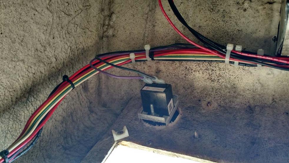

Making some more progress on the wiring. I learned a lot during this rewire and I think the next time I have to do one of these it will come out much cleaner.
I still have some cleanup and labeling to do. It's kind of hard to get good images inside of the console with so little room (steering lines are blocking the picture), but this is where I left off:
