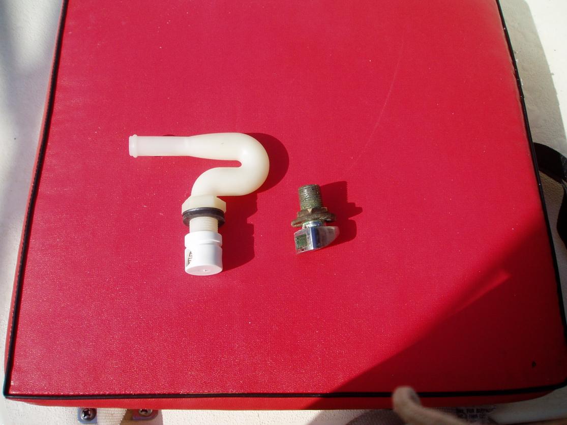

I'll check the vent hose arrangement and fuel cap Oring. What is that "special inverted U fitting on the vent hose?

The plastic inverted U vent fitting is shown in pic below on the left next to the the original fitting, which would allow water into the vent line. Don't remember who made it but it had a clever plastic "catch bottle" that clipped to the outside of the fitting that would catch any fuel that spit out the vent during refueling! The plastic fitting eventually broke however, so I replaced it with a similar round fitting with a 90 degree elbow in it. I installed it with the elbow pointing aft and used a longer vent hose with a 360 degree loop in it up in the Seafari's raised coaming several inches above the vent fitting. Seems to do a good job of keeping water out of the tank, and I can still use the catch bottle!
