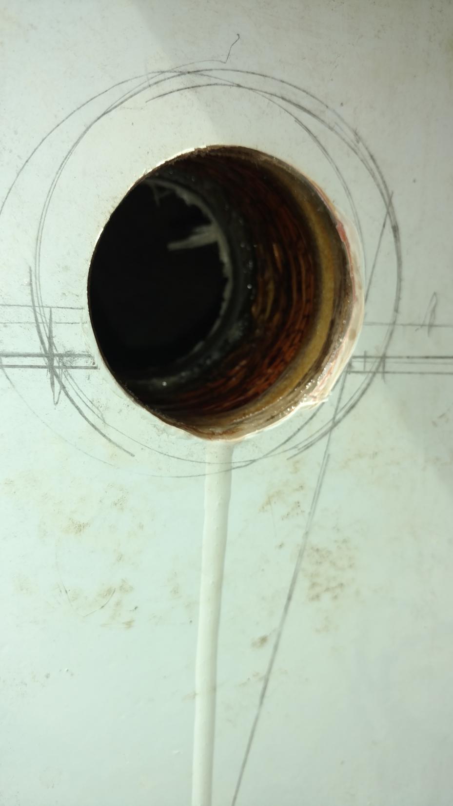

Well after some measuring and finding the correct hole saw bit I decided to drill some through hull scuppers drains for the deck.. in between the never ending fairing..

1. Pic I measured and drilled the hole
2. Rabitt the hole out and then put a wet coat of epoxy on..

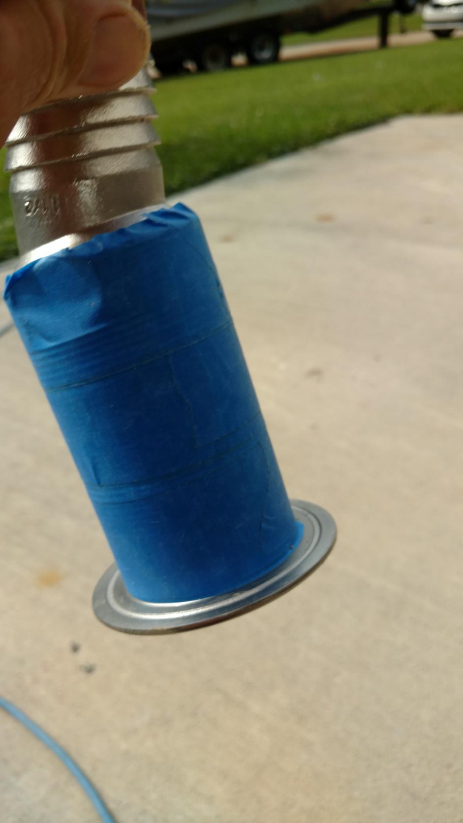

3. Then back buttered the rest of the epoxy with cabosil thicken epoxy
4. I taped the thu hull up and waxed the snot out of her.
5. Installed it about 2/3 in let set up
6. Then pull out very carefully...
7. Inside the deck liner I modified the floor drains to mount vertically measured in from side 12" and drilled a hole . I am amazed at the thickness of glass on that liner.. about 1/2" thick
