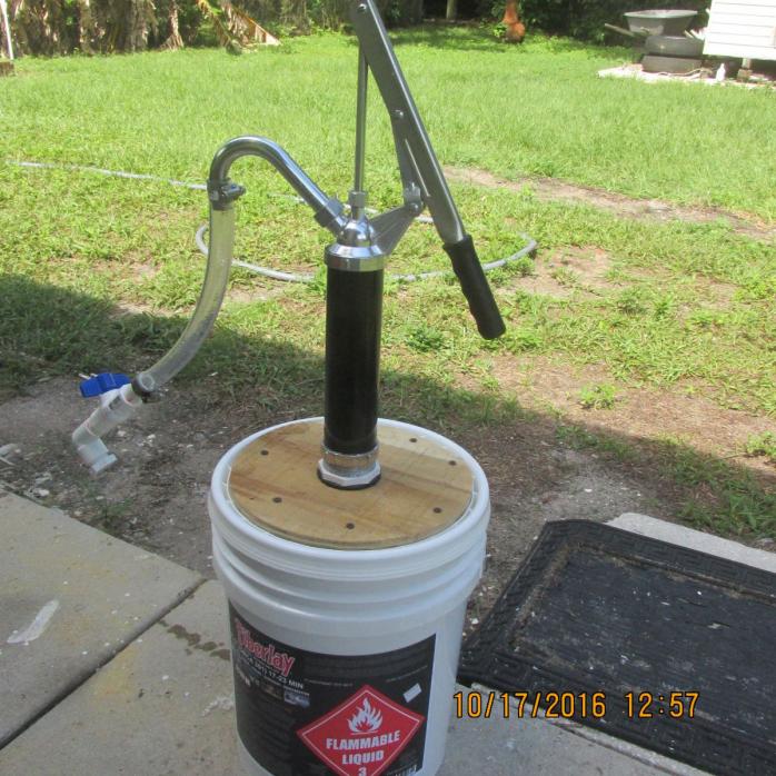

Default Pump
Last detail complete next week end will start to skin coat the boards. I wanted a way to dispence the resin and not spend a lot of time cleaning up.
  #45
Old 10-18-2016, 11:31 AM
That Resin Dispenser deserves the "Gucci Stamp" Award
Spidercrab would be proud of you .........

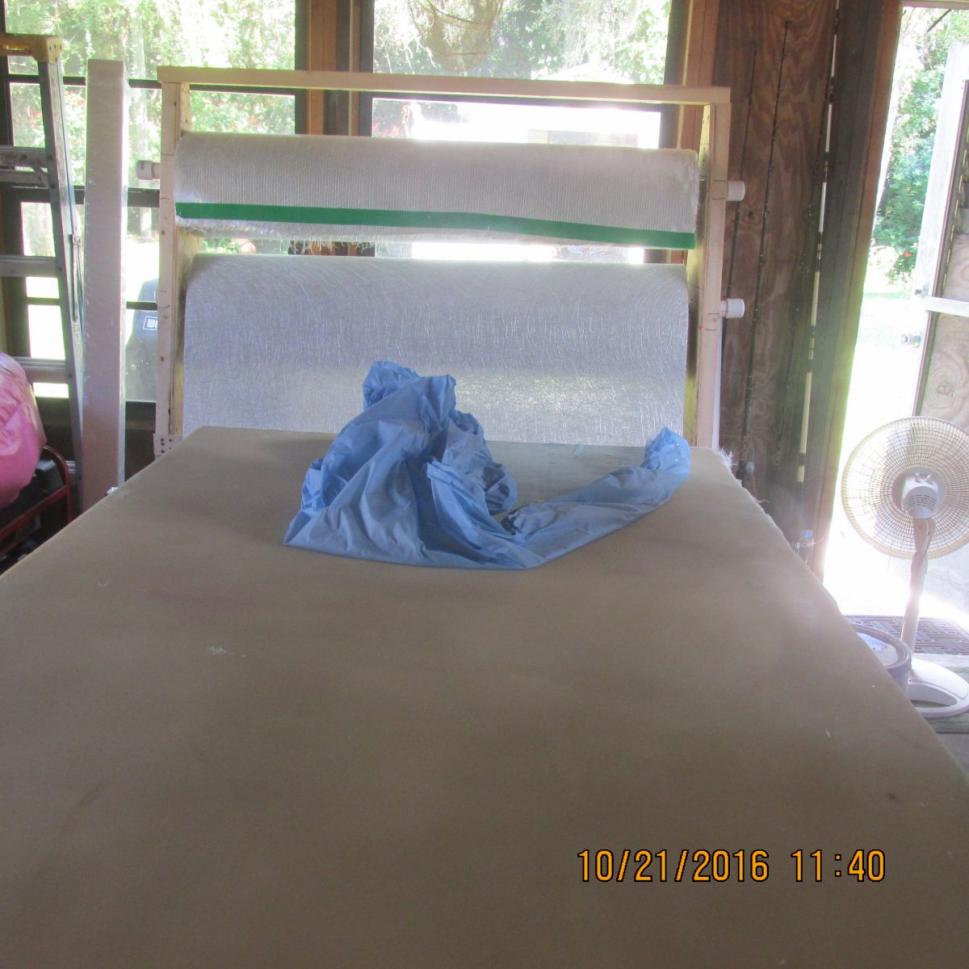

Only got one of the boards skin coated on one side. This is a two inch foam board intended to raise the stringers. I used peel ply and a six inch roller to force out excess resin.
Question is there a better way to remove excess resin other than vacuum bagging?

Tried a nida board with and w/out peel ply and I believe the results are the same. Went with a 6" roller to move the resin around then to a 4" spreader to remove excess resin then back to the 6" roller to lay it out smooth.
This is all new to me, the biggest board I've done in the past was 28X60". Already getting more confidence as I go.

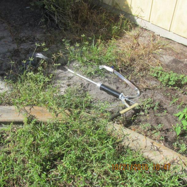

The resin pump was a flop, seems the resin and pump seals do not play well together. It froze up.
  #49
Old 10-23-2016, 09:53 AM
Location: Shelter Island, NY
Posts: 242
Well that's a bummer! Being sensitized to epoxy I had high hopes. It was a nice try though
