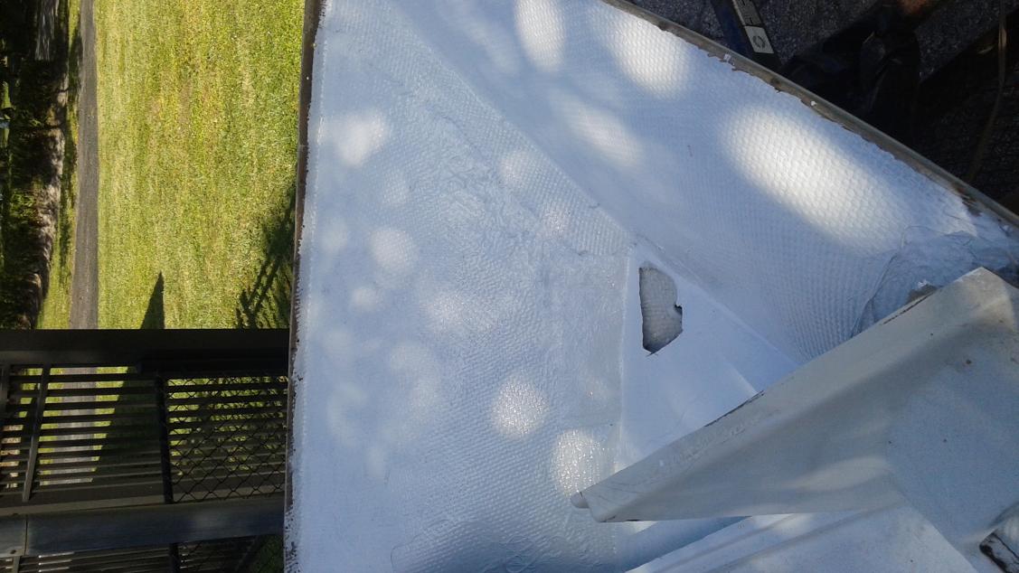

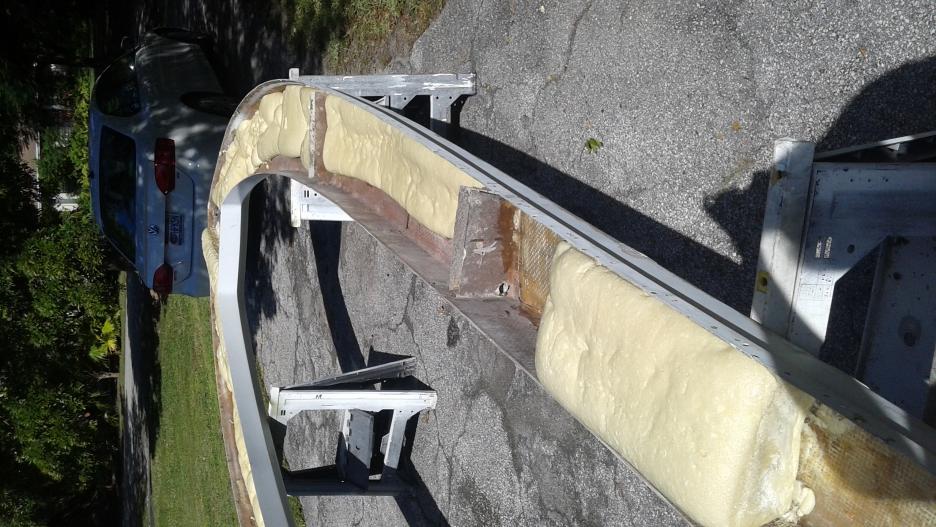

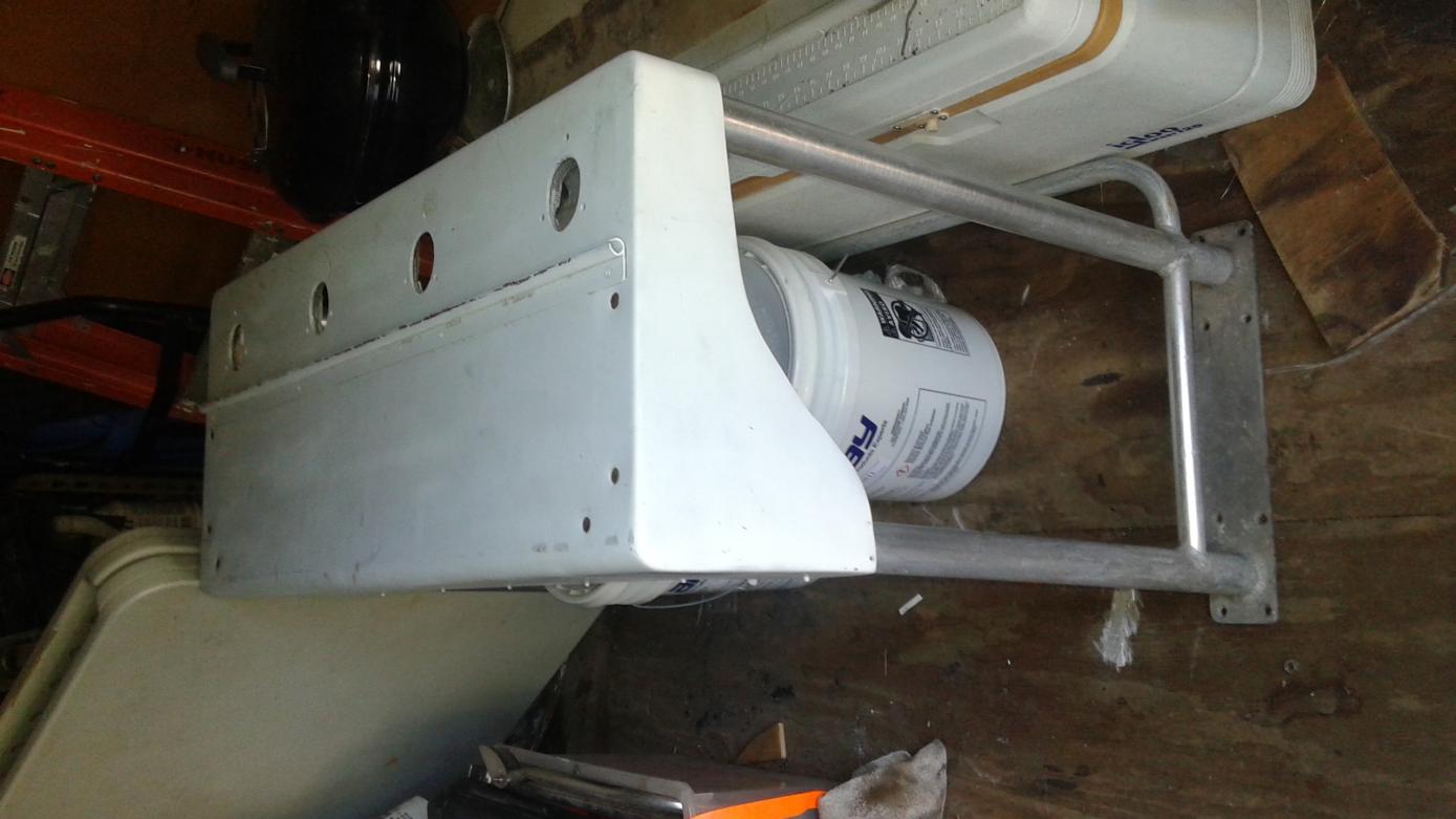

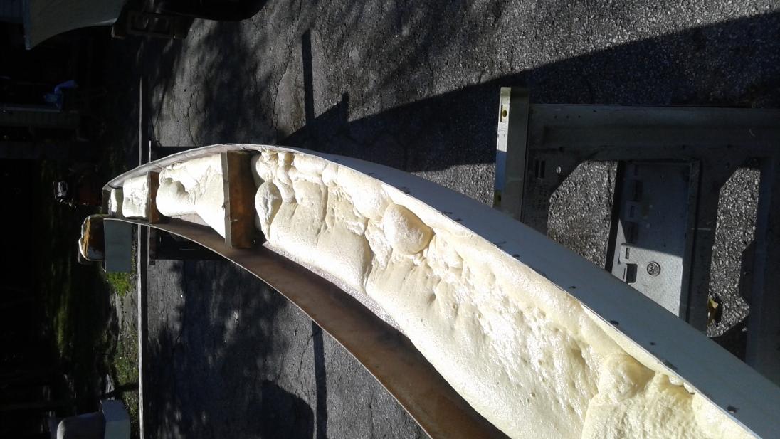

Well some progress today. Poured flotation foam. Some spots I went over but a little trimming and it's done. I did not put foam where the rod holders and other things will go so I don't have to dig out the foam while upside down. Painted the anchor locker and bilge since it easy to get to now. Picked up 2 buckets of Arjay pour transom bu am short one more bucket....Monday... Was able to pick up a free leaning post....just needs the rod holders and cushions. But it was free.

Poured the transom today. Was a little short so I need to pick up another 5 gallon pail. Easy to use poured easily and except for a overlooked screw hole all went well
