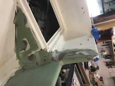

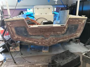

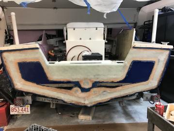

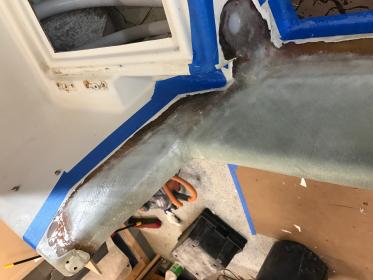

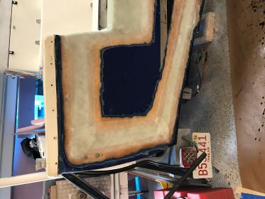

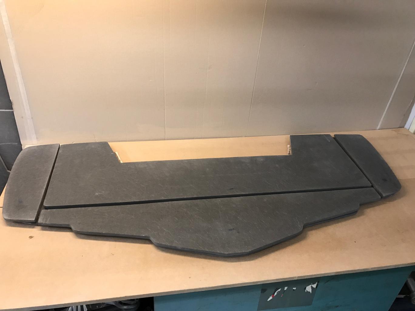

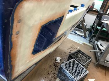

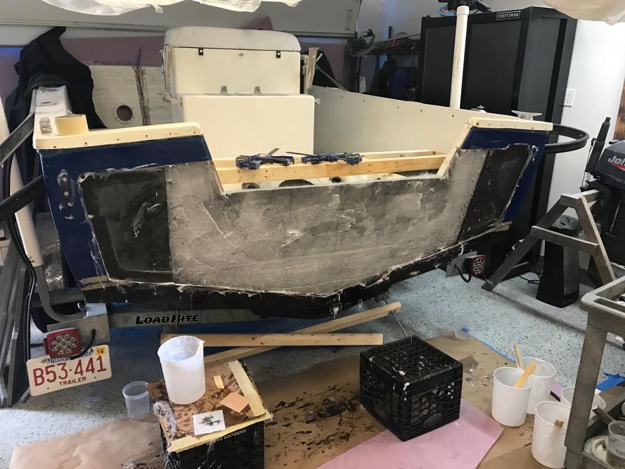

I got to work the past couple of days and put a good dent in the project.
Got the new coosa core laminated in and the old skin back in place.
Also started scarfing in my joints.
A few questions:

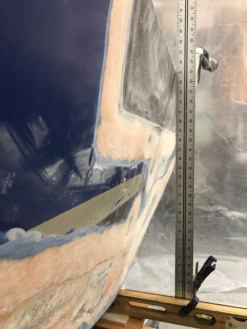

What should the exact height of the new transom be? Factoring in the thickness of the fiberglass of course, what should my finished height be? Should it be measured from the keel along the angle of the transom to the top? Or measured from the keel perpendicular straight up to the top? Right now the new core is at about 25" when measured perpendicular and 26" when measured at the angle of the transom.
When scarfing in the new glass into the splashwell, Should I stick with about 3" of glass around the entire permineter and try to scarf into all the grooves and curves where it meets the hatches? Or just stick with the straight parts of the Splashwell and fill in the edges with thickened resin?
How perfect should I try to grind down my 12/1 scarf? Right now it looks pretty good, but obviously not a perfect even bevel. When applying new glass over scarfs, should I start with biggest pieces first, as recommended by West System, or start with smaller pieces and build up to the largest, as I have read elsewhere?
A lot of work, which I expected, but comping along nice.
See pics for progress:

Your work looks great.
I have replaced 2 transoms from the outside like yours, and I filled the scrafs starting with small strips (2") and progress to larger (3" to 4" to 6"). 14 years on my 20SF using vinylester resin, and 7 years on 23WA using epoxy resin, no issues on either boat after hundreds of hours of use. The West Marine approach does not seem as strong to me.

The largest first and then smaller is more for corners and laying up over filets. In your case I would start with the small and work out to larger.
A lot of boats are around the 24-25" range but on a seacraft I like to go back to 26-26.5" on the height so that the motor is not jacked up so high off the transom to get the av plate out of the water. It will keep more water out as well.

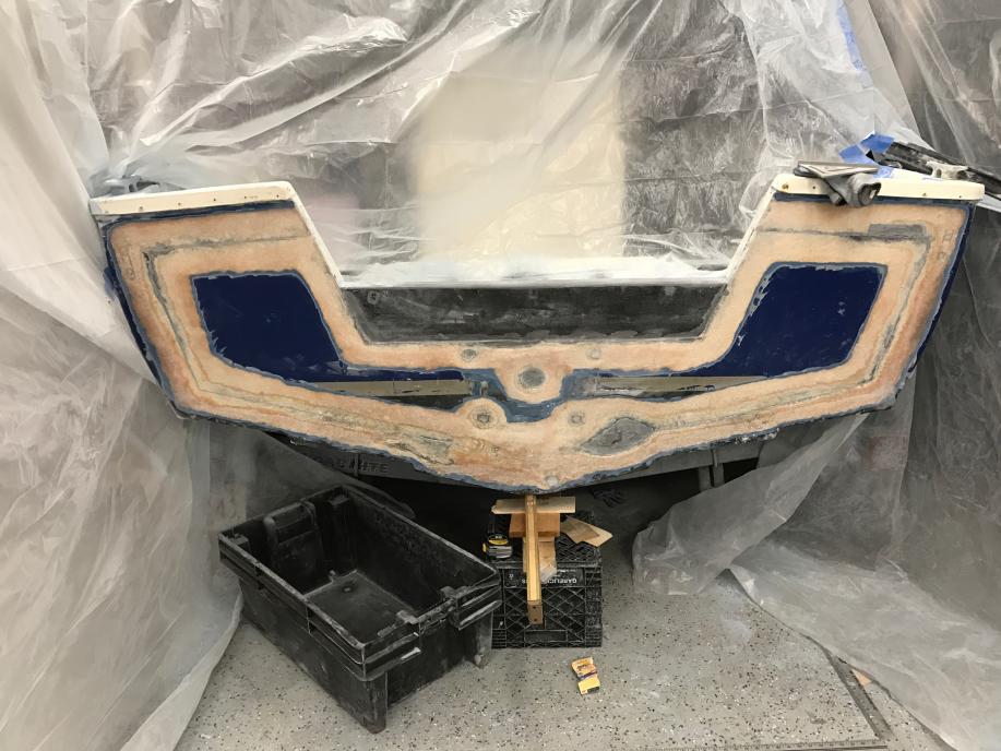

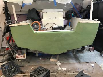

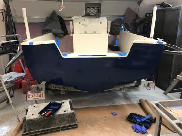

So, I completed this project a few months after I started the thread, and decided to upload the rest of the pics at add the the library of transom replacements on this website.
I know viewing others pics really helped me complete this project, so I figured I’d give back!
Old 05-19-2018, 09:11 AM
UrbanAngler UrbanAngler is offline
Join Date: Nov 2011
Posts: 7

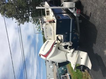

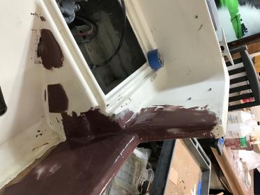

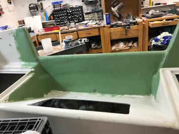

Here’s the rest of em
After one season, I had absolutely no issues with the repair
Decided to hang a brand new etec 150 of the back and the boat absolutely flies!

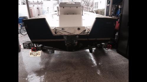

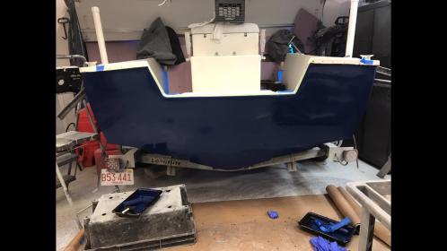

Last couple pics are before and after
