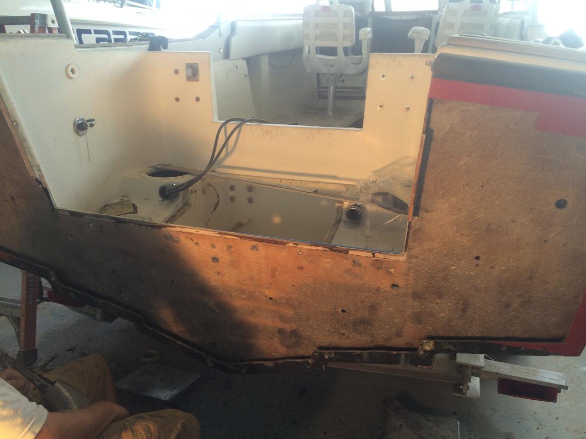

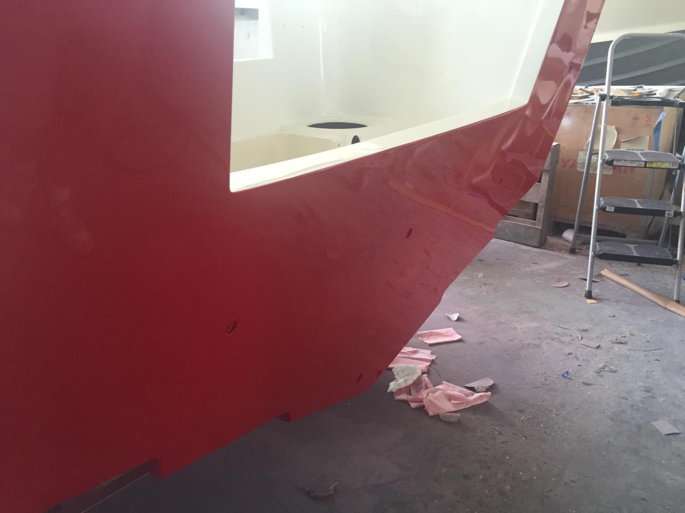

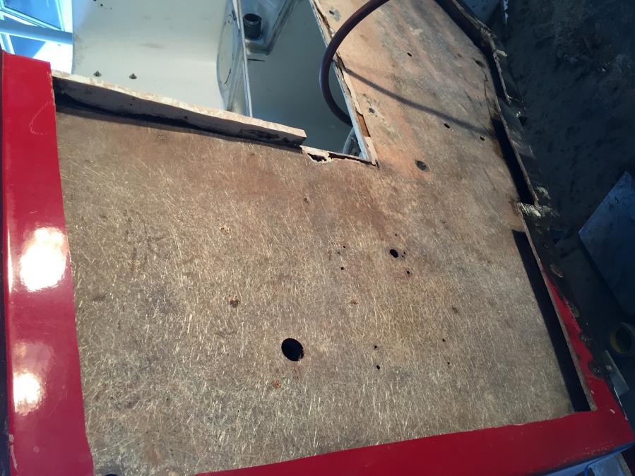

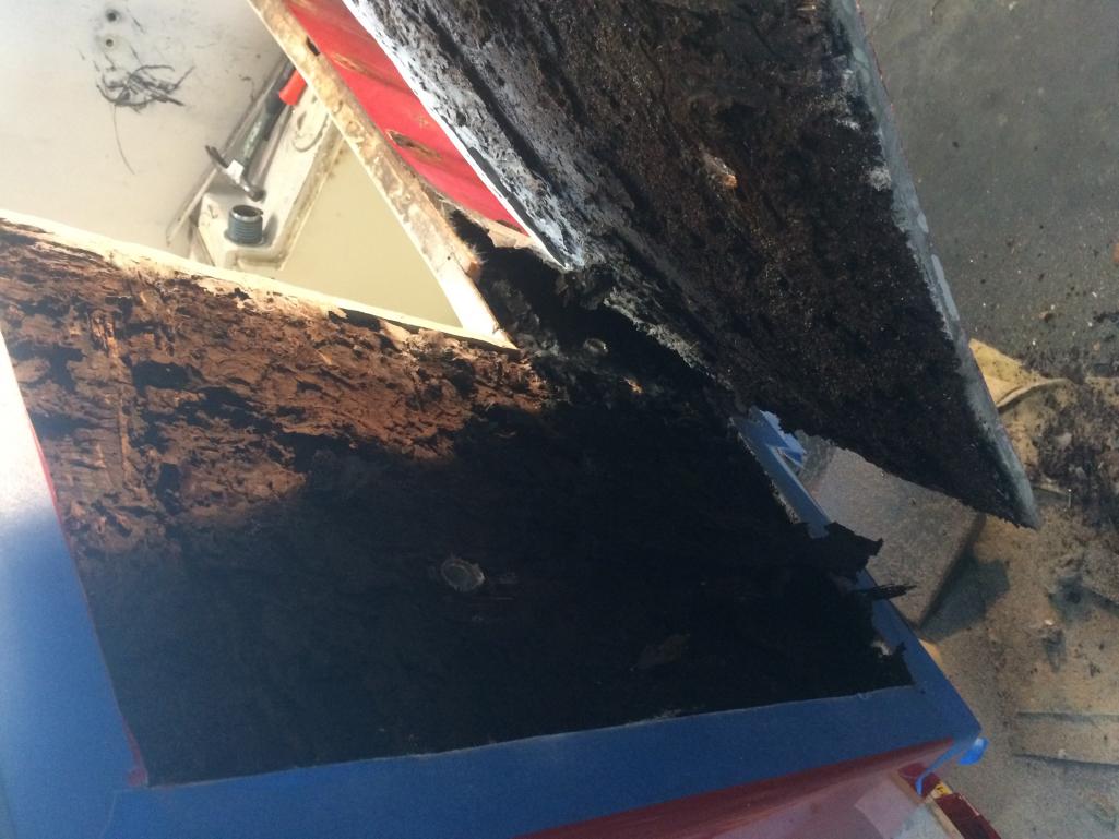

Posts: 214
I had mine done from the outside. I used Coosa too. Came out great! Raised it up to 30" while I was at it from recommendations from the wise ones on this site. Here are a couple pics
