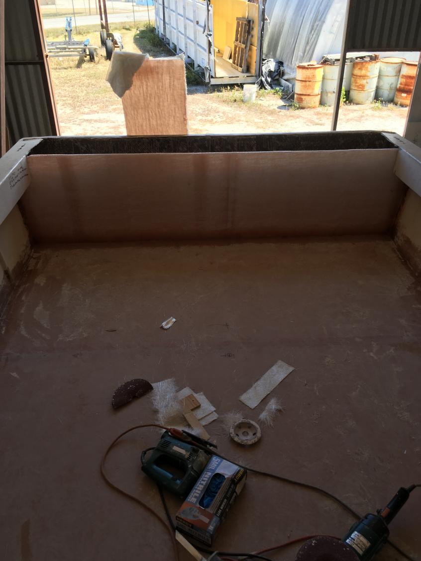

Here are some more update pics... Lots of little mods to do but the major cap replacement is done. The foot longer cabin and front deck is really noticeable and I believe the arch on the bow is slightly more rounded. She should be very unique when its done.
The dash looks huge without the glovebox, dash pod and folding top. There will be a lip all the way around the face edge to divert any water that gets in to the side corners and will also keep things put on the dash from sliding off.
