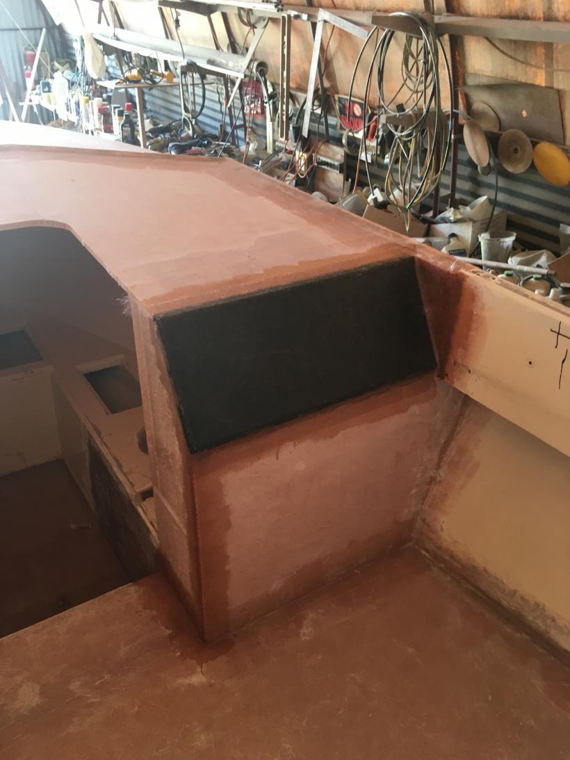

I couldn't get full pics from bow to stern due to the close quarters in the shop. Here are a few of the new dash, glassing progress of the cap and hull and the transom interior taking shape.

Thank you! Those pictures look great. The dash is looking good!

The picture of the drivers side dash makes it look like the "black" piece is an add on. Like a piece of starboard to cover old previous holes etc.. It's not. It's actually a piece of Coosa glassed in to the Nidacore. Will provide a stronger base for the tilt helm.
