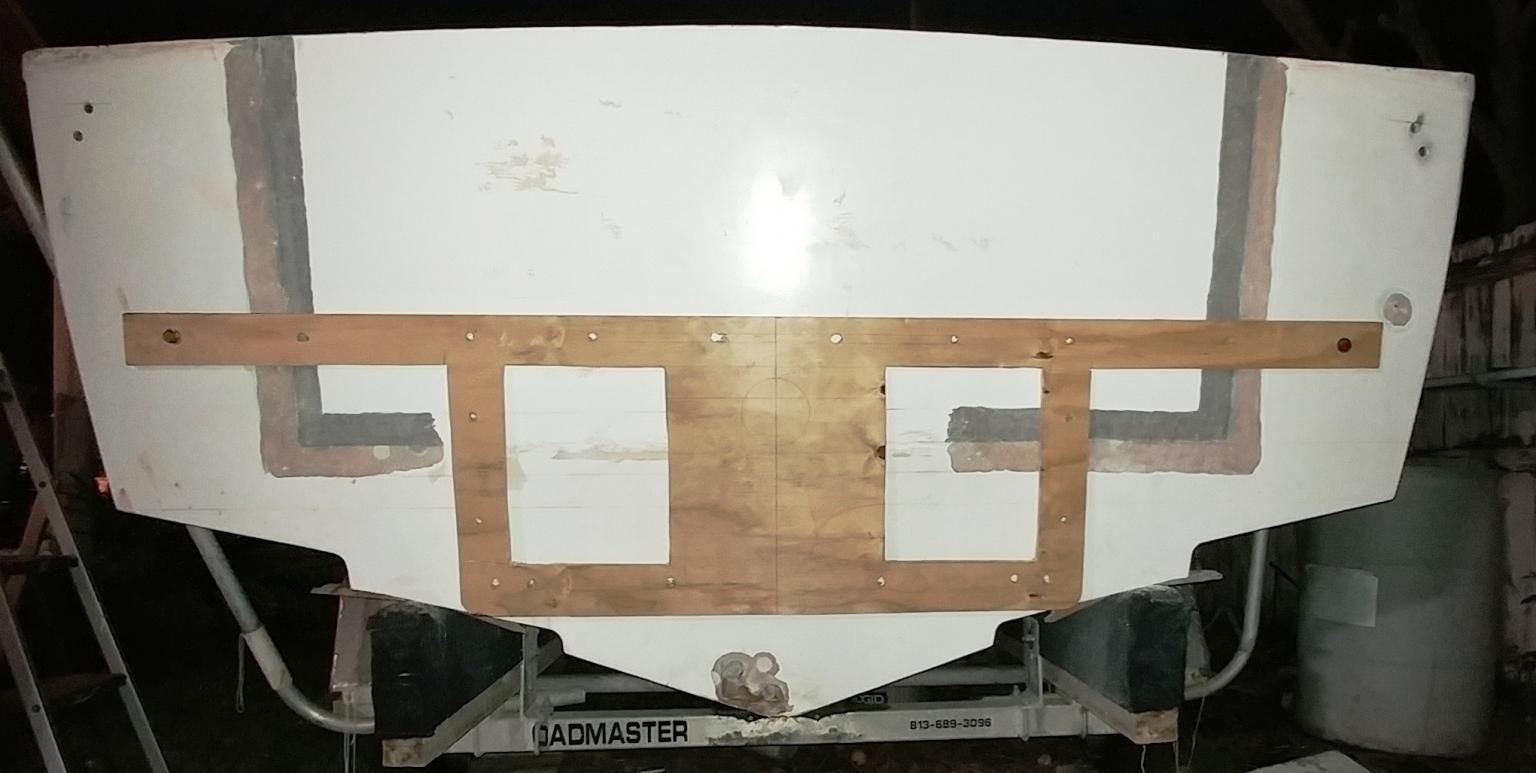

I have a 23 CC with a closed transom. AS OF NOW the TRANSOM IS ONLY A SKIN. I have the composite foam ready to be installed and I want to use bracket holes for the bonding of the 4 x 8 foam, that way I don't have to close holes later on and use those.
The bracket is a dual engine stainless marine. I have gone to their website and they emailed me installation instructions which to some extent I understand, but following them to the teeth will set my BRACKET too high.
Any takes, recommendations, tips.
The set up with be a VERADO 30in shaft engine.
The current installation, puts the conners part of the bottom of the bracket close to the 2nd step of the hull, is there any issue with this? The previous set up was 2 x 225 hp fitch engines, not my set up ( previous owner ) I suspect the boat squatted quite a bite. The previous owner mentioned it rode like shit, which I find his set up to be at fault.
I was considering raising the bracket 1 1/4 in up from that set up, so I can get more elevation from that strake ( where the 2nd step begins )

You want to have adjustment of the cavitation plate between 2 to 5 inches above the keel of the boat. This will be very hard to calculate without having the exact measurements of the motor and bracket together and the mounting hole to cav plate measurements.
This is one of the hardest things to get right and easiest to screw up. My recommendation would be to finish the transom completely and them mount the bracket template and drill afterwards. I just recently did this with the help of some very experienced friends and it was still quite challenging. One of the things you have to make sure of is that your finished transom is flat. Seems a no brainer but it is essential as most assume that it is all good until you put a straight edge on it. Focus on getting that right on the transom build.
Another thing I learned was that even with the best measuring.... no surface of any part of a boat is symmetrical or square. This is especially true if you are doing home fiberglass structural work like transoms. Your hull once relieved of internal support will conform to your trailer which will likely be off. Lastly, before you drill your bracket you need to make sure it "looks" right. It sounds silly but for me our carefully measured center was 1/2" from looking square on the back of the boat. Our plumb line was also off canter slightly when the template was put up. What worked well was to get the bracket template to the right height ay visible center and then put a screw dead center. At that point we were able to rock the template to match the hull and then lock it down and drill.

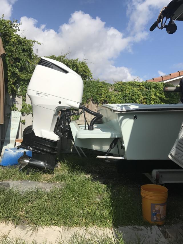

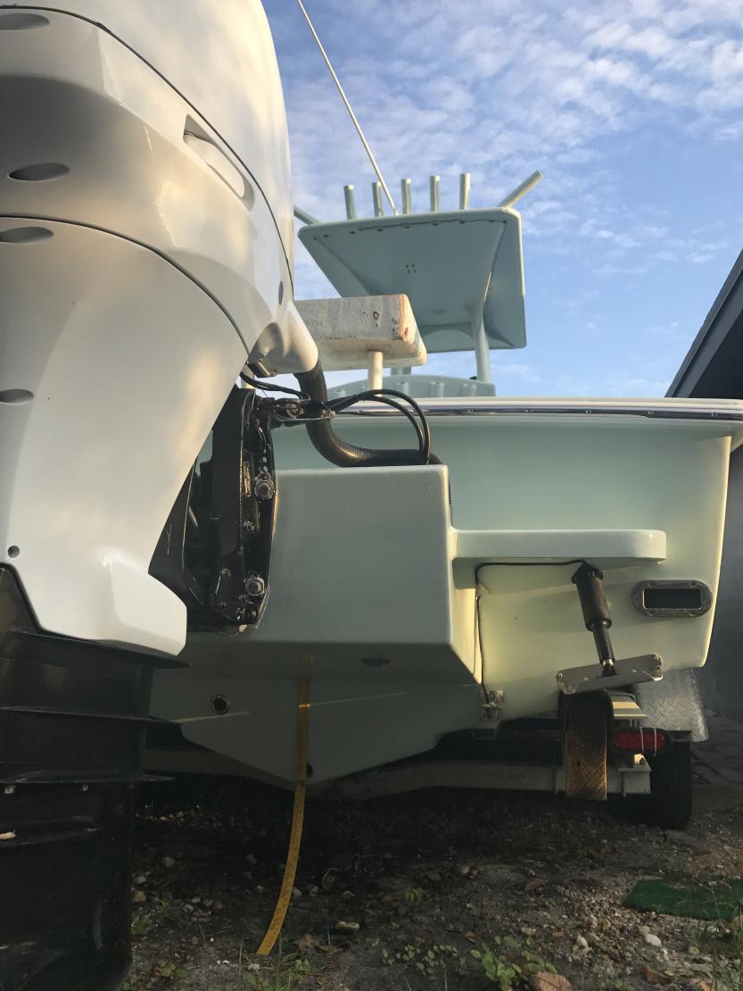

I have 23' center console with twin bracket and single 300 30" I'm almost 7-8" higher on my cav plate if that doesn't confuse u I would stay high as poss I got no wood in boat and moved console forward can't say how much but my boat is completely custom and reworked in every way good luck and stay high and dry keep that power head out of water

Hope this helps my bracket is 12" up from keel I would go 13" or a tad more
My bracket height where it hits boat is 15" but ur bracket may be different
I'm all the way up on my holes I even had to redrill higher ones
My thoughts on getting more floatation are the same as most on this sight but if u don't get the lower unit as high as possible when on plane it will never find topend ,highest efficiency and u will never figure out right prop also will feel like a tugboat hope that helps
