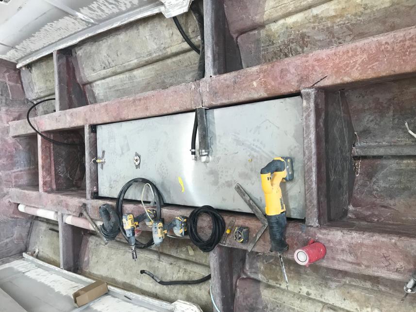

Default Fuel Tank and Rigging Tube
Went with 87 gallon fuel tank. Plan is to run a Evinrude G2 250HO. Should have plenty of range with out all the extra weight of fuel.

Default Fuel Tank and fish Box
Fishbox is 24 wide by 48 long and about 15 deep. Hope to fill it up soon!
